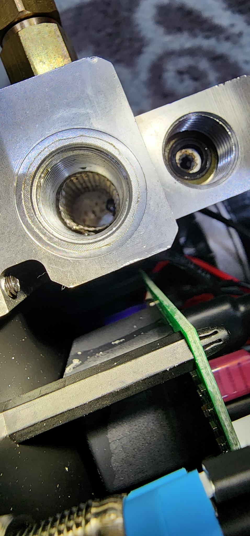

I haven't laid eyes on them personally, but if they are in the water trapping block where the HPA exits the machine, I'd throw out a WAG that they are water coalescing beads, not desiccant. Desiccant in that tiny little space, would expire in about 2-3 minutes of pumping. (Or maybe they DID put desiccant, but the function would still be coalescing, not water removal).
Just my guess though. Will have to peep them next time I open one of my CS4s.
F6Hawk may be correct... but they do change from white to blue in some that I've run.

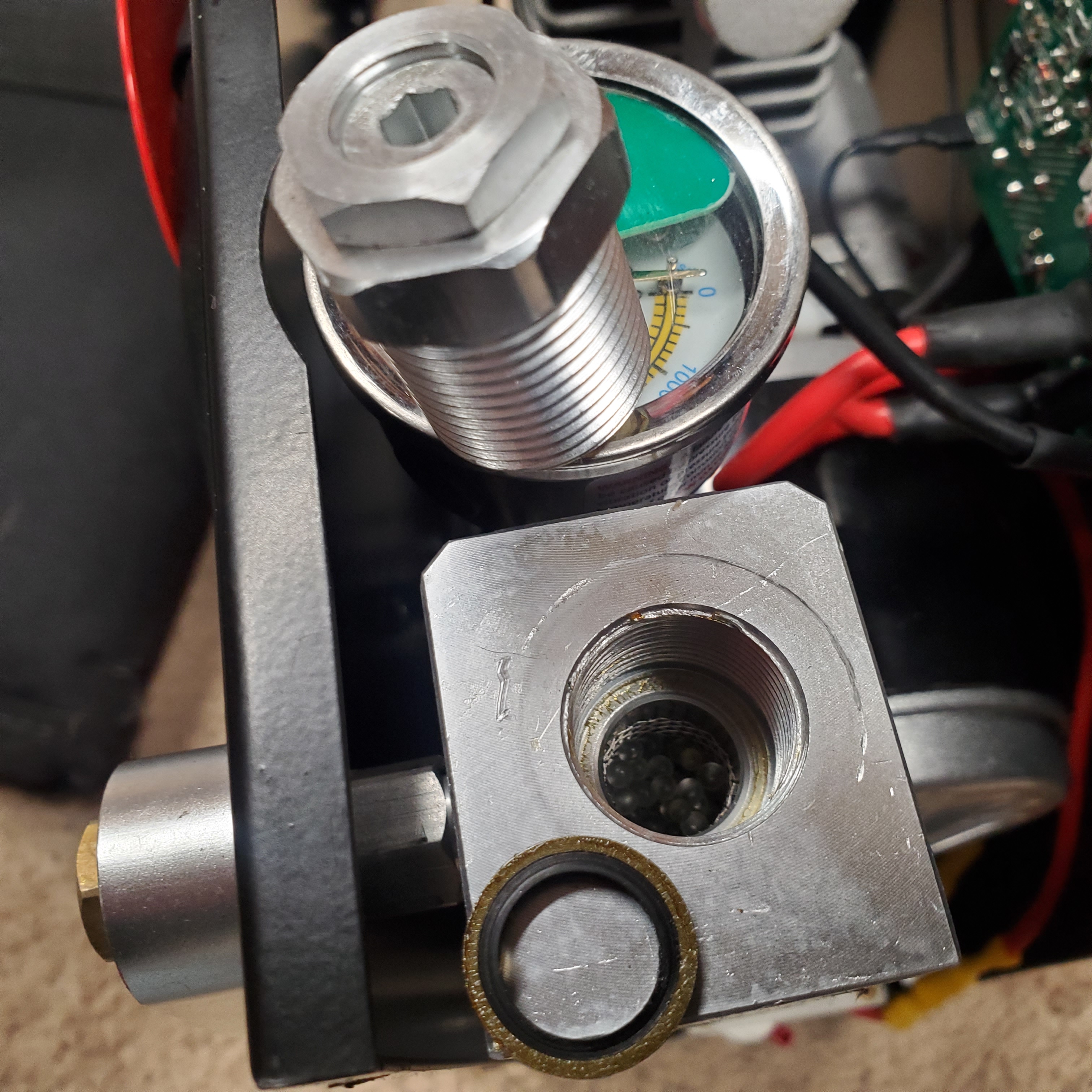

They are found under the safety valve in the cs3 and in the block that has the bleed valve in the cs4.

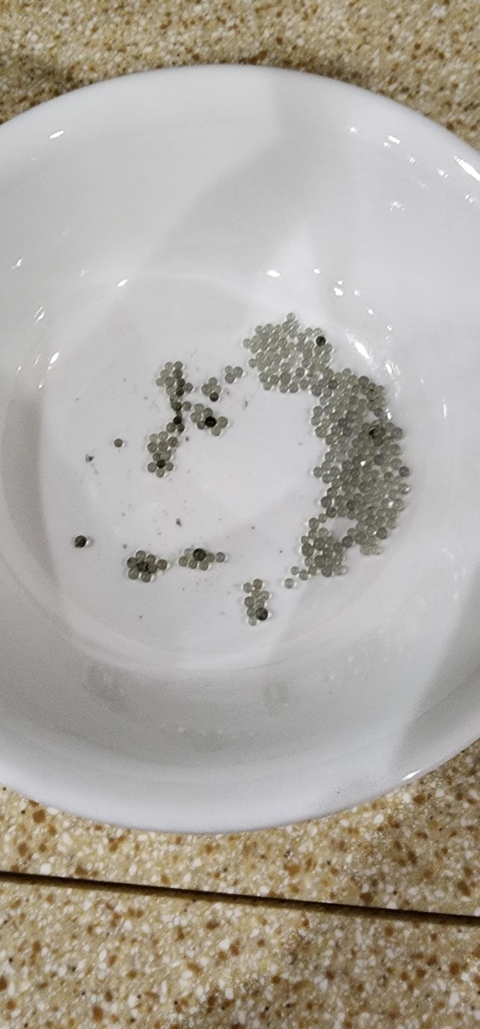

I'll soak the ones that are in there and find out for sure tonight which they are...
But my current guess is they are coalescent beads as they are not easy to access
You do that, and I'll put mine in the oven to dry and we can see what happens. If they change color, we'll know your original assessment was correct.

Very hard to tell if they are desiccant or silica beads. Like @1900colt, I will spray mine with water and see if they absorb water. Then run thru a cycle in the oven to dry.

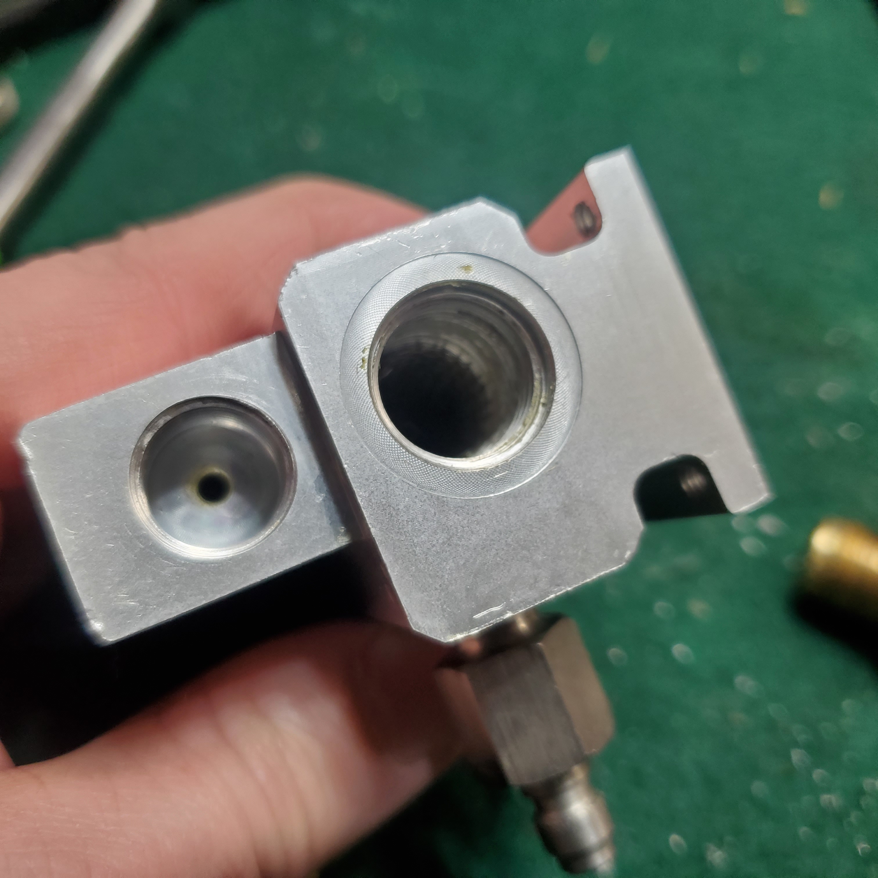

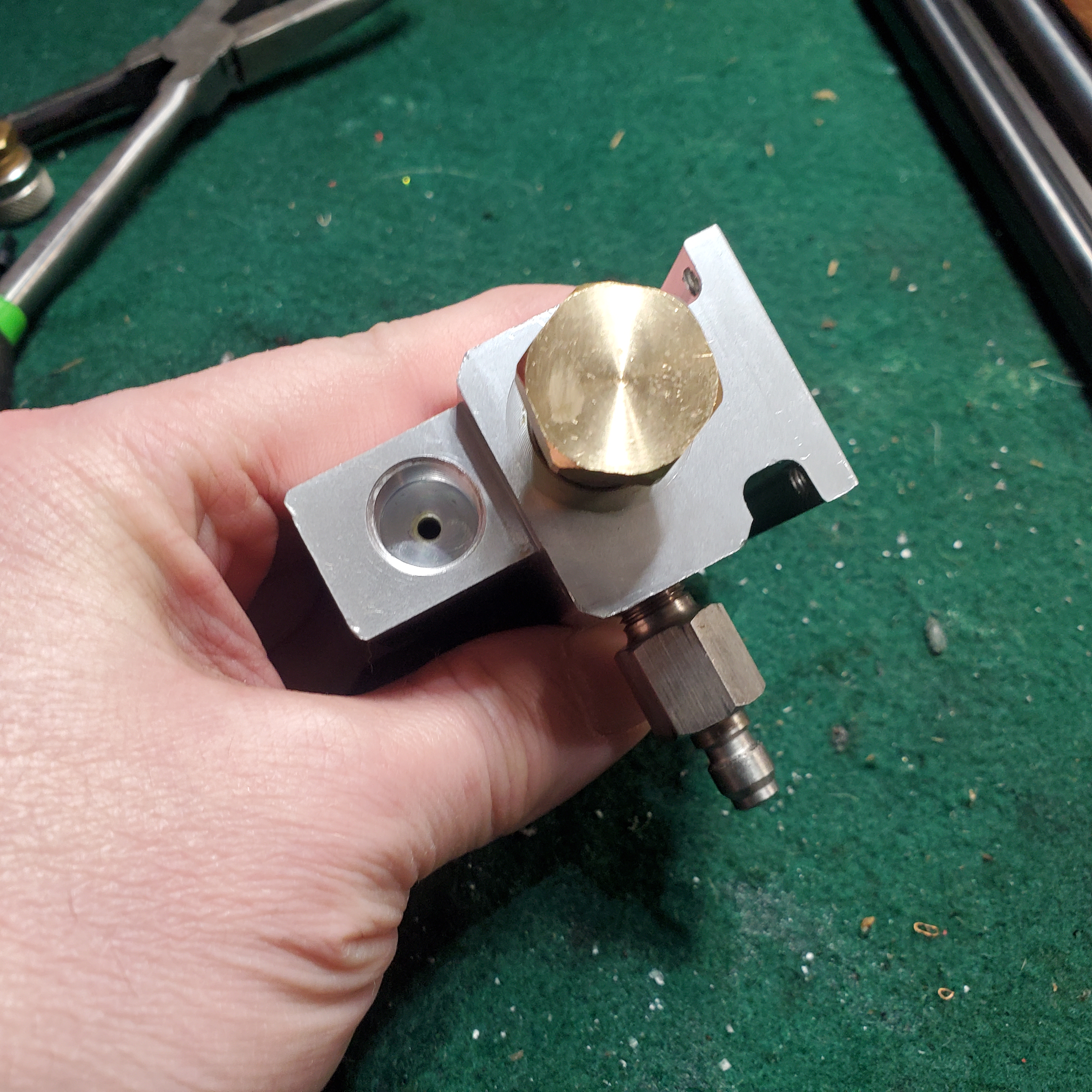

The WHERE is in the manifold that the air is pumped into from the compressor, and it houses the pressure gauge, a plug with beads inside (this is under the gauge), as well a outlets (side, front, or bleed).
It's just a working theory ATM, but @1900colt and I think they are simply using desiccant inside the manifold as a substrate upon which the water vapor can coalesce and be bled off more readily. The quantity is FAR too small to actually have use as a desiccant, but it seems to be very effective at trapping water. More to follow as (IF?) we learn more.

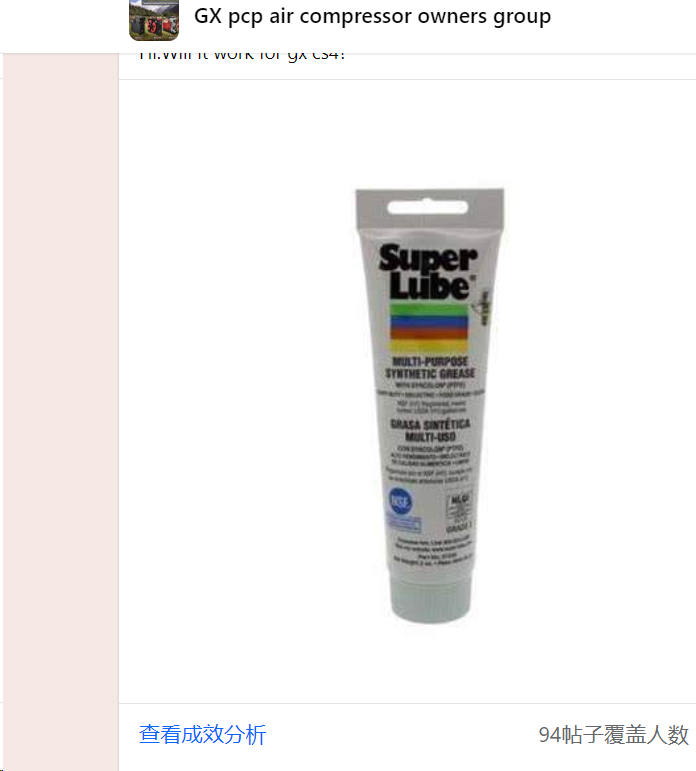

Technically, some of us DO know what they recommend, and have shared it across several posts. But they don't get very SPECIFIC, they say "this will work just fine", then show a pic of Super Lube. But... WHICH Super Lube? There are many.
After doing a binch of searching, and seeing all kinds of greases used by many, I have come to the conclusion that ANY NSF H1 grease will work, whether it be silicone (synthetic) or plant oil (bio) based. Anything except petroleum.
This is the pic sent to me by a GX rep (personally, I want to avoid any grease with PTFE in it, but that may just be me):
