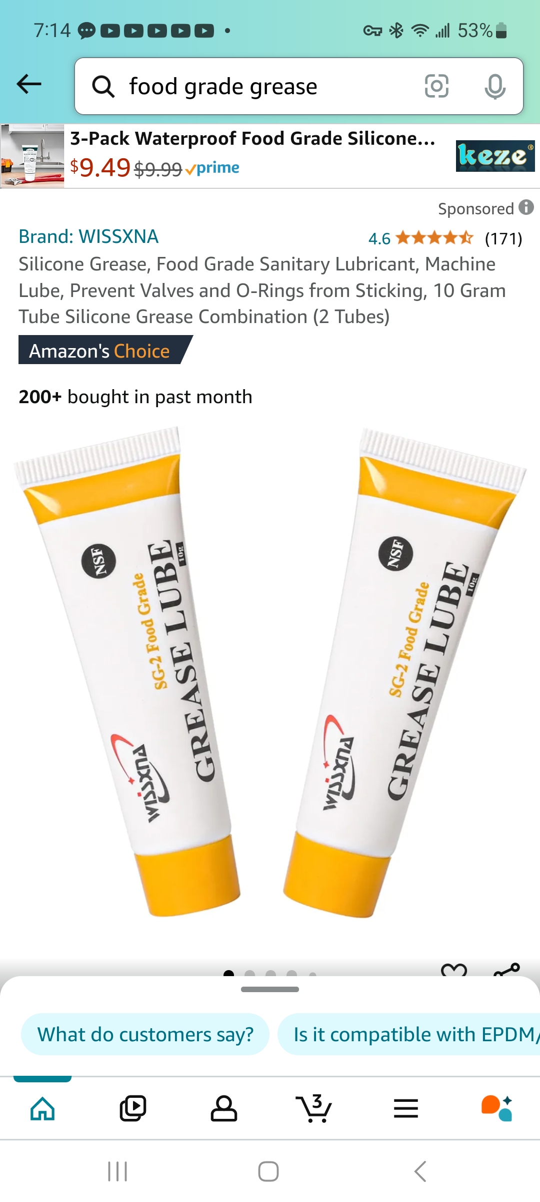

Would this work for the pressure side? Also, by chassis lube, do you mean bearing grease?
Bill over at Target Forge ( https://targetforge.net ) carries parts and lubricants specifically for the GX compressors. He also has a great YouTube channel with many videos detailing how to work on the various sizes and styles of GX compressors. ( https://www.youtube.com/@TargetForge/videos ) Do a quick search on his YouTube site and you should find the information needed. BTW - I have been running a GX CS-3 for just over 4 years with only general maintenance and a re-lube just last year.
