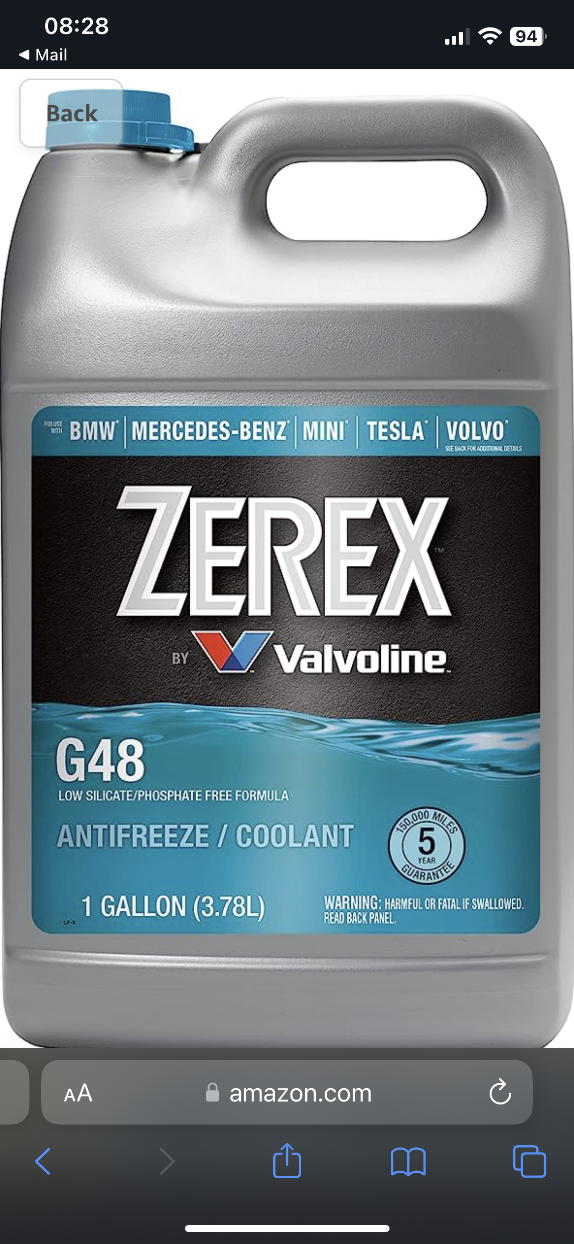

I am in the tropics, high temps and humidity, so I am not getting the published 5 hour runtime, closer to 45 mins.
Spoke to CS and they recommended a specific coolant to run. Coolant arriving on island in a few days.
Have a YH as well, but prefer the CS4 for the lack of external bucket and the fact that it is conversation quiet....I have to check on it sometimes to make sure it's still running while I'm in another room.
What coolant did they recommend? I know myself and several others on here are using distilled water with water wetter additive.
This is what they recommended.
I tried to buy water wetter but there was none available on amazon in sizes less than HUGE. hahahahaha. Will try again though.

1. Note: For the first use, it must be filled with 500ml of pure water or antifreeze before you turn on power. Otherwise, will cause damage ! !
Total 500ml. we suggest coolant and distilled water mixing with ration 7:3 ( 7 coolant). You can use this kind of coolant: https://www.amazon.com/Zerex-861583-Antifreeze-Coolant-fluid_ounces/dp/B079WZ9DDS/ref=sr_1_1?keywords=Zerex+G48&qid=1675316901&refinements=p_76%3A1249128011&rnid=1249126011&rps=1&s=automotive&sr=1-1
notice : when switch on the power, the water pump will work first. be sure to check if the water flows from the upside hole in the water tank into tank.if not flowing, pls contact with us and don't press " start" button to use.
