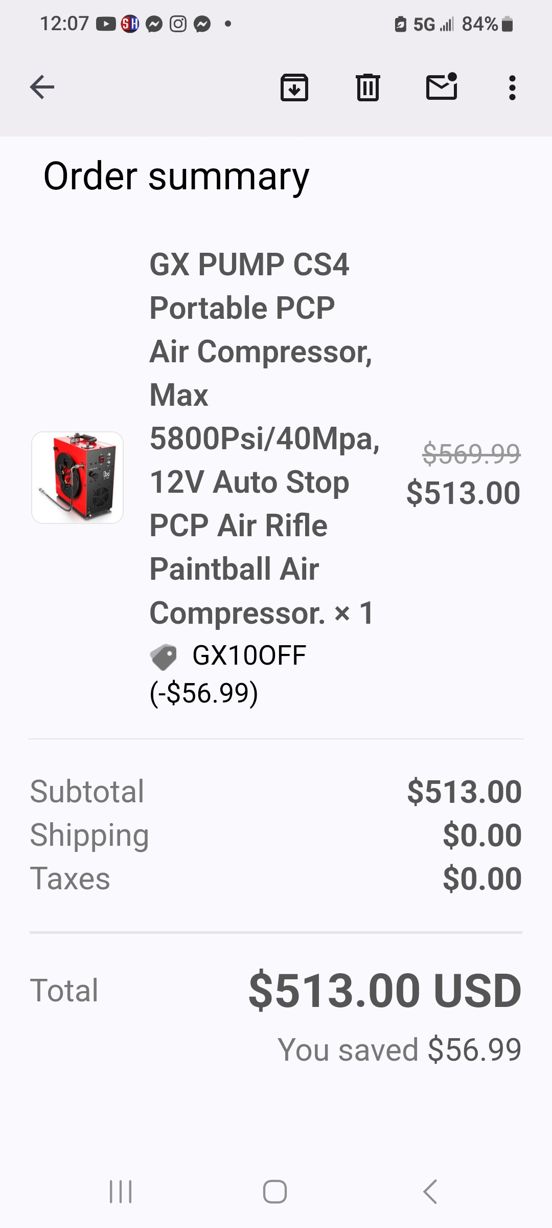

Well, going to see for myself. Made the decision!!!
