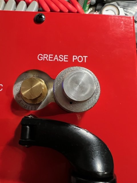

The CS4 has the check valve up on top. It's a matter of removing the complete brass 'Burst disc' fitting that's beside the grease pot.
Use the tube socket from the tool kit to undo the complete fitting. You can leave the smaller top fitting alone as the burst disc lives under there...you need to take off the complete fitting to find the check valve.
Remove these bits and clean them, plus clean down inside where they live (a Q tip is fine for that).
