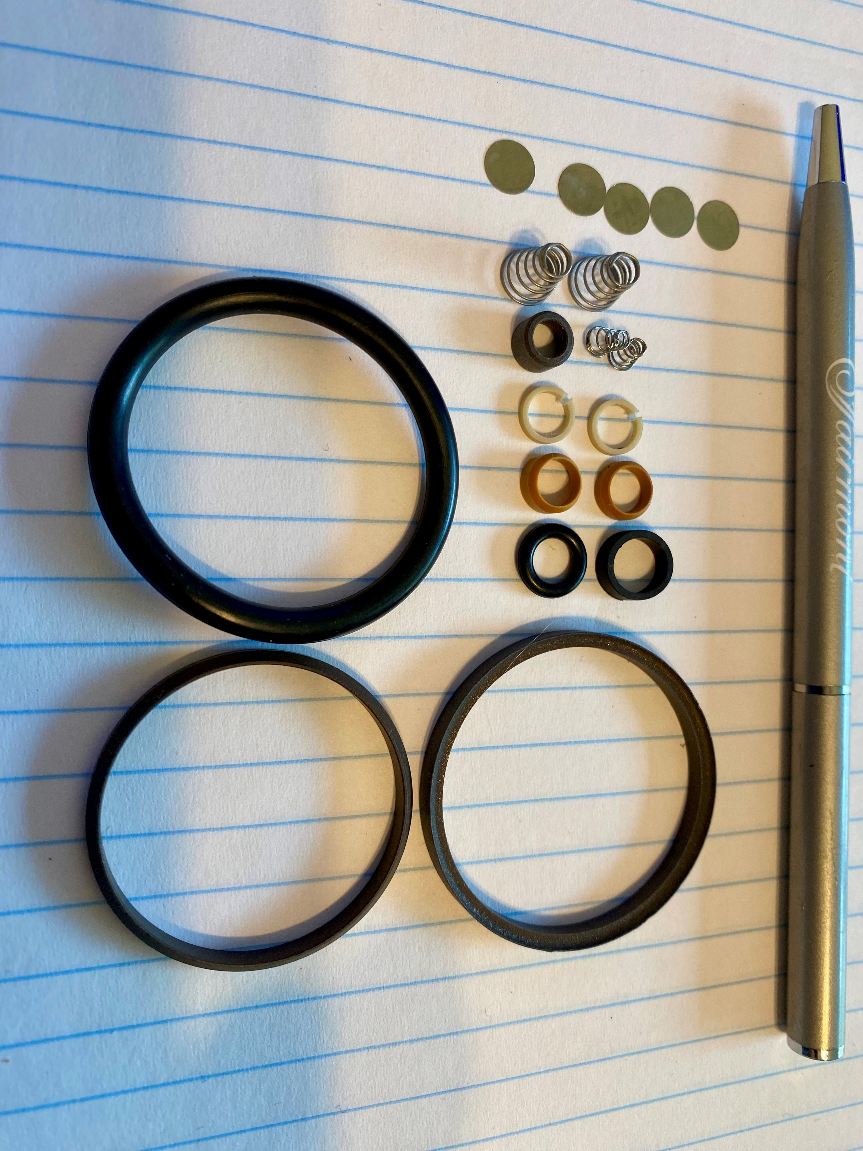

Any idea of how difficult these are to rebuild? Are there any diagrams in parts lists? Are parts available to be purchased? I presume all pumps matter if they're a $50 hand pump to a $5,000 diver pump eventually we'll need to be maintained and rebuilt.
Their online support is lacking and I have no idea about customer support. I assume you’d need to contact them for a rebuild kit. The purchase comes with one and manual With drawings. Instruction are limited but easy enough to figure things out. Here are a few pages.
Thanks. In the parts kit are this piston rings metal, o-rings or something else. Sealing rings = o-rings?

The piston rings (bottom of picture) are some type of composite and sealing rings are O-rings. The rest of the parts are plastic rubber and metal.
Black parts = Rubber
Orange parts = plastic
White parts = plastic

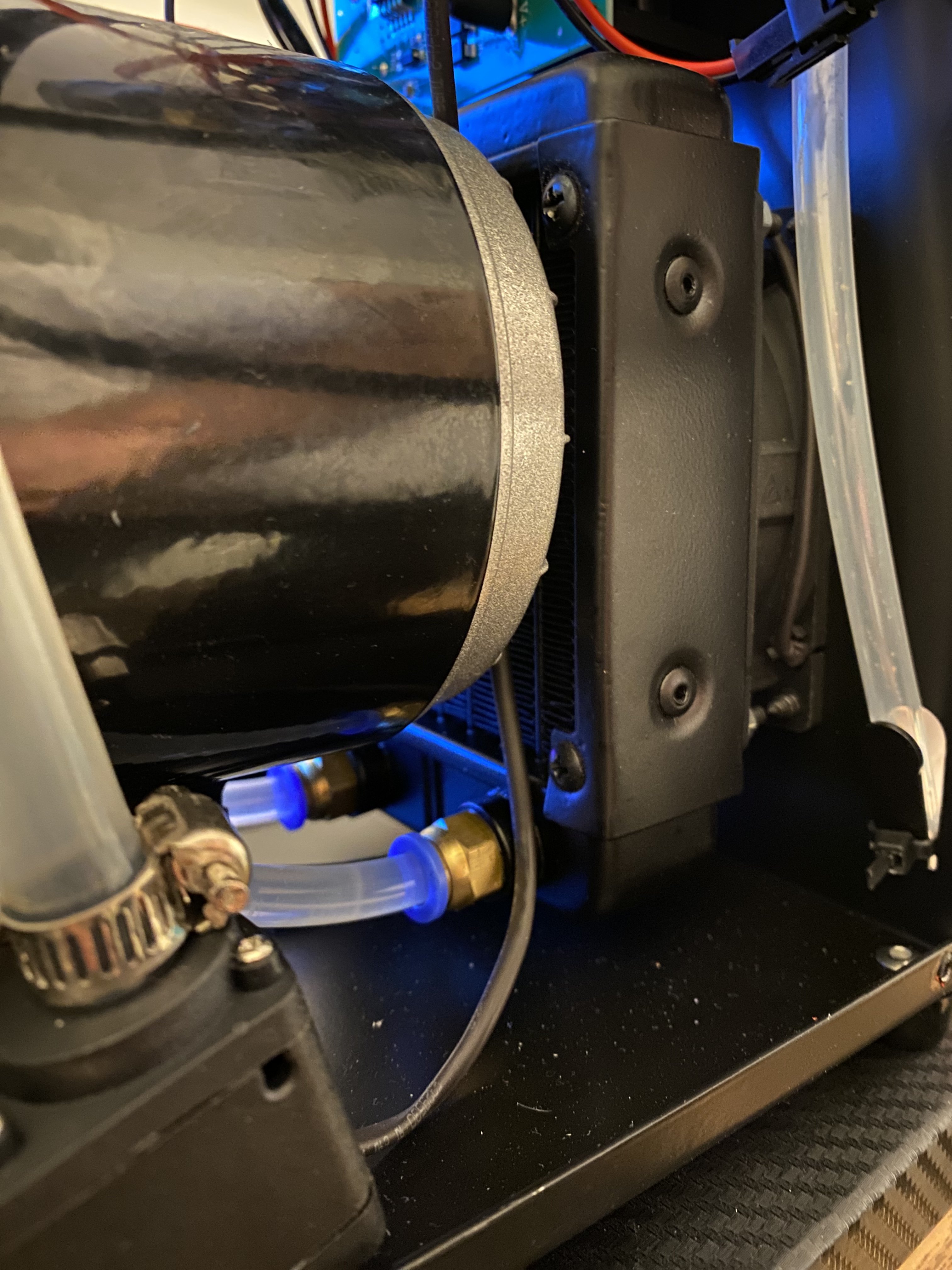

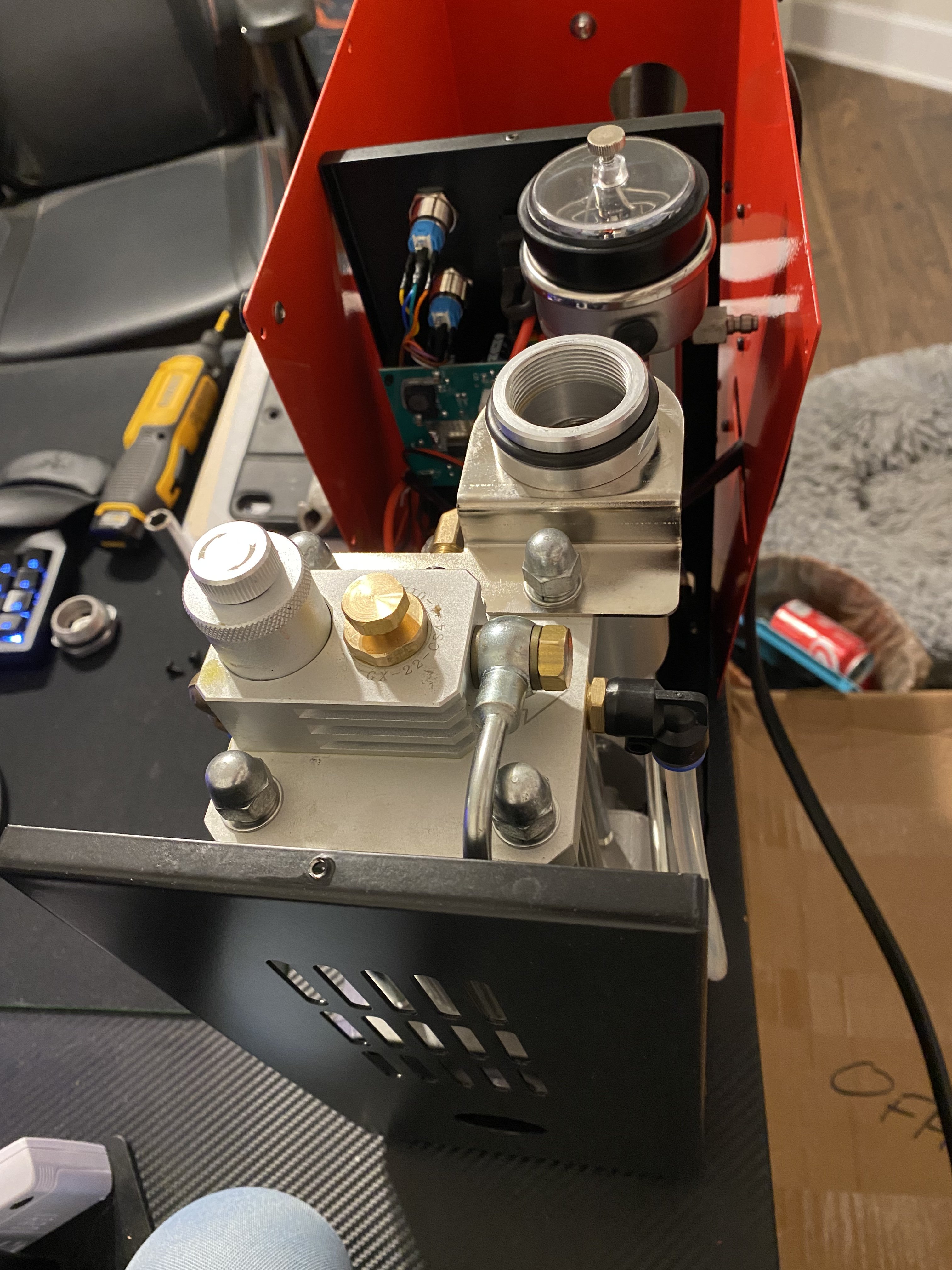

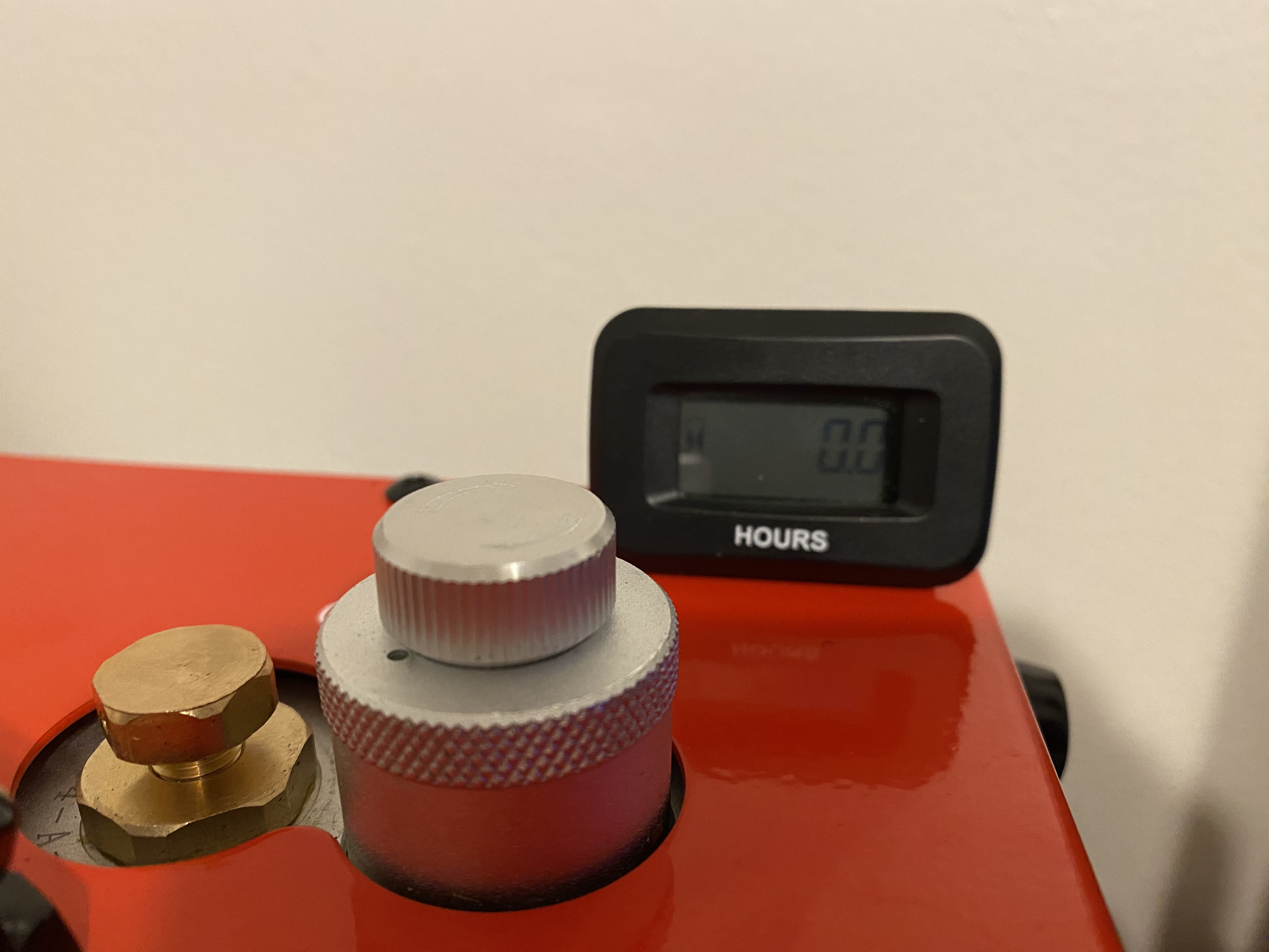

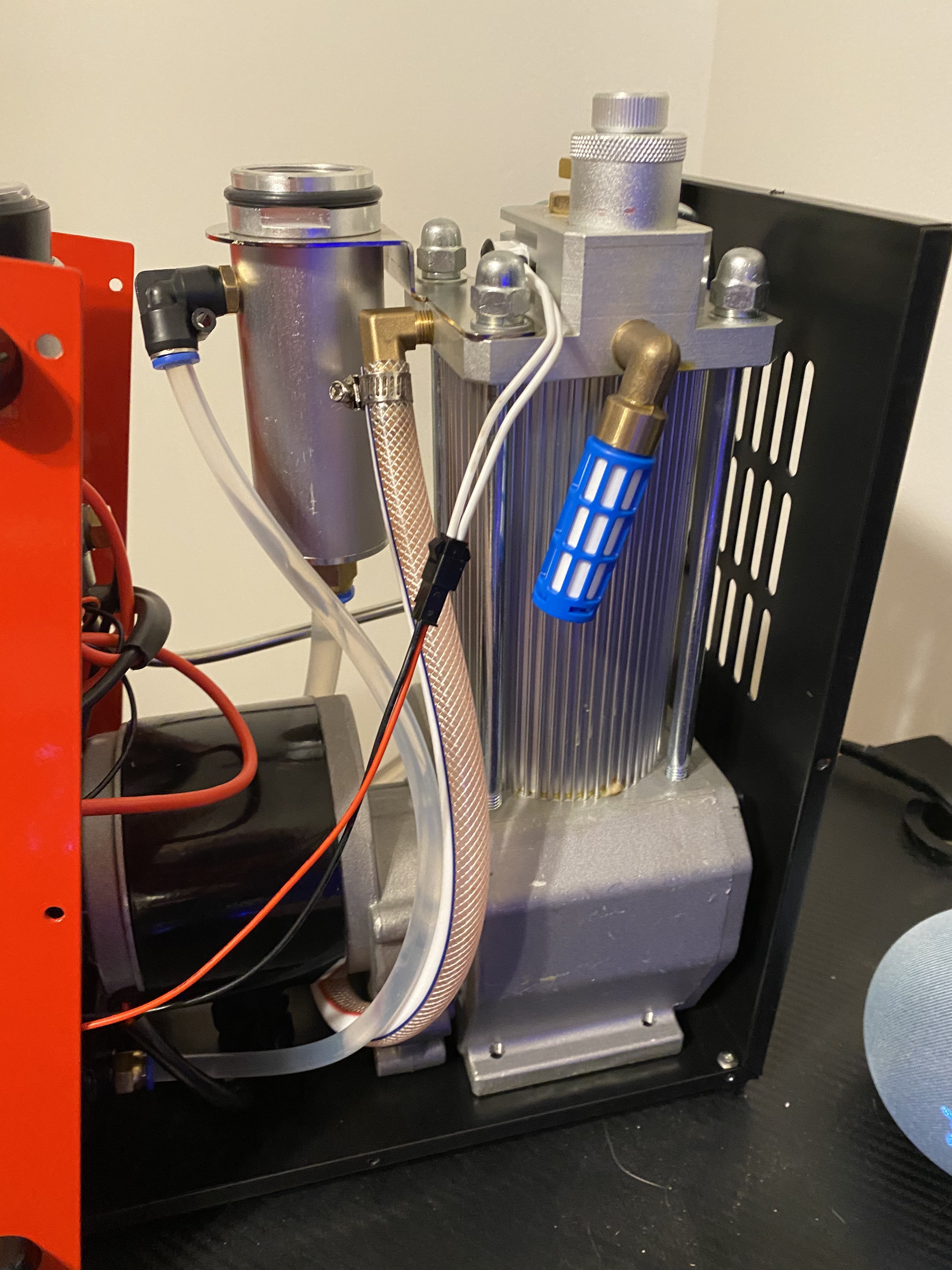

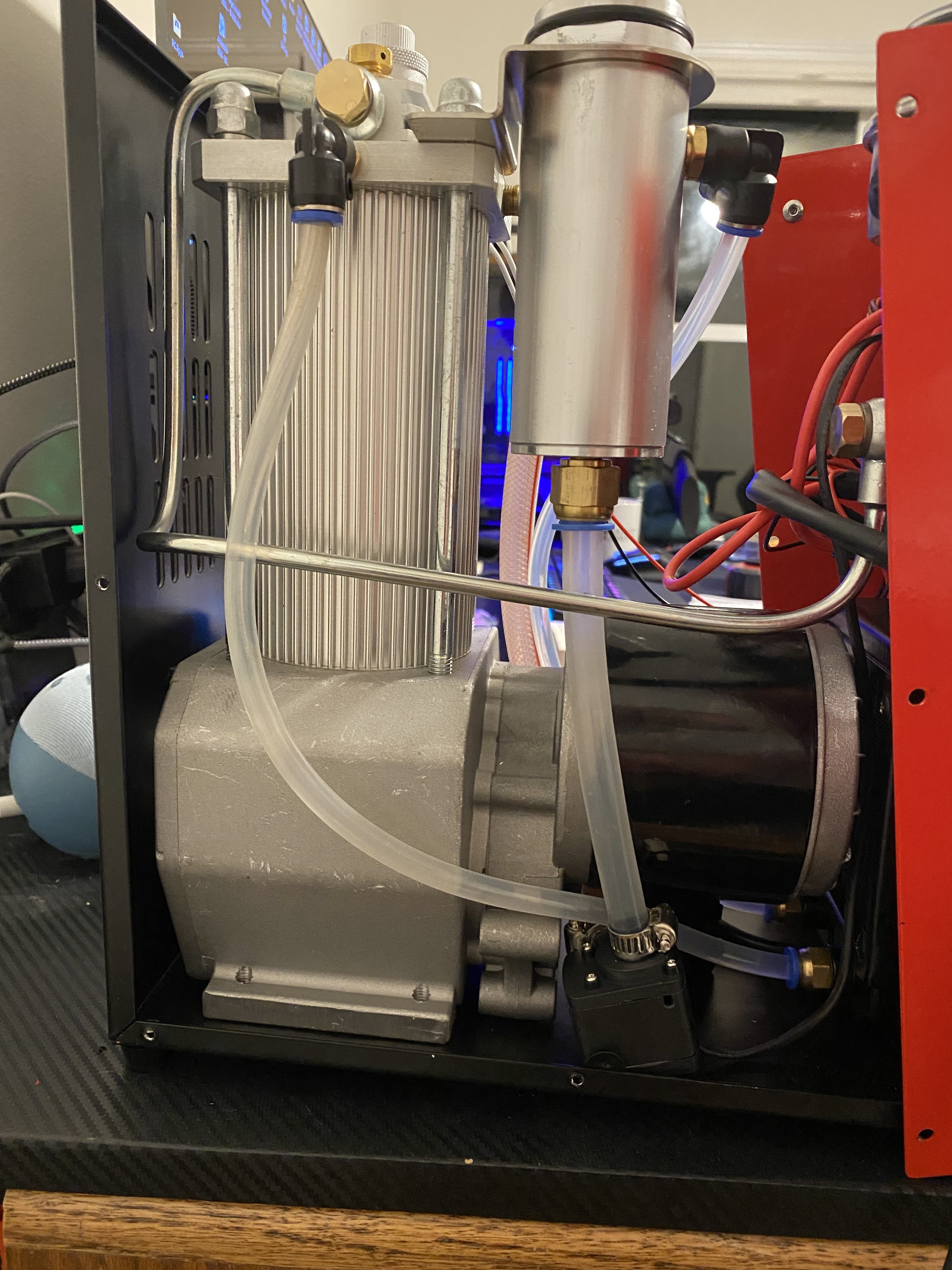

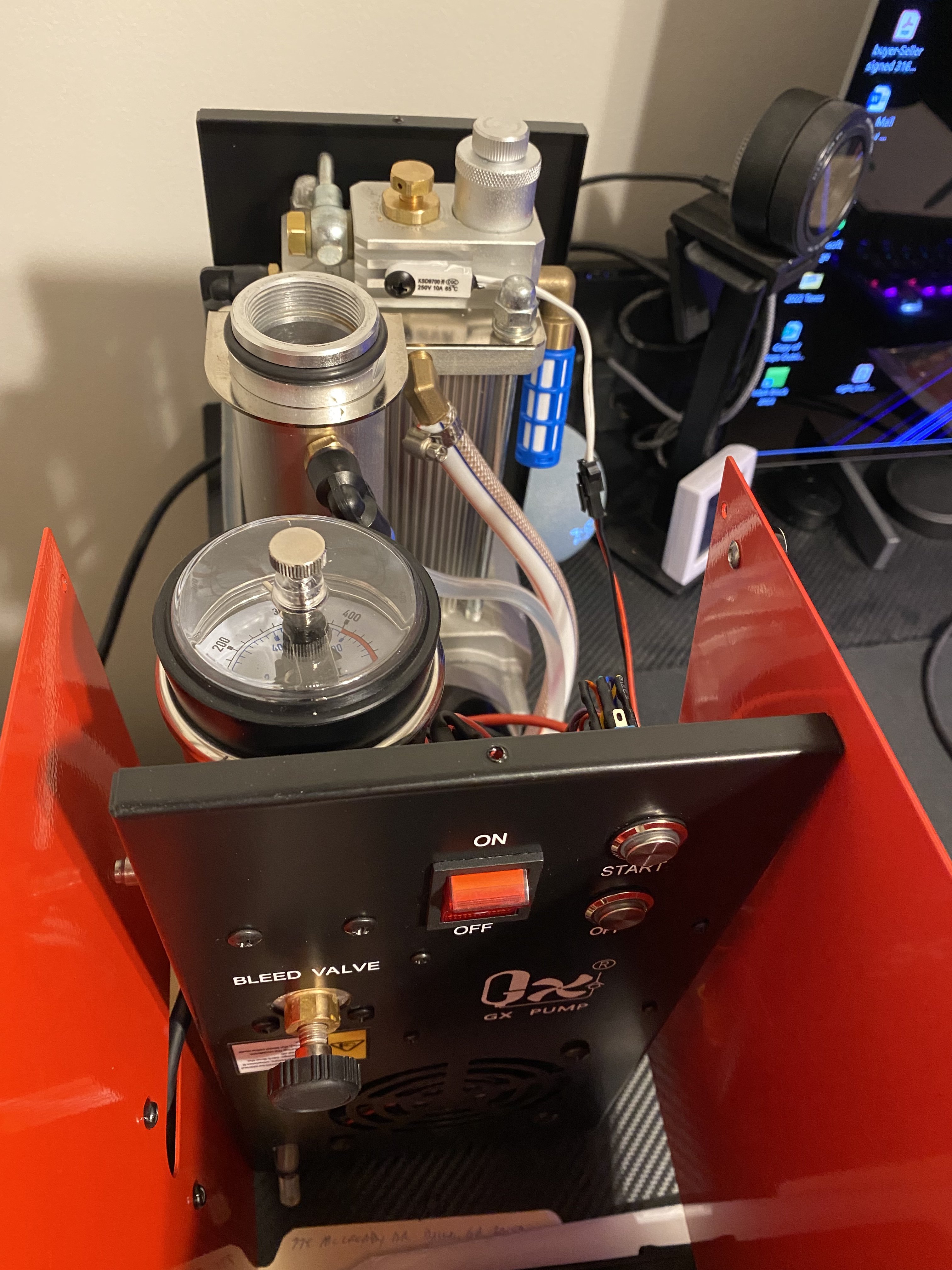

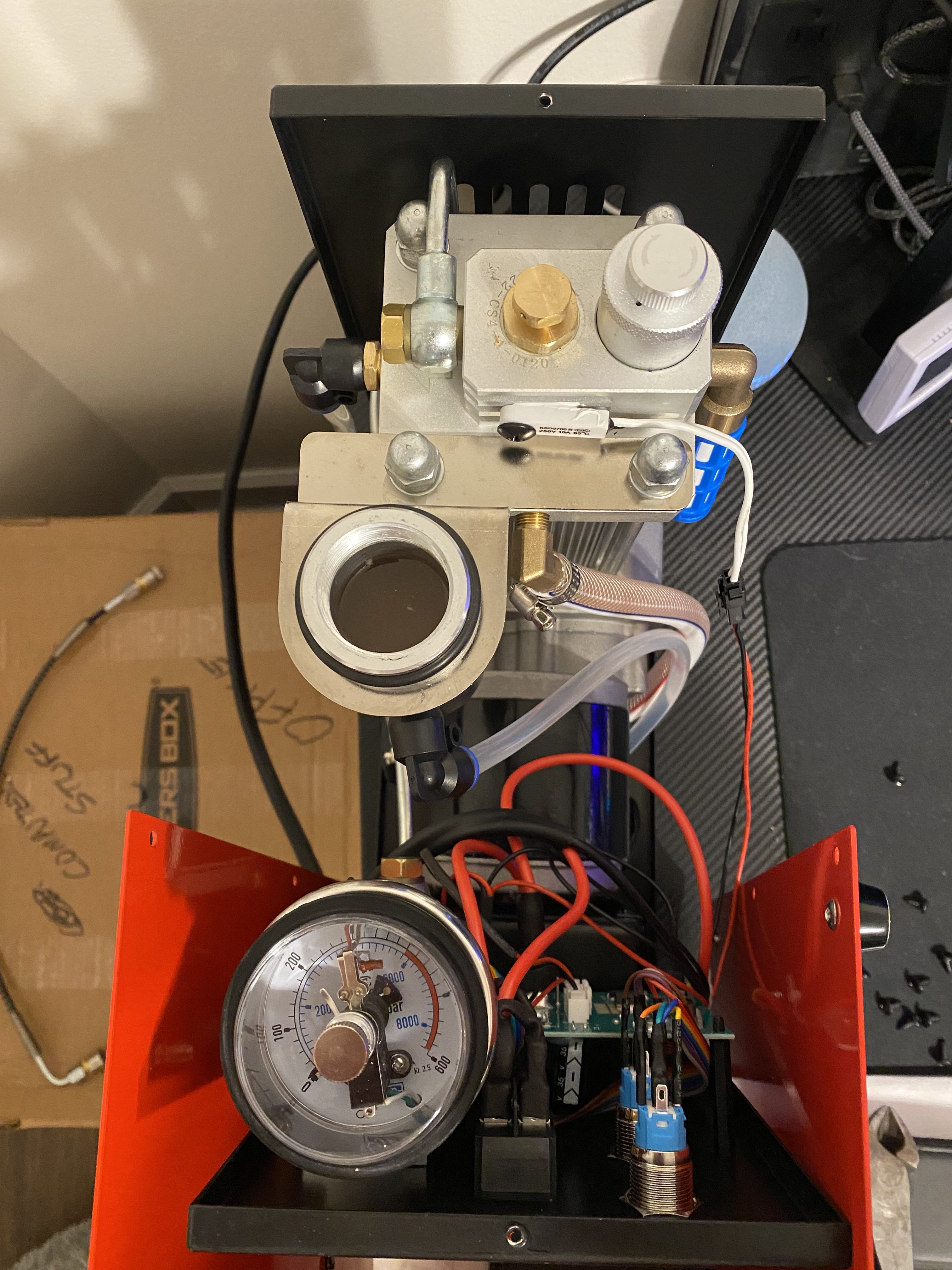

Sure thing. Opened it up today to wire up an hour meter. Just measures when the pump is running. the unit has a switch that turns on the fan and water pump and another for the air pump. Here are some pictures of the inside.
Probably will add a decent Desiccant Filter as well.

Can you see anywhere who is the manufacturer?
