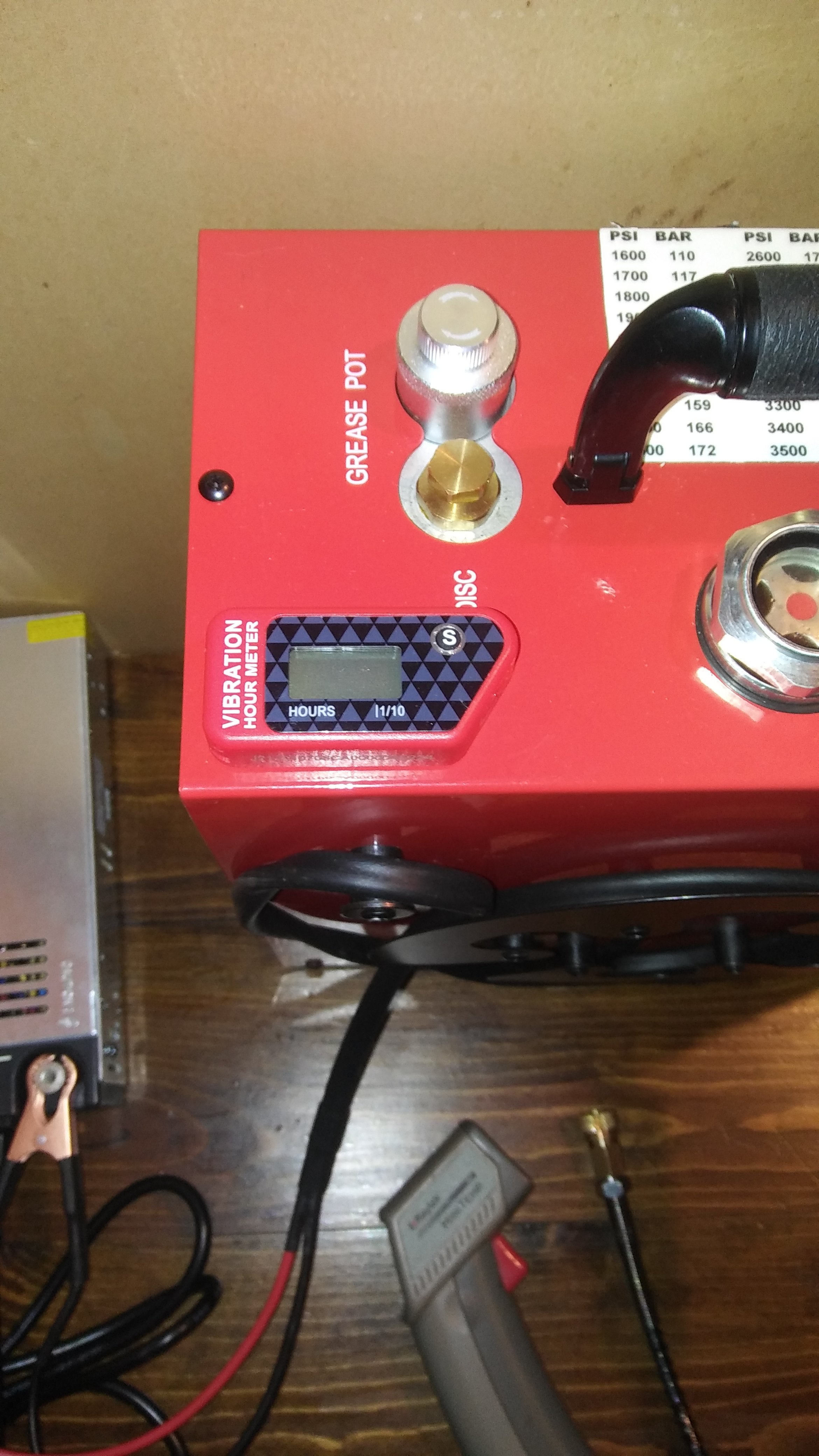

Mine arrived on Tuesday and I have used it a couple times. Question for those who added an hour meter, what type did you use and is it working? I added one of the vibration hour meters, but I'm not sure it's even registering since this thing does not shake like other compressors I've had!

This is the hour meter I use. 20 bucks off Amazon. It has low and high sensitivity. I use high.
So far so good on this compressor. Way better than either of the Hill units I had.
And it matches, nice! LOL! I have one of the square ones that don't have the sensativity setting. Sometimes when the compressor is running I see the little hourglass blinking, but other times it's not. I've only filled 3 guns with it so far, but it's yet to change from 0.0! I may have to try another one since I need to track run time for the grease pot! Thanks...

I added a generic hour meter I picked up from Amazon ( https://www.amazon.com/gp/product/B07Q3QF62K/ref=ppx_yo_dt_b_search_asin_title?ie=UTF8&psc=1 ). Wired it to the start switch so it only reads when pump is on instead just having the unit on. Connecting the wire was a little bit of a pain but works perfect. Good luck with the pump. Mine continues to work flawlessly.
I'm a little leary of attaching anything to the internal electronics of the pump, other than a tie strap around the cylinder fins for the temp probe. I'm going to give mine another week and if it hasn't registered an hour by then, I'll have to try something else. At least the 4-6 hour intraval for grease is large enough to compensate for a lost hour or two on the meter while I get it figured out!

My hour meter has a "lock" setting. That way it doesn't regester anything if you're transporting it. Had no clue if it was inlocked until it finally regestered some time.

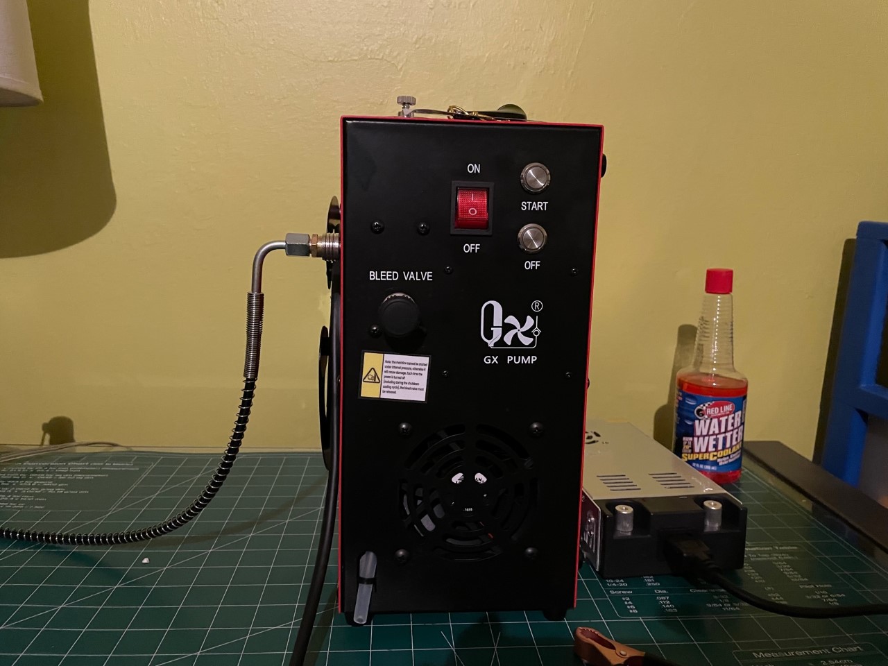

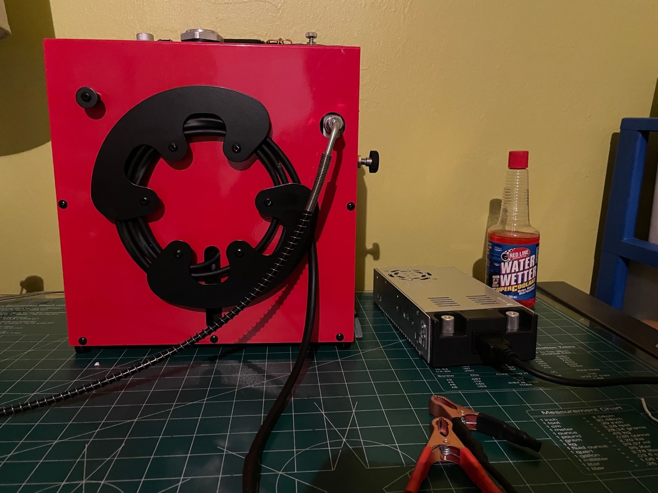

Is this good? dont see PH ?
Prestone DEX-COOL Antifreeze+Coolant; Extended Life -1 Gal- Ready to Use, 50/50​
Any time you use an antifreeze, you actually lose cooling capacity, because the AF makes the water more viscous.
Having said that, these compressors don't get all that hot, so it probably doesn't matter. AF will have anti-corrosion properties that are helpful, but even a system with AF needs "maintenance" in that you should check the Ph every 6-12 months. Low Ph is BAD for aluminum components (well, metal in general).
It is my opinion that WW will provide better cooling than AF, and also has a fungicide and is alkaline (a tad higher Ph). But I haven't gotten my CS4 yet, so I cannot test the heat gains with WW vs. pure distilled. More to follow...
