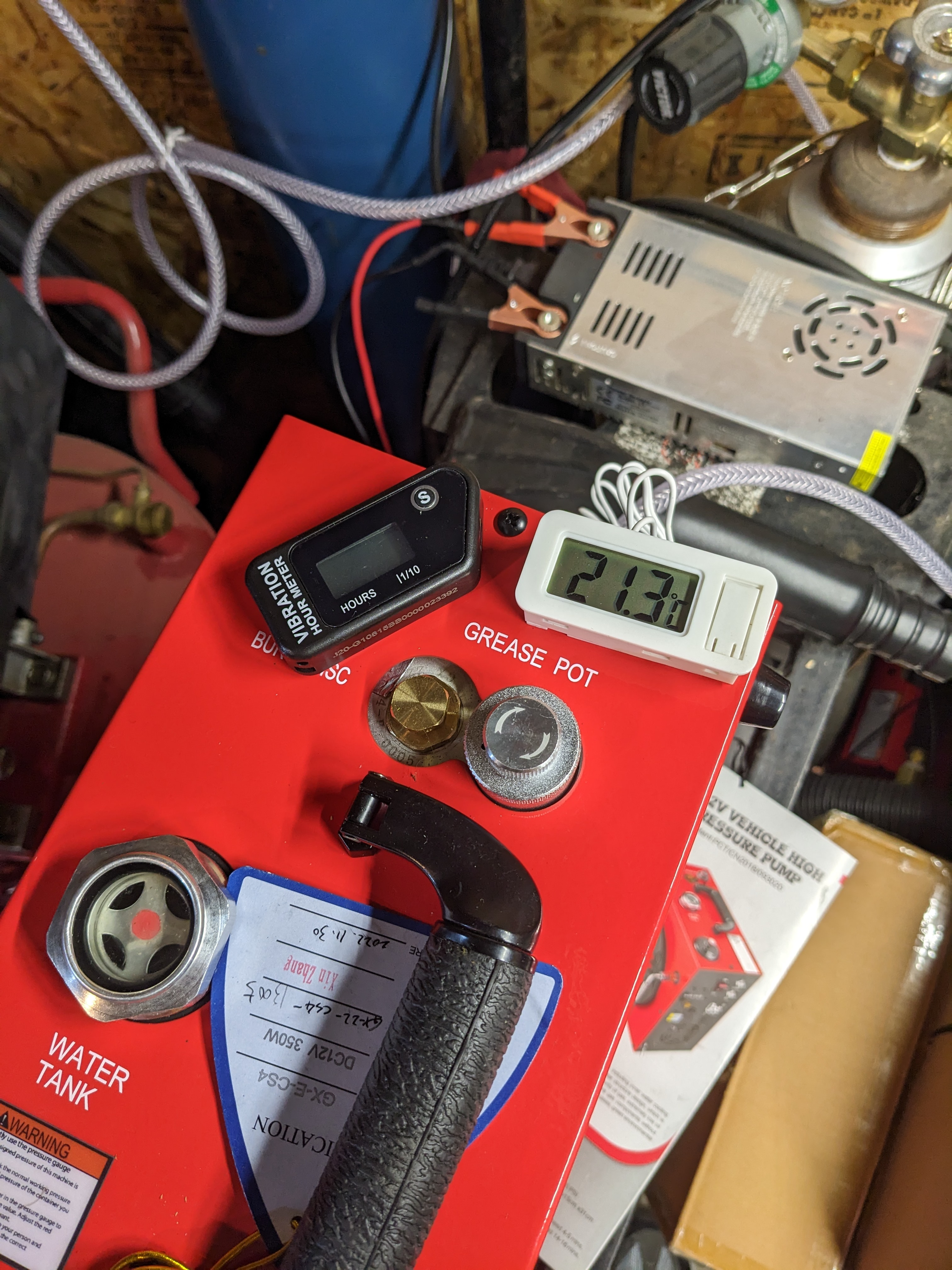

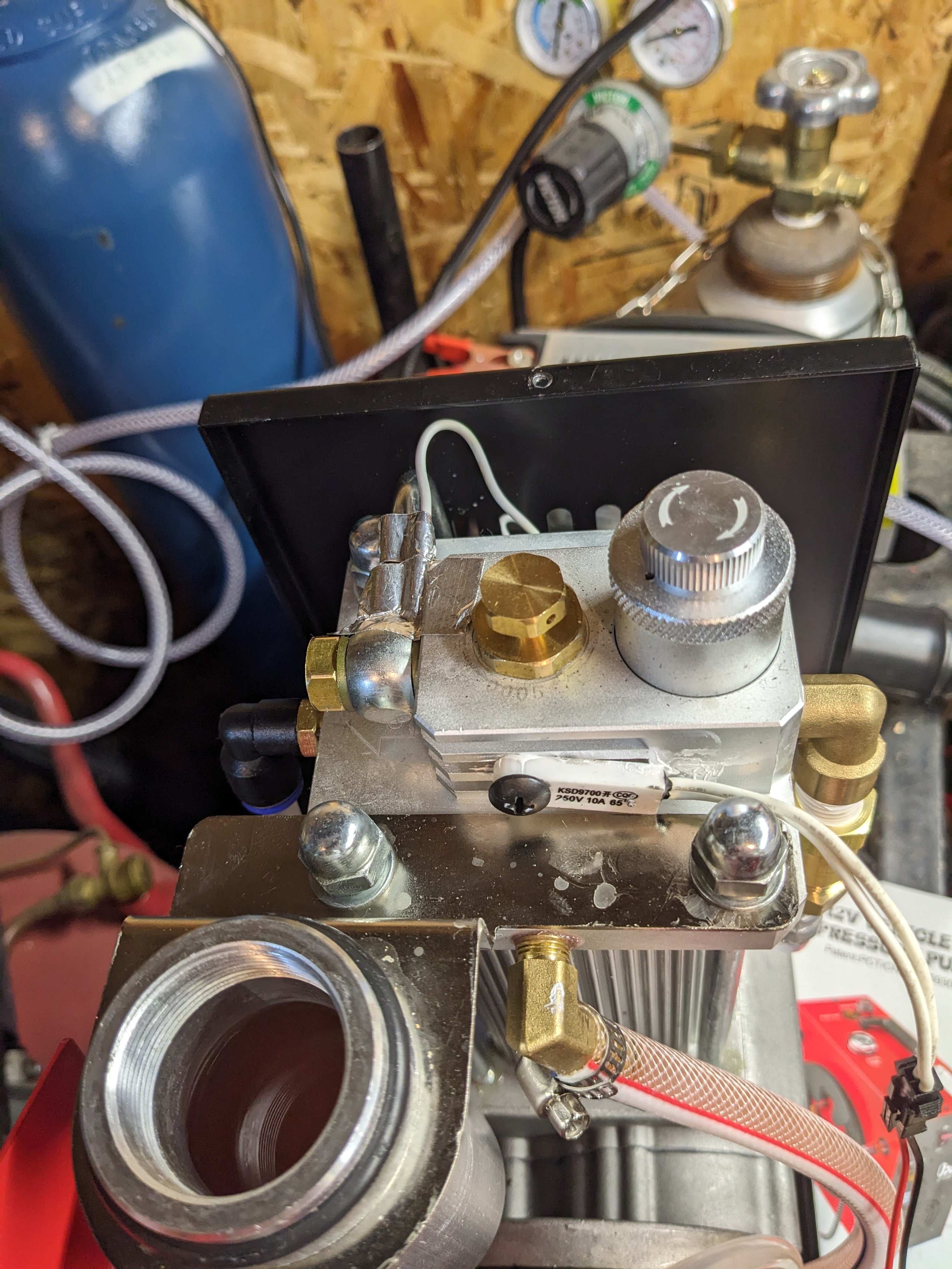

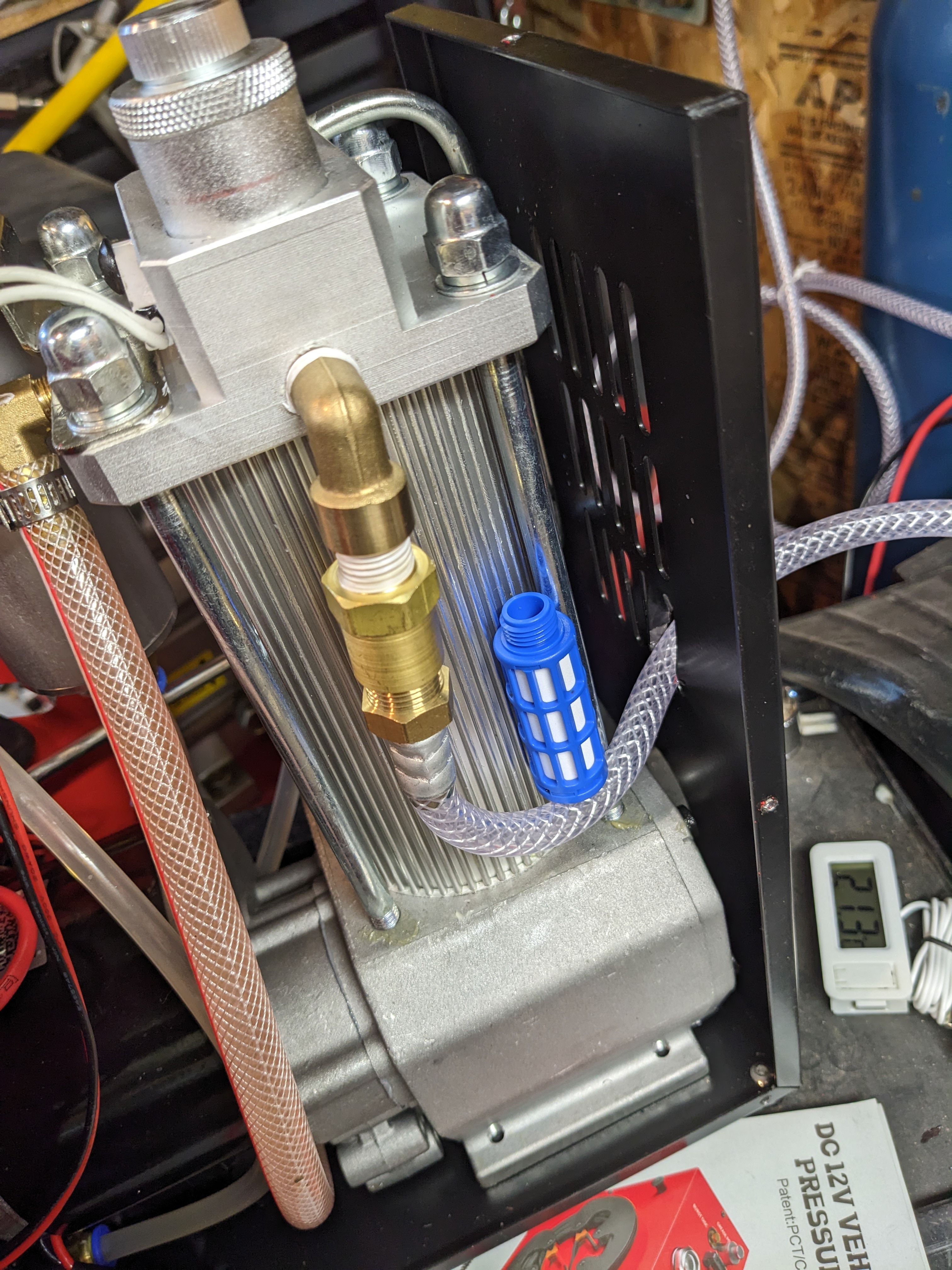

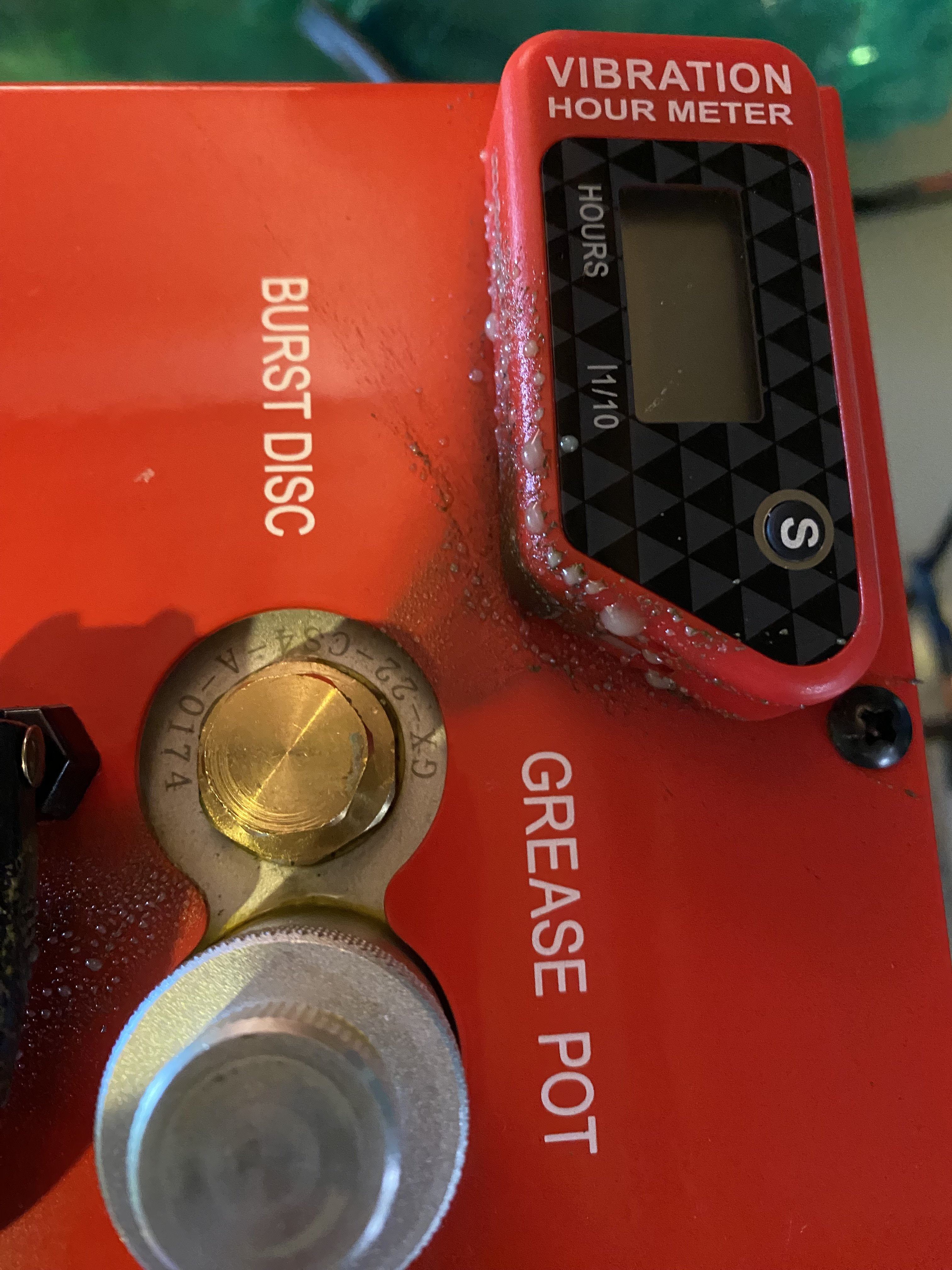

here are some pics of how I did this I also added a vibration hr meter and a temp probe to the pipe head connection
Based on your pictures, I just moved my temperature probe to the top of the cylinder. It slid right into the top slot on the head, just opposite the sensor screwed to the other side. I’m thinking that’s also a temperature sensor for the control board. It slid right in with a little friction, so it sits nice and snug and shouldn’t vibrate loose. Hopefully, my readings should be more accurate.

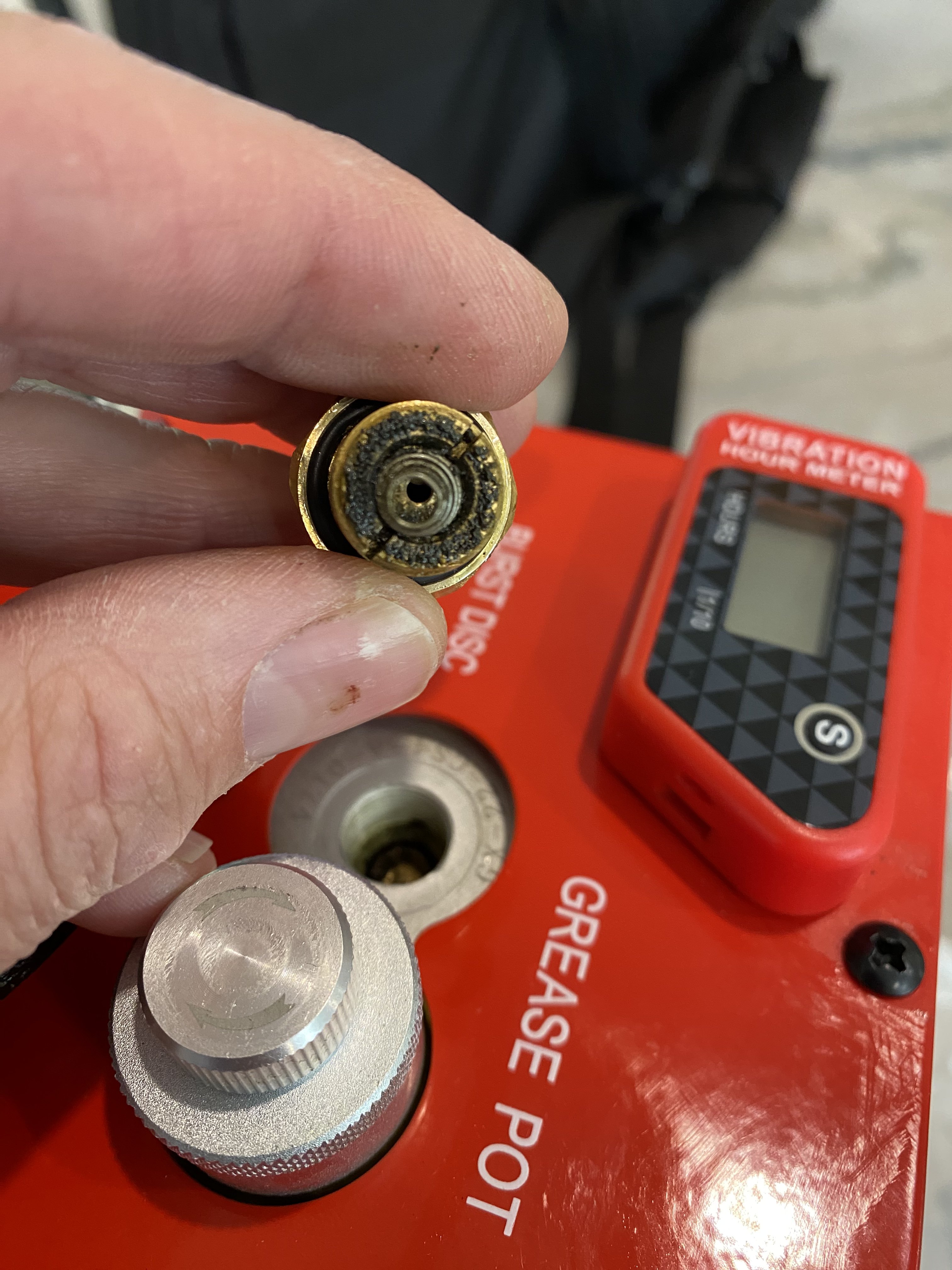

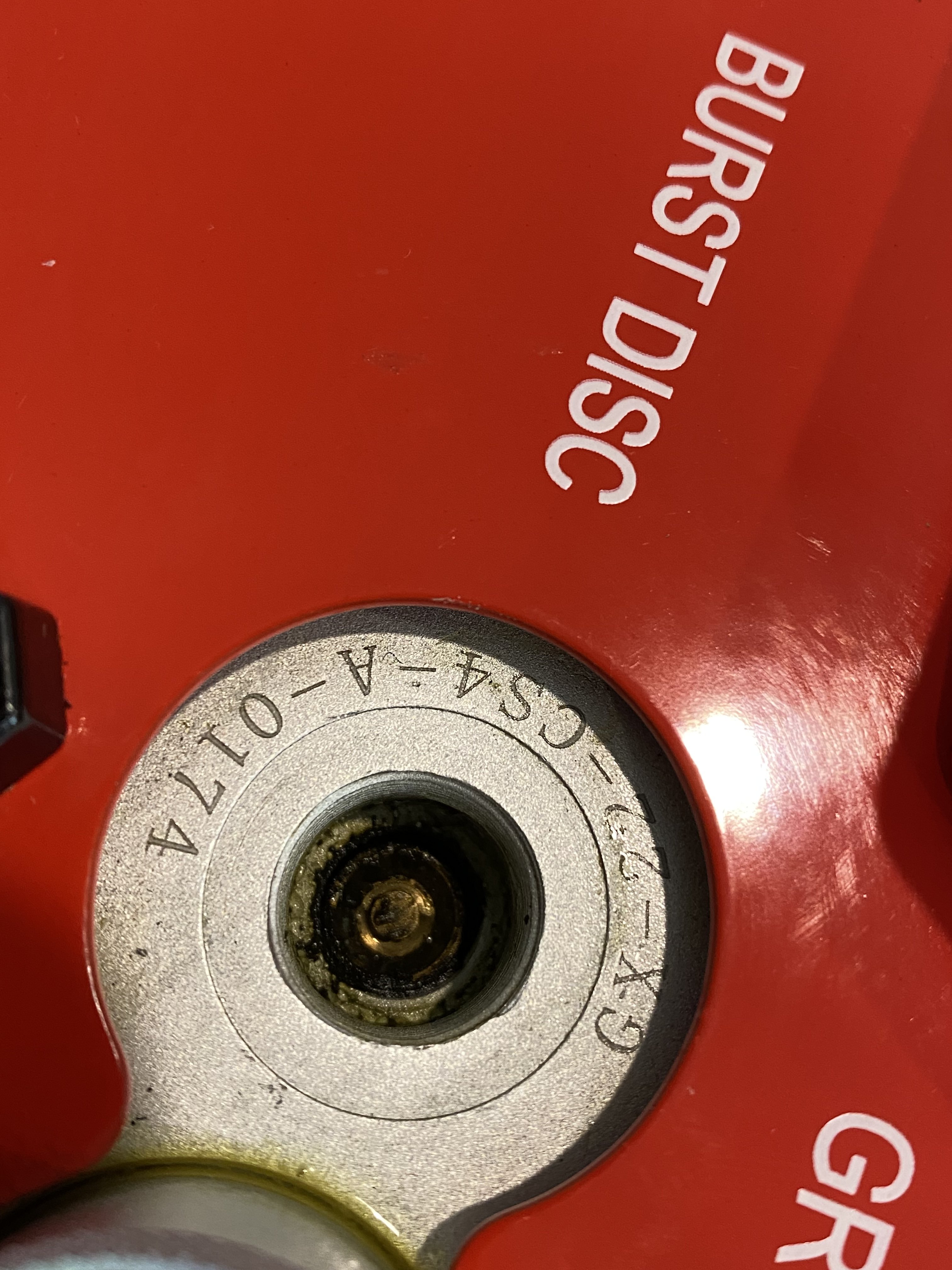

Looks like it, did you get some spares with your compressor? I know on my Hill, they are a scheduled maintenance item to replace a regular intervals. I'm sure they get stressed over time and need to be replaced so they don't prematurely burst. Do you routinely fill to 300 BAR? Since it's rated to 400 BAR, I would think the Burst disks would be rated slightly higher, but, that is a lot of pressure and they may have gotten fatigued. I'd replace it and then run it to 400 BAR useing the Deadhead and see what happens. If all seems good, caulk it up and keep moving, if it bursts again, or the compressor doesn't seem to be running like it did before, I'd contact GX direct and see what they say.
Reactions: Boogie
I’ve seen the Omega Trail Charger over pressure and blow the burst disc without warning.
Take out the check valve assembly beneath the burst disc main bolt. Good chance the check valve and seat will be dirty with carbon. It’s a very simple assembly. Clean it up with WD40 and it’s good to go.
Yes it was filthy in there! I cleaned it up and put it back together and it seems to be working again.
