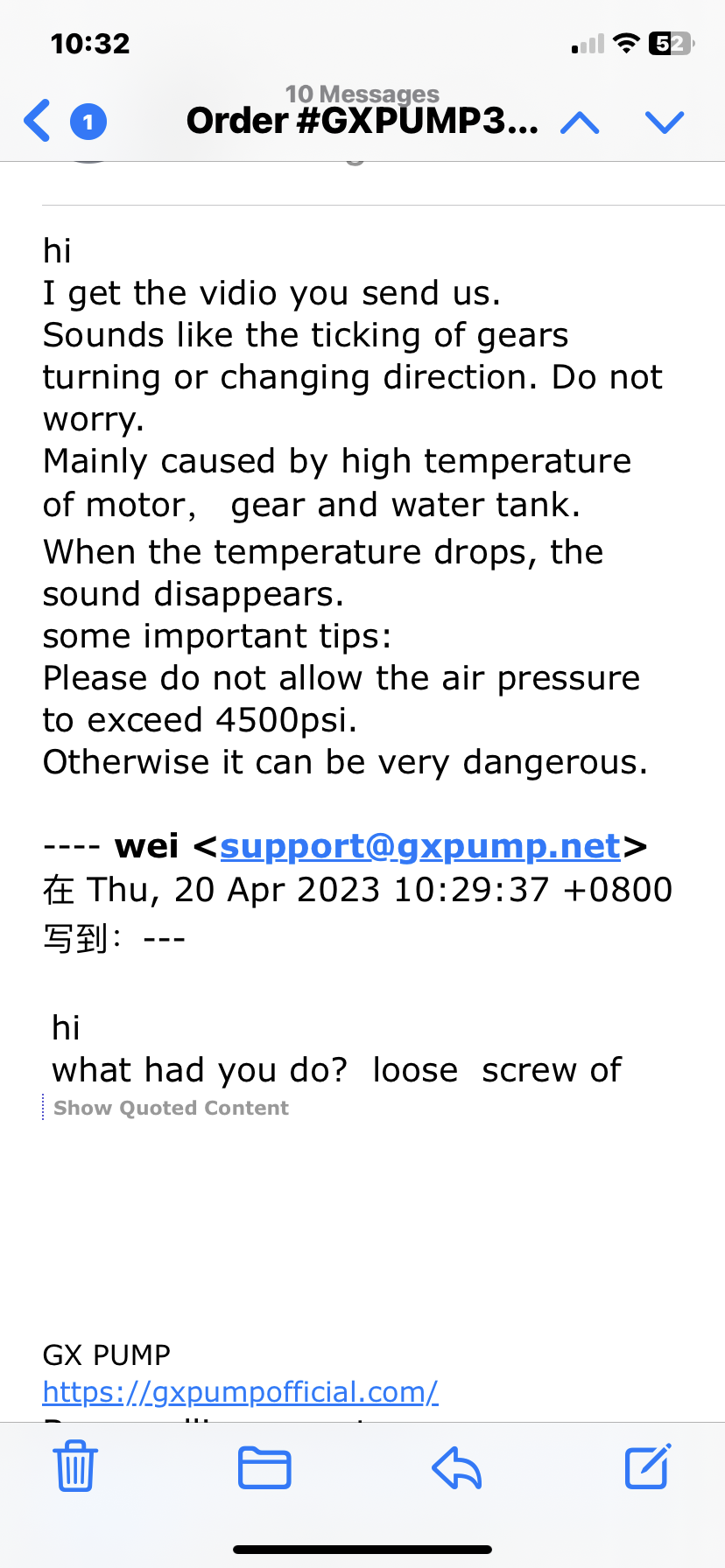

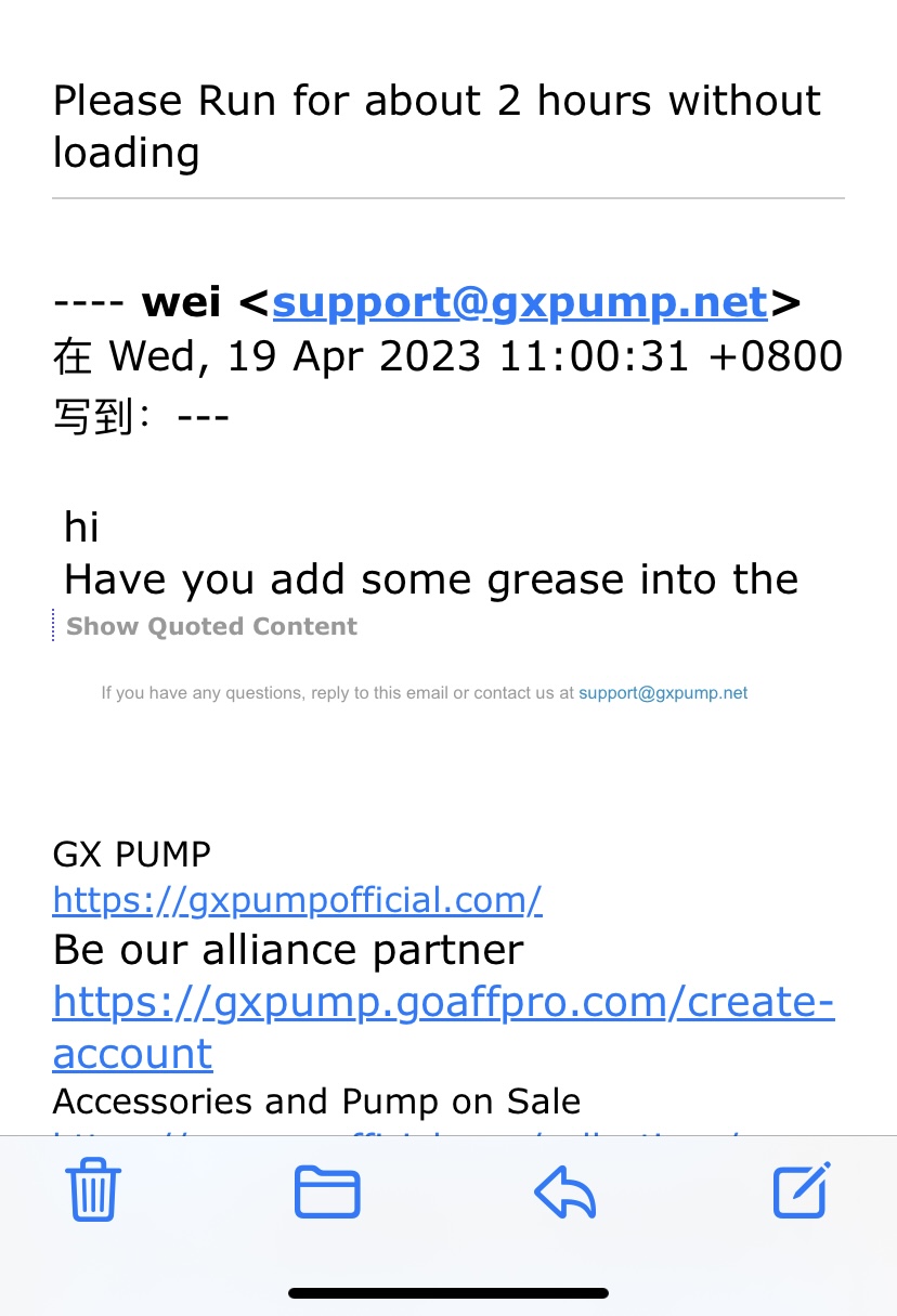

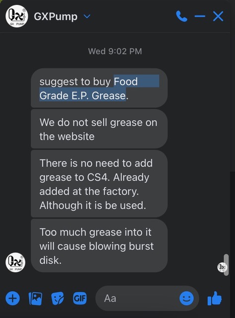

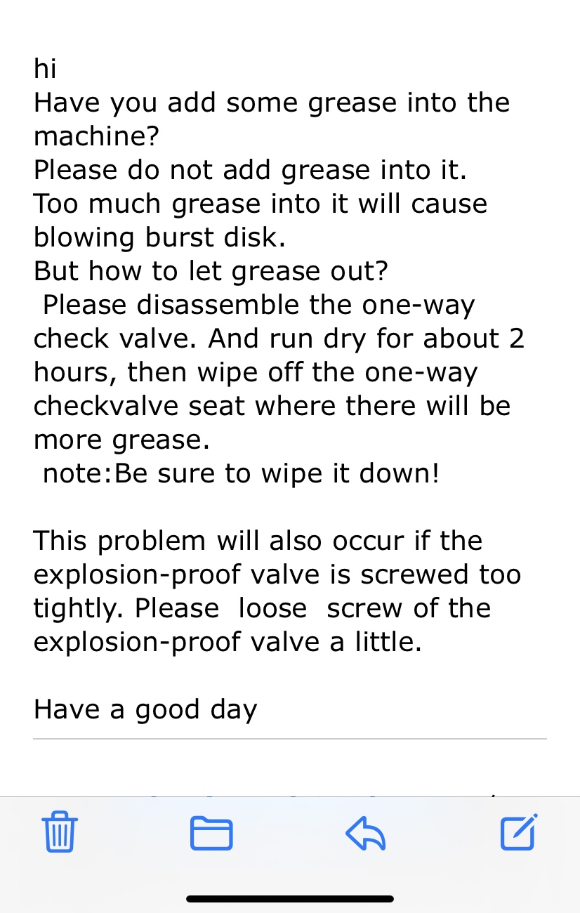

Yea I was wondering if it is the filter I added 🤷‍♂️ I did get a email back so I’m going to try what he said to do
