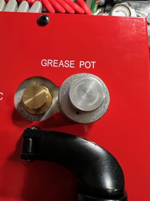

Any input on where the check valve is located on the CS4 and how exactly to clean it?
The check valve assembly is beneath the large brass nut on top of the compressor, beside the grease knob. Just unscrew the large nut and there will be a small conical spring and odd shaped check valve. Lift both out with small needle nose pliers or tweezers, clean up everything with WD40, then reassemble. Very easy once you see it.
I recommend not spraying WD40 down into the check valve hole. Use a paper towel or such, with WD40 on it, to clean out that area.
Uh No No No. No wd40. Just wipe it clean with paper towels. Any wd40 residue can detonate. It doesn't need lube the grase will get to it.
You will need a 19MM socket for the large nut. Inside you will find a spring, valve and small ball bearing. Don't lose the ball bearing.

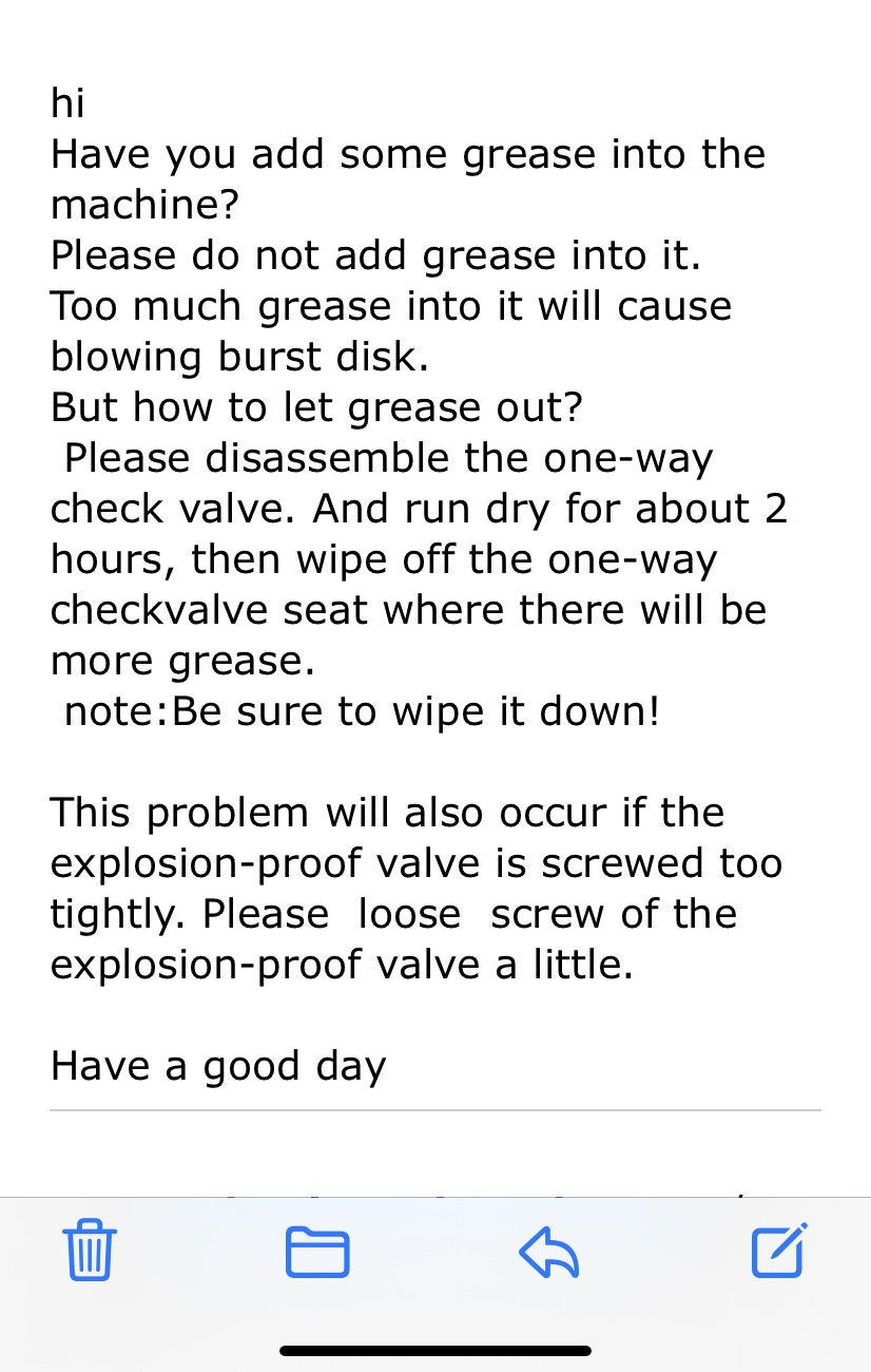

Thanks..Does the burst disc come into play??
