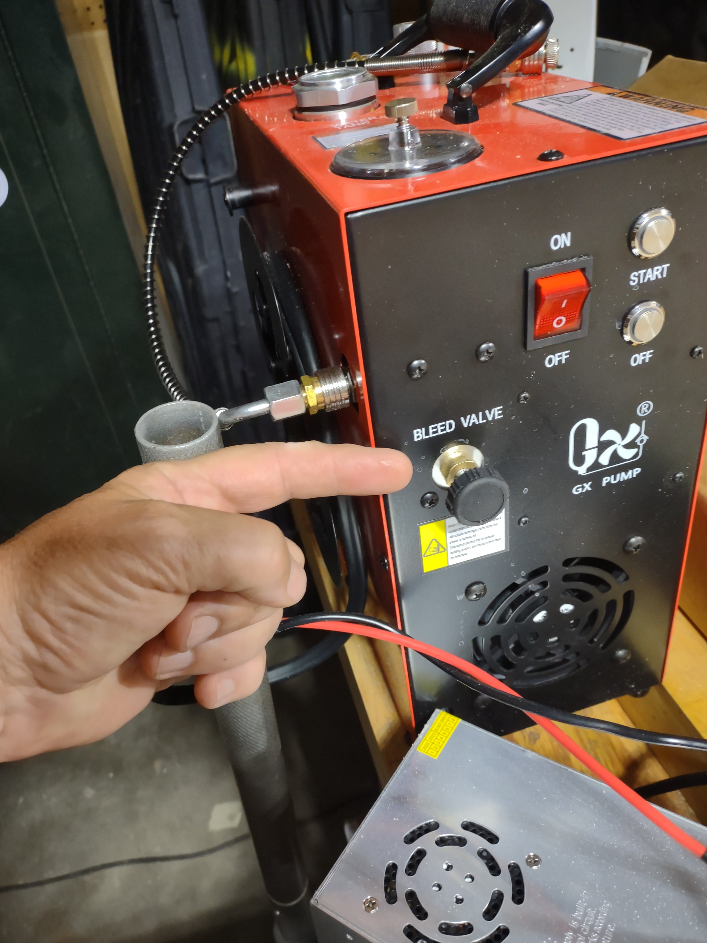

No, it is a coalescing filter inside the case under the cover.
Does it automatically drain somewhere or have a manual bleed off? I have a relative that is looking into one to fill his FX Crown but lives in a tropical environment where humidity averages 80, and wonder if he would need to add another filter or if the coalescing filter would be adequate.
Yes compressing air will create moisture. ESP if you are in a humid environment. It may not have much to bleed if it’s just run for 2-3 min. But anything longer and you will get some moisture when you bleed the compressor to disconnect it from your rifle.
I would still run an additional water separator/filter. I did a fill this past weekend and thought just to be careful I would run my JB Alpha Filter. I'm glad I did as moisture was getting past the CS4 "separator/filter" and when I bled it I got a couple of sprays every 7 minutes. It left a small puddle under the Alpha Filter when I was done. Don't take a chance and expect it stop all moisture. I also have a new issue as when I moved the CS4 there is a puddle of coolant under it.
