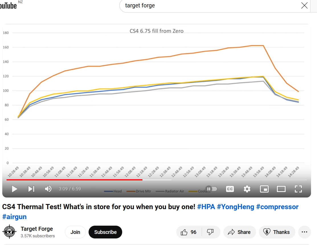

I notice that the Target Forge guy has a youtube video showing the CS4 running with temperature sensors recording the temps.
His readout was shown after the test as this...
The temp of the cylinder was the highest, which had me thinking that maybe in the interest of a longer life for the pump we could do a similar thing as per this Yong Heng mod from a forum member.

That was a four(4) hour run Target Forge did. You should be able to top off any tank in four hours. I filled a 100 CF tank from empty in two runs with the GX 4. Two or three hours is about as long as I wish to monitor a fill. Personally think the cooling of the GX 4 is adequate

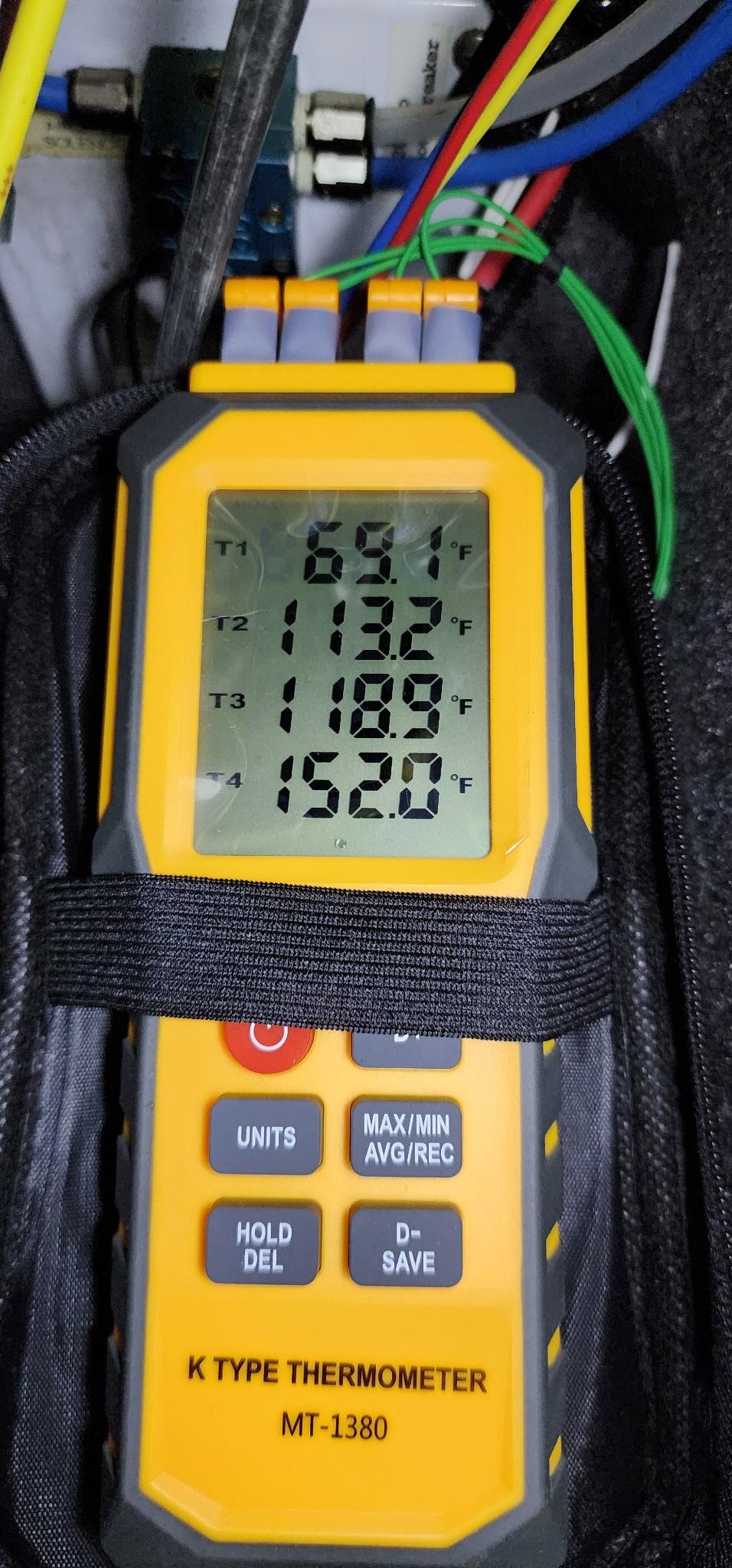

Hence my use of temperature probes. I measure Ambient, Coolant, Head, and Motor temps. If the coolant & head temps are staying around 113°-118° F, I don't see a need for adding any mods that make the unit harder to use or less portable. Just my opinion, of course.
If I want it to run cooler, I'll bring it indoors where I keep the temp at 70° F and the humidity will be lower.
