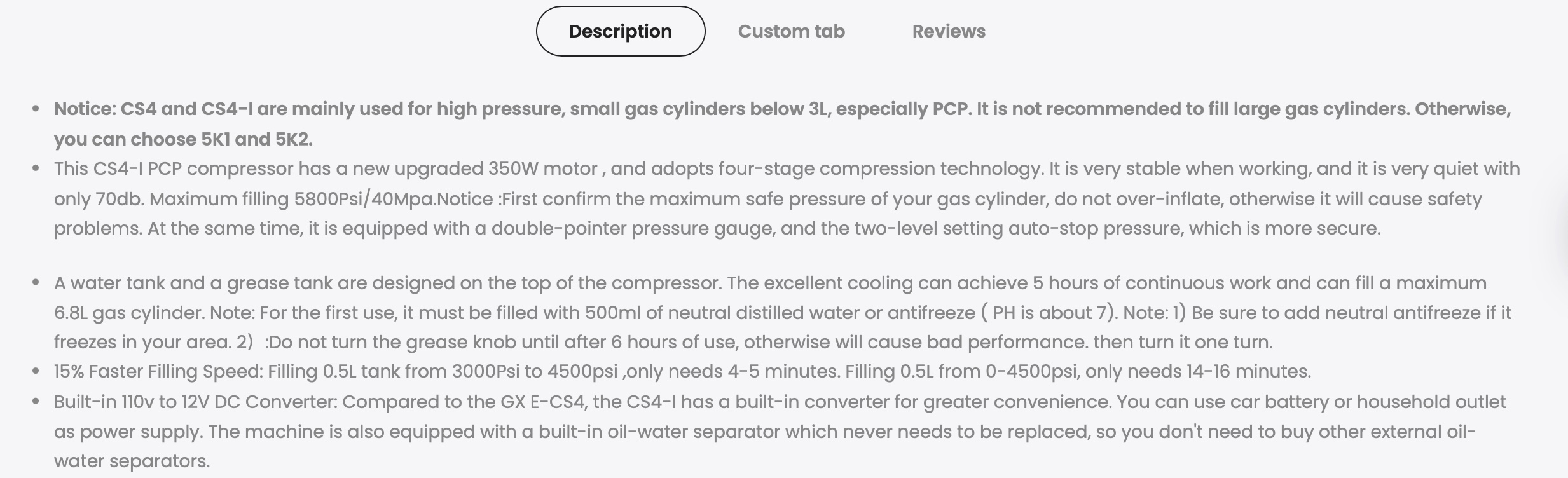

Interesting update... I just went to the Official GX Pump website and see where they have the update posted in bold as the first bullet in the description:
But, the 3rd bullet still states you can fill up to a 6.8L cylinder with a run time of 5 hours... Seems to be some conflicting information!
I noticed that GX has a lot of conflicting information, especially when you read their footnotes. I'm not super enthusiastic about this derating. I have a CS4-I showing up this week to fill 3L tanks and hoped to have headroom for larger tanks.
I don't think you need to worry - my bet would be that this is just a marketing ploy . . . . and from what I read, nothing is "de-rated" in this change.
They aren't actually changing any of the "ratings" for the unit - it still is rated to run for up to 5 hours and put out the same pressure and all that. They are just now "recommending" their bigger compressors for the larger bottles - and why is that? Because somebody decided it would be better for the CS5 series to be able to actually have a "recommended" tank size application, rather than just to have a faster fill rate for those units. So they changed their marketing message, but not the products . . .
