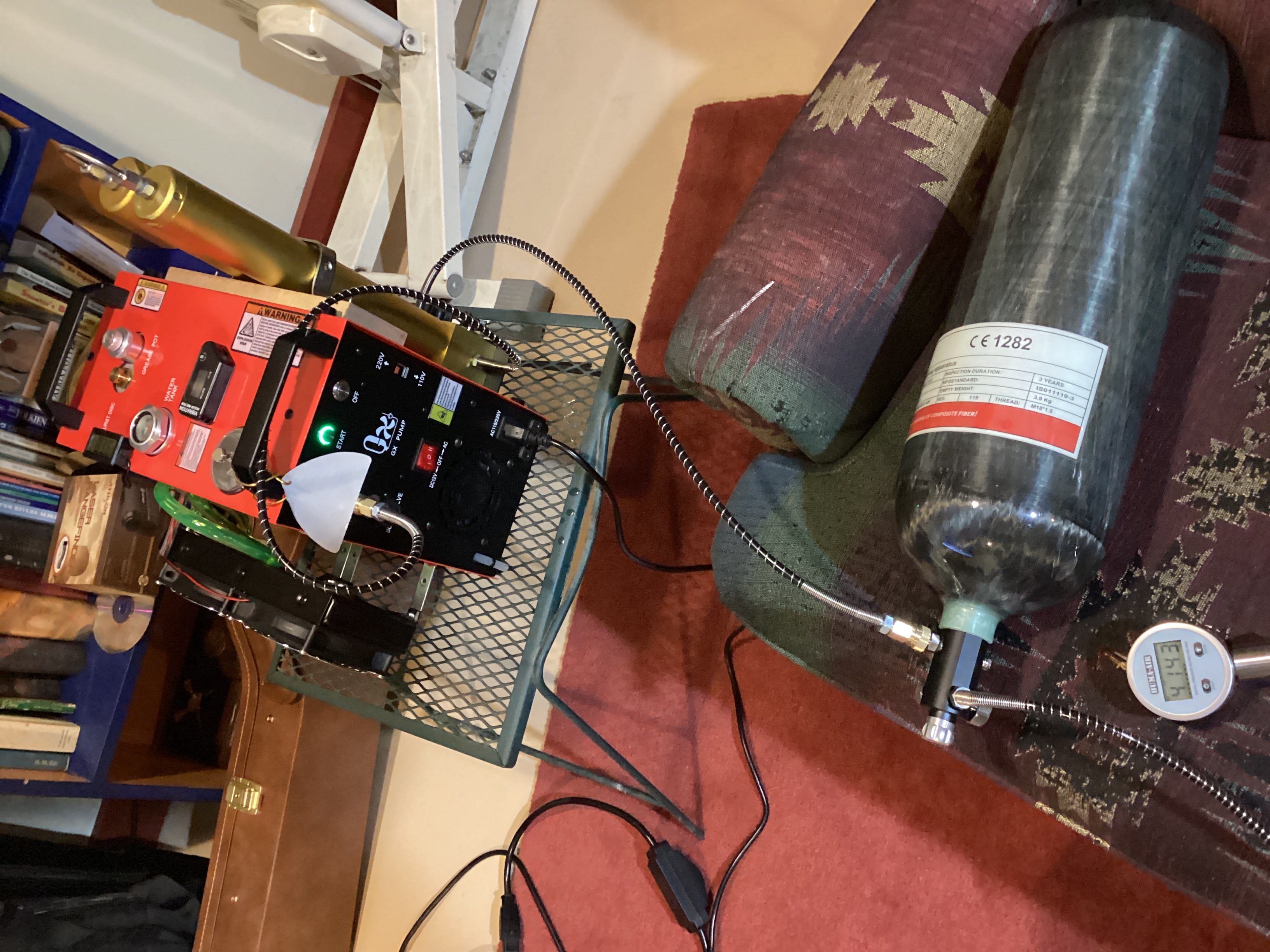

I have added a radiator and computer fans, I got the idea on here and I will find his name for credit. This was done after the 5 hour run just for the hell of it. In that 5 hours judging from touch it was no warmer at 5 hours then 30 minutes .

Ok at 3:30 hours at 79.6 f 3327psi went upstairs to watch a show with wife. Came back at 4:30 hours and it wasn’t filled.
I suspect a leak in the new valve that I quickly put on . Anyway at 4:30 hours it’s 82 degrees f , 4100 psi.
Filling the 6.8 is going to take longer than the 9. Maybe didn’t tighten something.
Ok final results, why did it take longer than the 9 liter.
We‘ll see overnight, ohhh forget that , I’m watching the huma gauge
go down . So it did get to 4500 psi in 5:20 81.6 degrees f
at least an hour too long.
no it didn’t turn off
that's awful, fill up a tank and take so long and then it's leaking out.. I'd be very frustrated..
probably took longer to fill because of the leak..
a note I'd take from that is if I was to work on a bottle, guess it should be aired up to 100-500 and then soap test for leaks..
lots of time on the compressor and then probably wasted overnight leaking out. likely whatever the leak is, probably have to be empty and change a o ring or something..

Just to clarify... it's just a "recommendation" for the cs4. Not that you can't do it. As seen, these can still run 5hrs. I do not see any issues doing so.
It is mostly the paintball and airsoft guys wanting faster fill times, so the k5 is offered up.
Bleed the air from the radiator and these things will chug along without issue. Just be sure to purge the water trap every now and then.

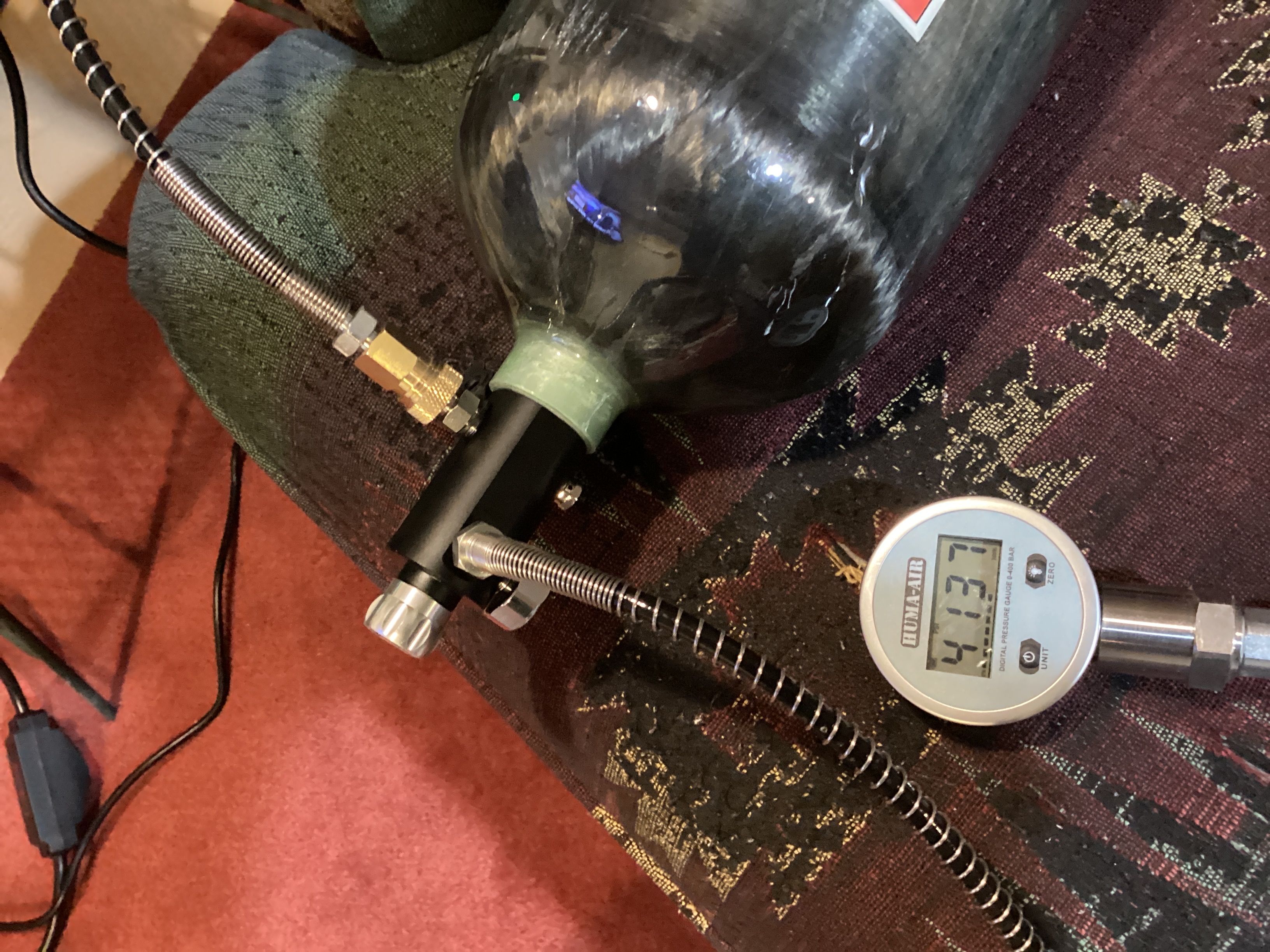

Filling the 6.8 is going to take longer than the 9. Maybe didn’t tighten something.View attachment 540003View attachment 540004
Turns out it was my Huma digital gauge hose fitting that was leaking. Still gonna replace the one in the tank now. The main shut off is kinda small to handle.
