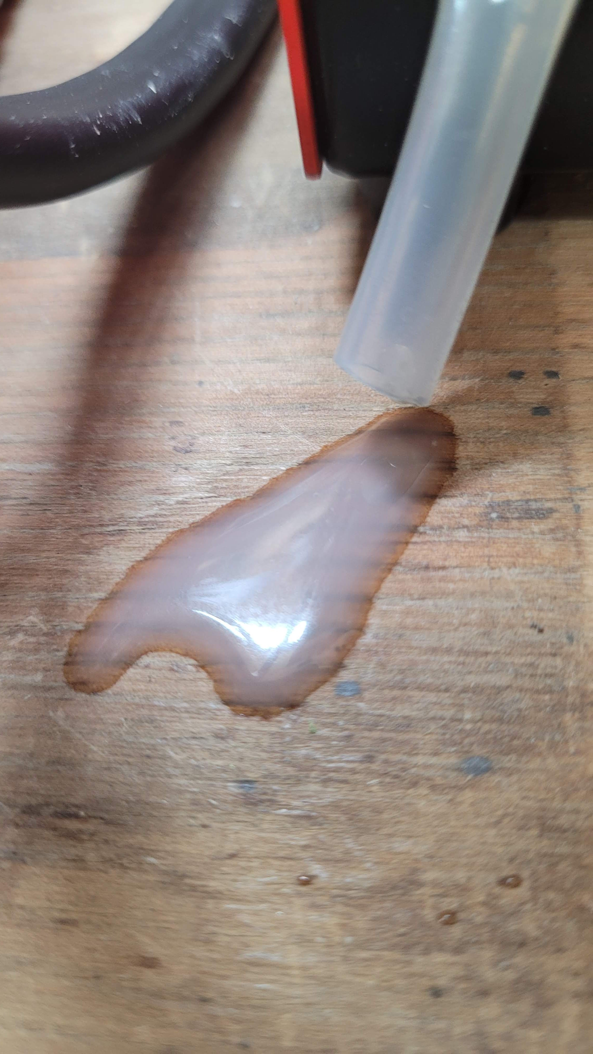

Visible oil in the bleed water. Photo attached

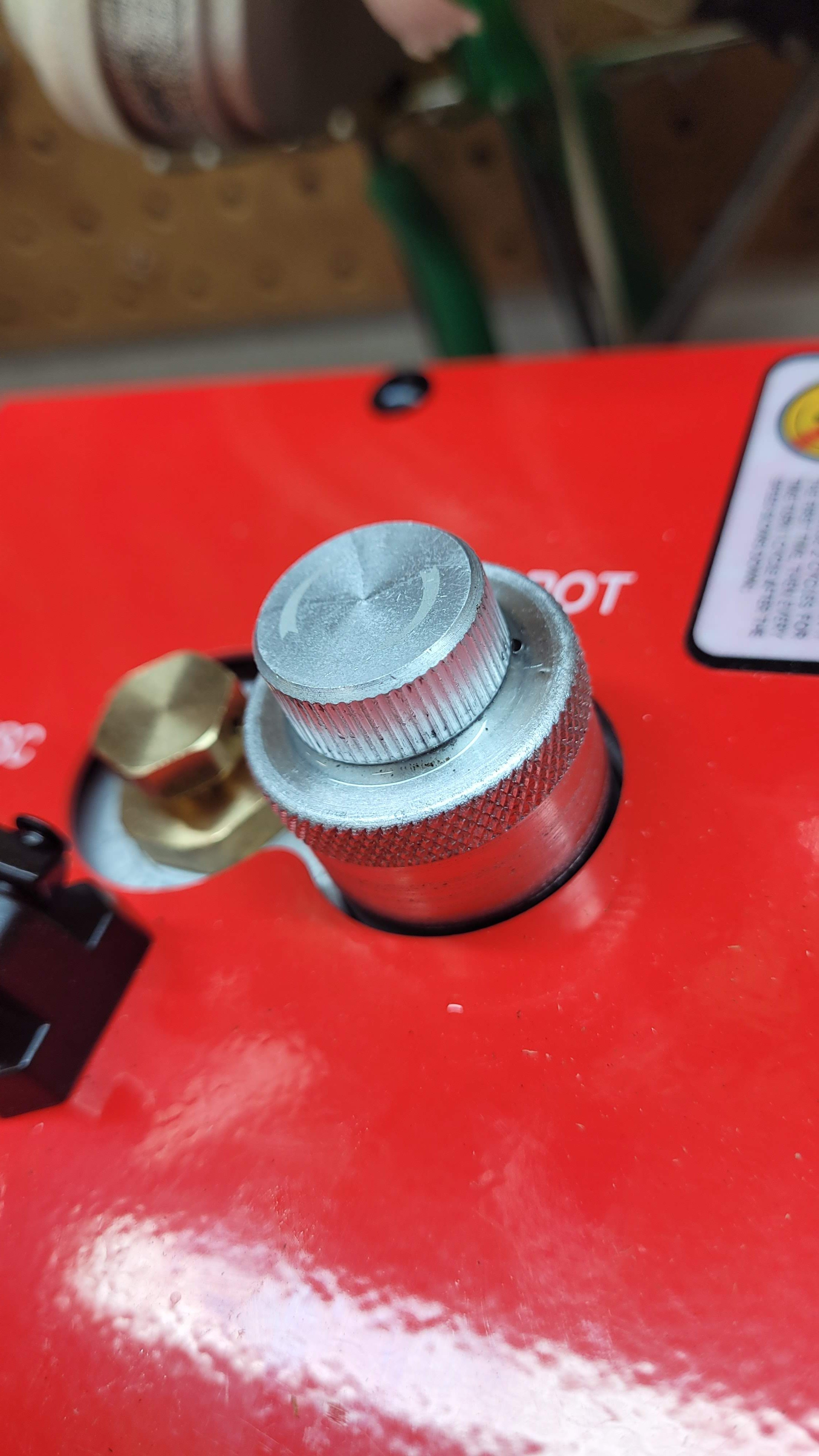

Grease seeping out of the top of the grease pot, under the turn knob. Photo attached.

It's hard to diagnose via pics, but my guesses are:
Oil (actually grease) from the bleed valve is normal. If over-serviced, more will be present for a few uses. (Did you turn the knob at ALL when you received it?)
Grease seeping out of the knob would happen at the temps you are describing.

Never turned the grease pot, but I did pull the pot off the unit when new. It was half full with grease. Not depth wise, but like it had been shipped on its side for most of the trip so the cylinder was half full like a semi-circle (if that makes any sense). Email already sent to GX pumps. I'll report back what they say.

Take your grease pot out, turn the knob until the grease is level, then back it off 2-3 turns and reinstall it. This will prevent you from just pushing air into the cylinder when you turn the knob one time at around 6-10 hours from now. (As you can see from my thread, I had the same issue with a huge air pocket in my grease pot too. Many do.)
