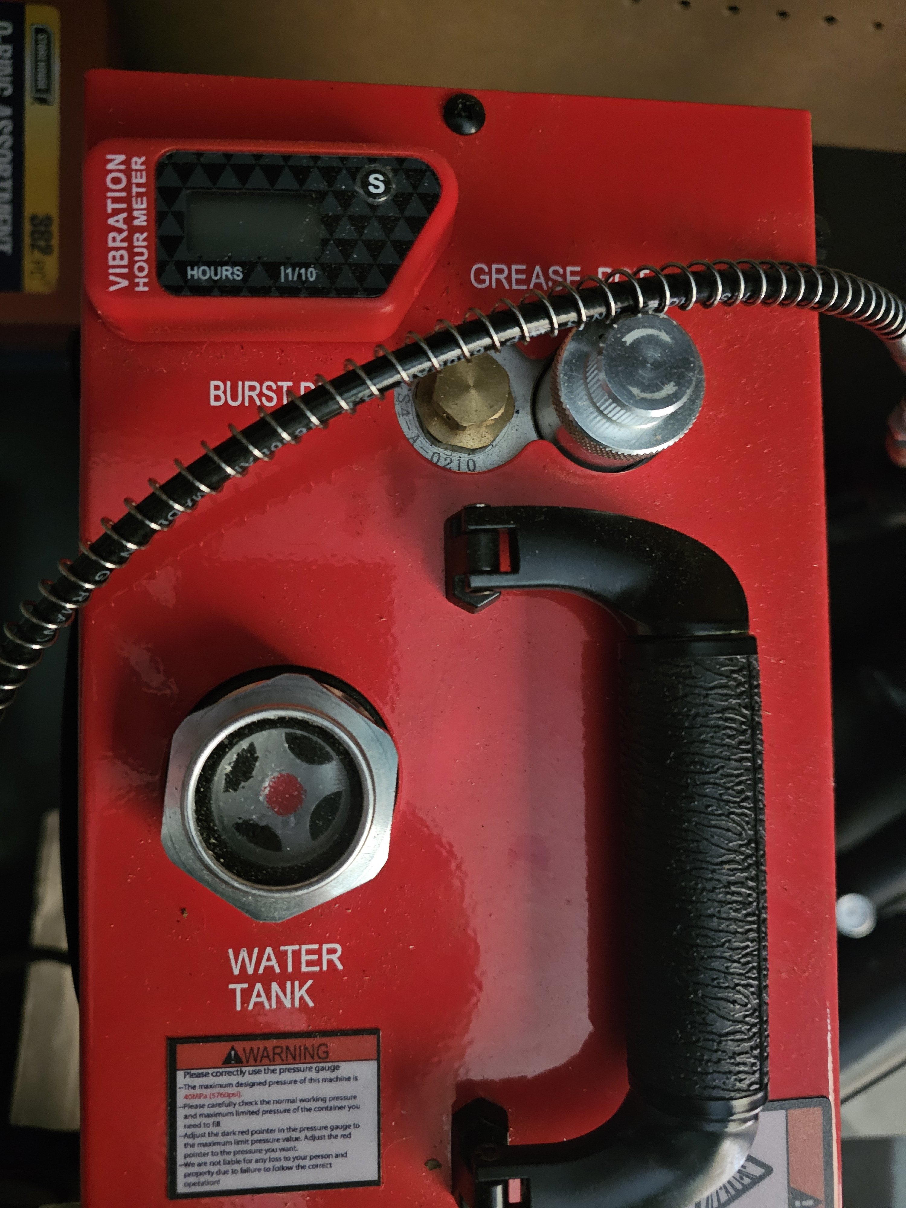

I just received mine and really like it. But it's so vibration free that it's not registering on the stick on vibration hour meter I've used on other compressors.
What are any of you using??
I had to get one with two sensitivity levels and set it to the higher setting. For me attaching it right where the GX stencil is to the right of the bleed screw worked, and a couple other areas I tried did not.I just received mine and really like it. But it's so vibration free that it's not registering on the stick on vibration hour meter I've used on other compressors.

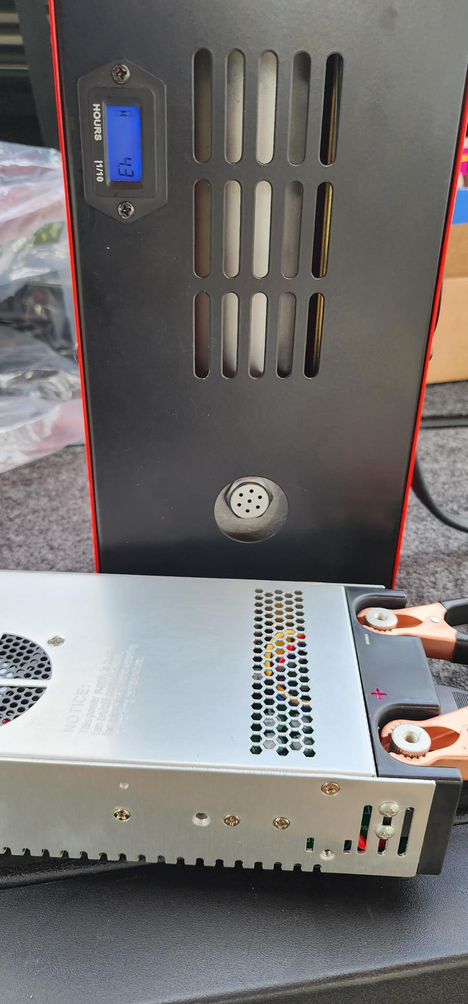

Did you have to connect some wires inside your compressor housing to the meter?I got this one: https://www.amazon.com/gp/product/B0C2XZ3SYV
Powers on and lights up with power switch, counts time when compressor starts.
But of course. 4 wires. Pos, Neg, Backlight, and Counter. Soldered them to the appropriate terminals on the main board.Did you have to connect some wires inside your compressor housing to the meter?
