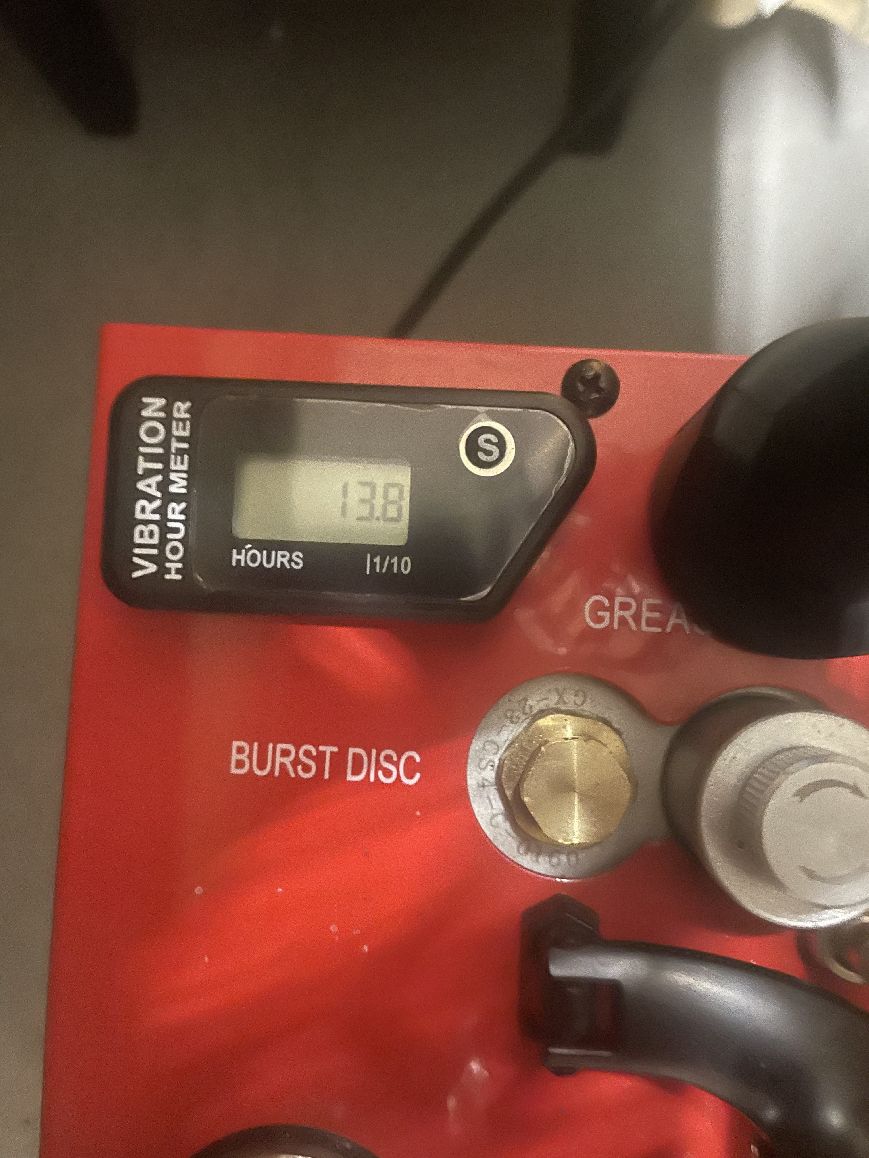

The hour meter on my compressor reads in tenths. Right now it reads 13.8
How do I convert this reading to hours and minutes?
Far as I'm aware, they all read in tenths.
It was new. Read .00 when I first installed it.Nope, 13.8 is, 13 hours 48 minutes. You may had got a used meter...
Maybe because it sure doesn’t have anywhere near 13 hours on it.A 1/10 hour meter is still .1 = 6 minutes. Everything to the left of the decimal is in hours. Is it installed correctly? Running the clock even when the compressor is not running?
Must be a bad meter…..no way that it has more than two hours totalEither that, or it's defective. What meter do you have.
