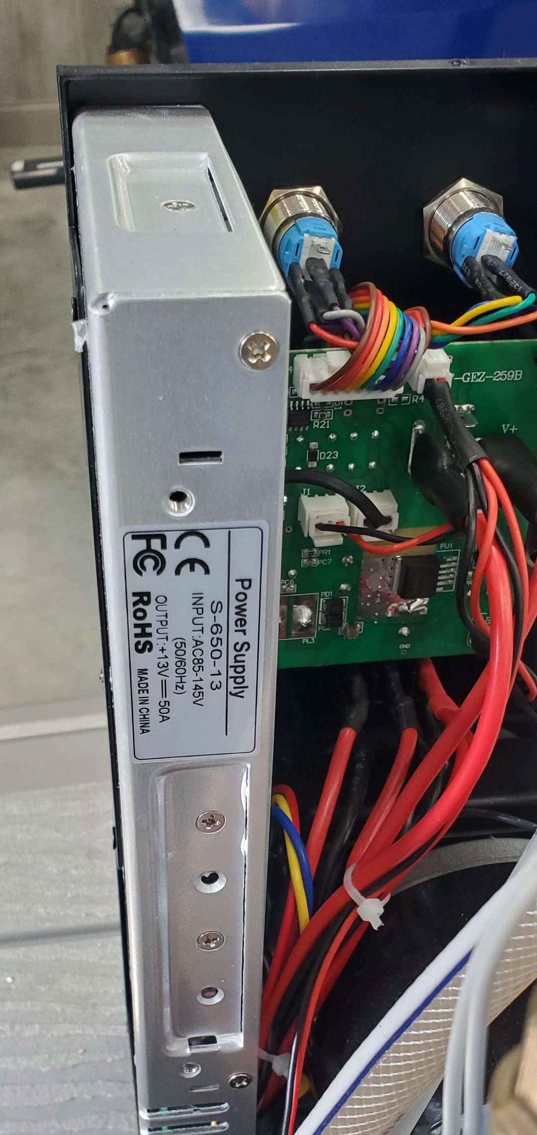

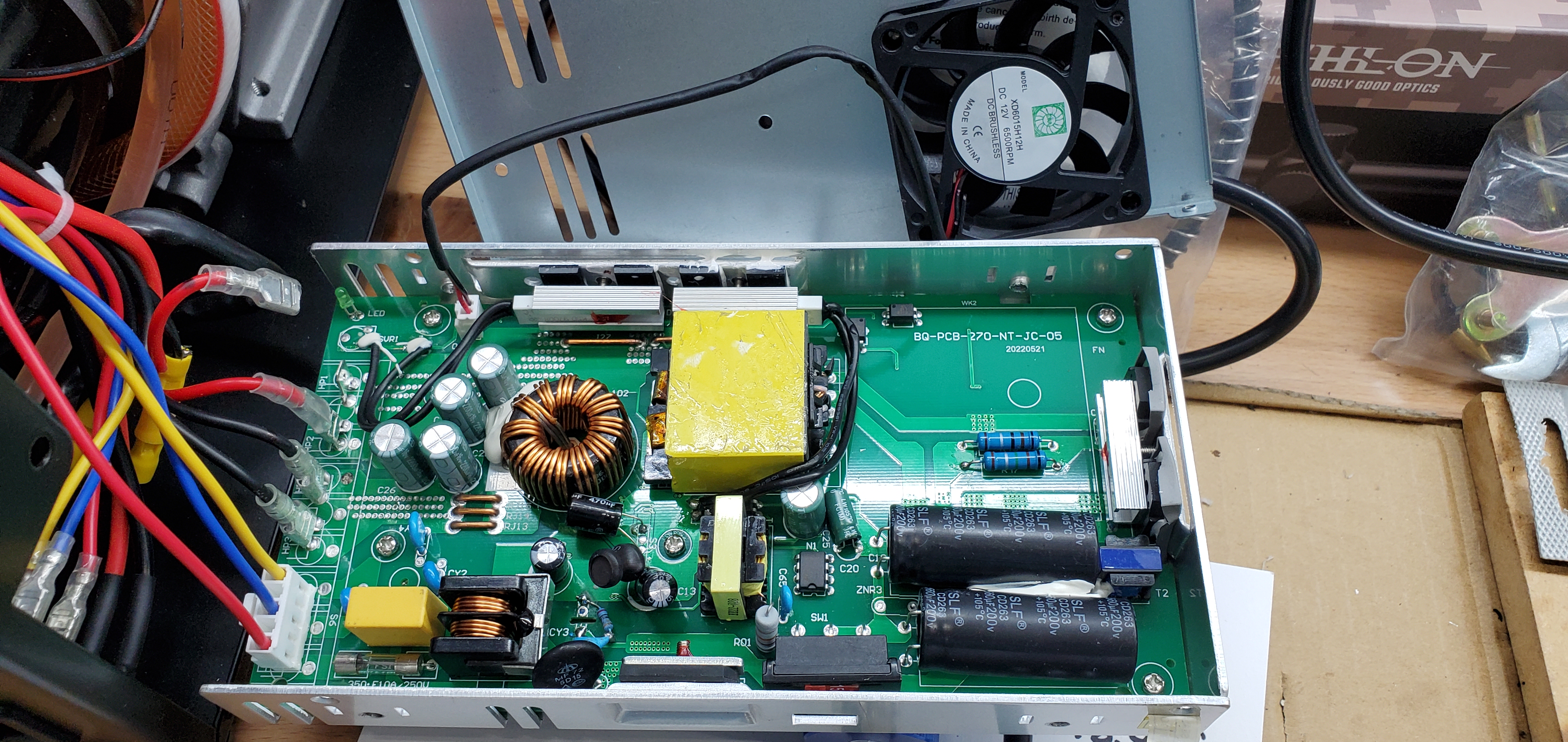

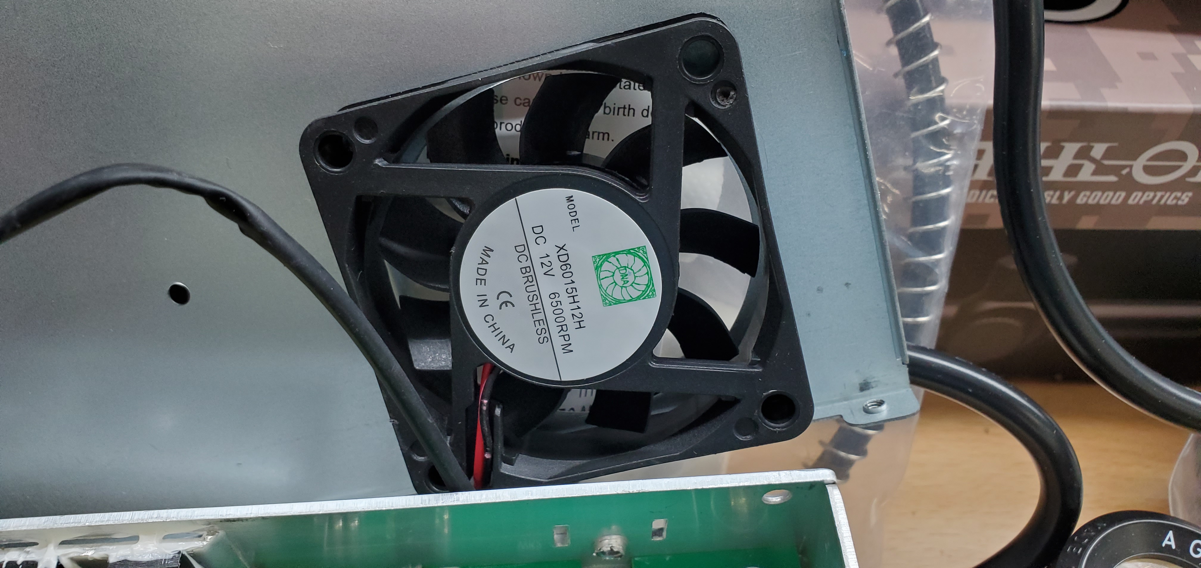

Here's the power supply fan. Keep in mind this is the CS4-I with the integrated power supply. So I think it's a bit different design. I've got the power supply cracked open and am going to test the fan and power to it here in a bit.

Oh, okay, I wasn't aware they had one with an internal power supply. I will say that on the external power supply that came with mine, the fan runs constantly. I have it mounted under my work bench and just connect the DC connectors to it when using it at home, then disconect the power supply if I need to use it in the field from the car battery. Does the fan run if you connect it direct to a 12V DC source?
Is that with the compressor connected to 12V DC or did you disconnect the fan from the circuit bord and test it to see if it ran on 12V DC direct? Alsi check the voltage where the fam plugs onto the circuit board to see if you are getting 12V DC to the connector. That would help isolate the problem to either the fan being bad or a problem with the circuit board. Once you isolate the problem, contact GX Pums and have them send you a replacement part.
