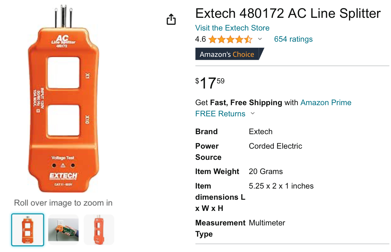

Why use a splitter vs just clamping the wire itself? To isolate each leg?
Here’s an ExTech. has a leg for X1 and X10 for very low amp draw devices.
Before these were available I had a male and female plug strictly for amp testing where between the two plugs it was the insulated hot and insulated neutral so that I could clamp on one of the wires. The wires between the plugs were long enough so I could double loop one of them for the clamp on to get a X2 reading for low amp draw devices. Very inexpensive. Probably not OSHA or some other alphabet organization approved.
