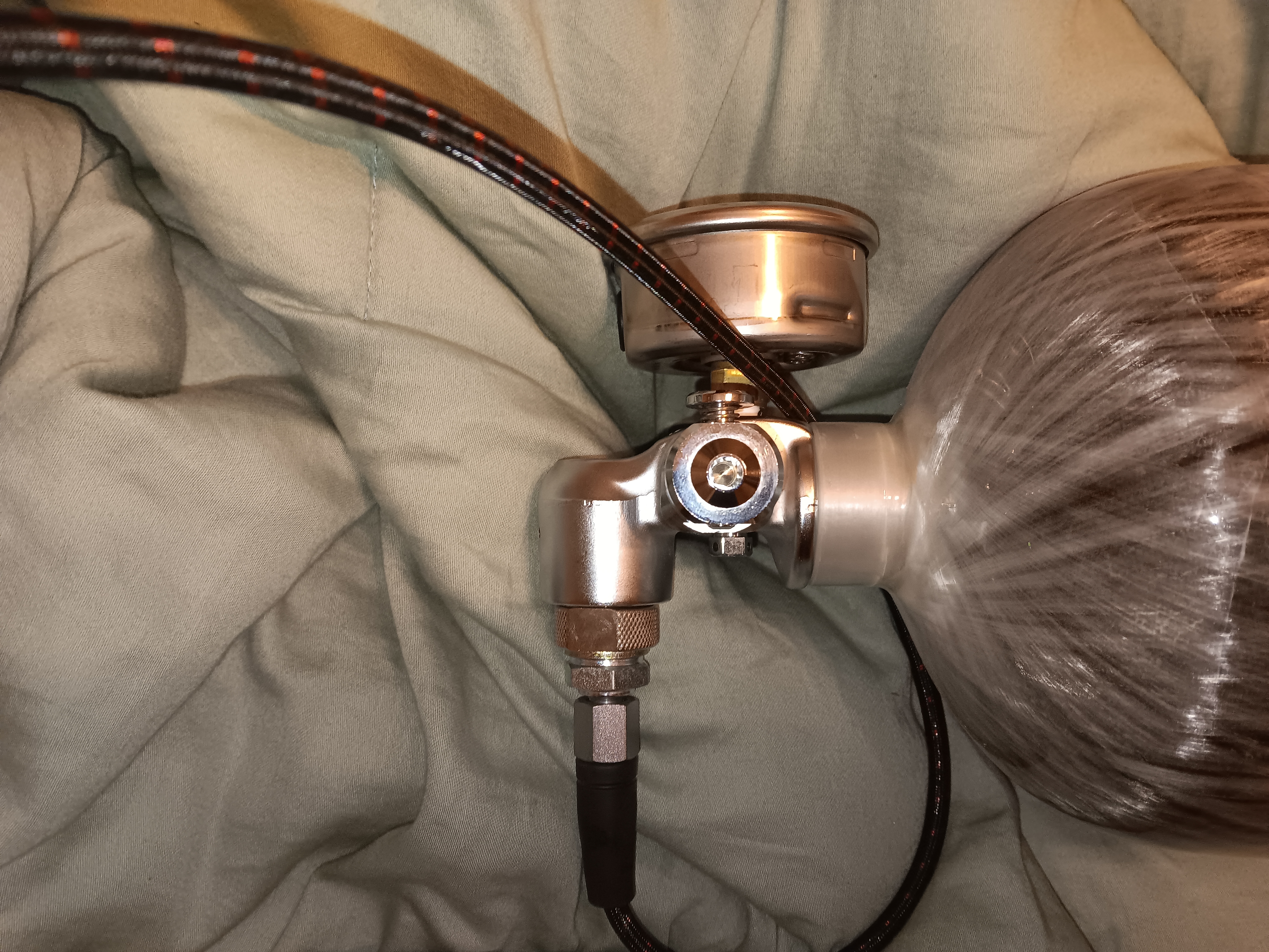

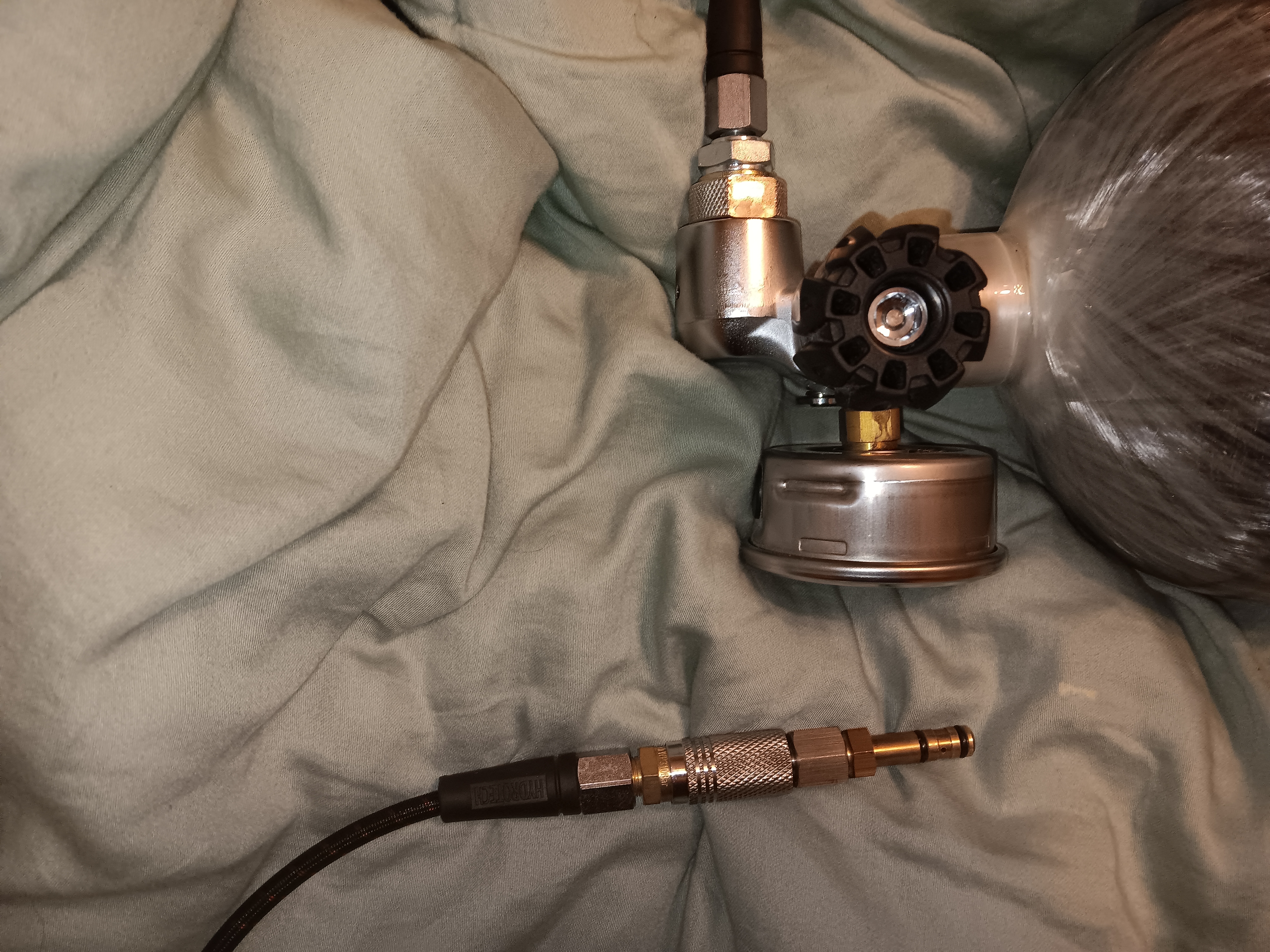

Your photos don’t show it clearly, but does your tank valve have a bleeder on it? I don’t see one. If it doesn’t have a bleeder and your fill line doesn’t have one you will not be able to remove your probe without blowing out an O ring and a bit of force. Safety glasses would be recommended.
Show us some pictures of your compressor and fill set up.
I have two 74 cubic foot omega tanks. His appears to be like the one that has a push button bleed. I personally like to screw type better. In the first and third picture you can see the button behind the gauge.
Ahhh, OK, I wasn’t familiar with that valve set up. I have heard negative comments about the push button. The Edgun filler gun seems to be a preferred way but is a bit pricey.
Thanks for setting me straight.

Generally the bleed on the tank is just to remove air from the line when you're feeling a gun or smaller bottle.
I used to bleed valve on the air compressor to rid the system of moisture and air so I can disconnect things. Just make sure your bottle valve is closed when you do this else you're going to lose all your air.
Yeah the push button seems to work fine and dandy. I'm an old fart, hands are pretty much worn out from working with them all my life. Sometimes it's hard and even hurts to push that button. Especially if you just filled something to 300 bar. Either way I like to twisting out better.
