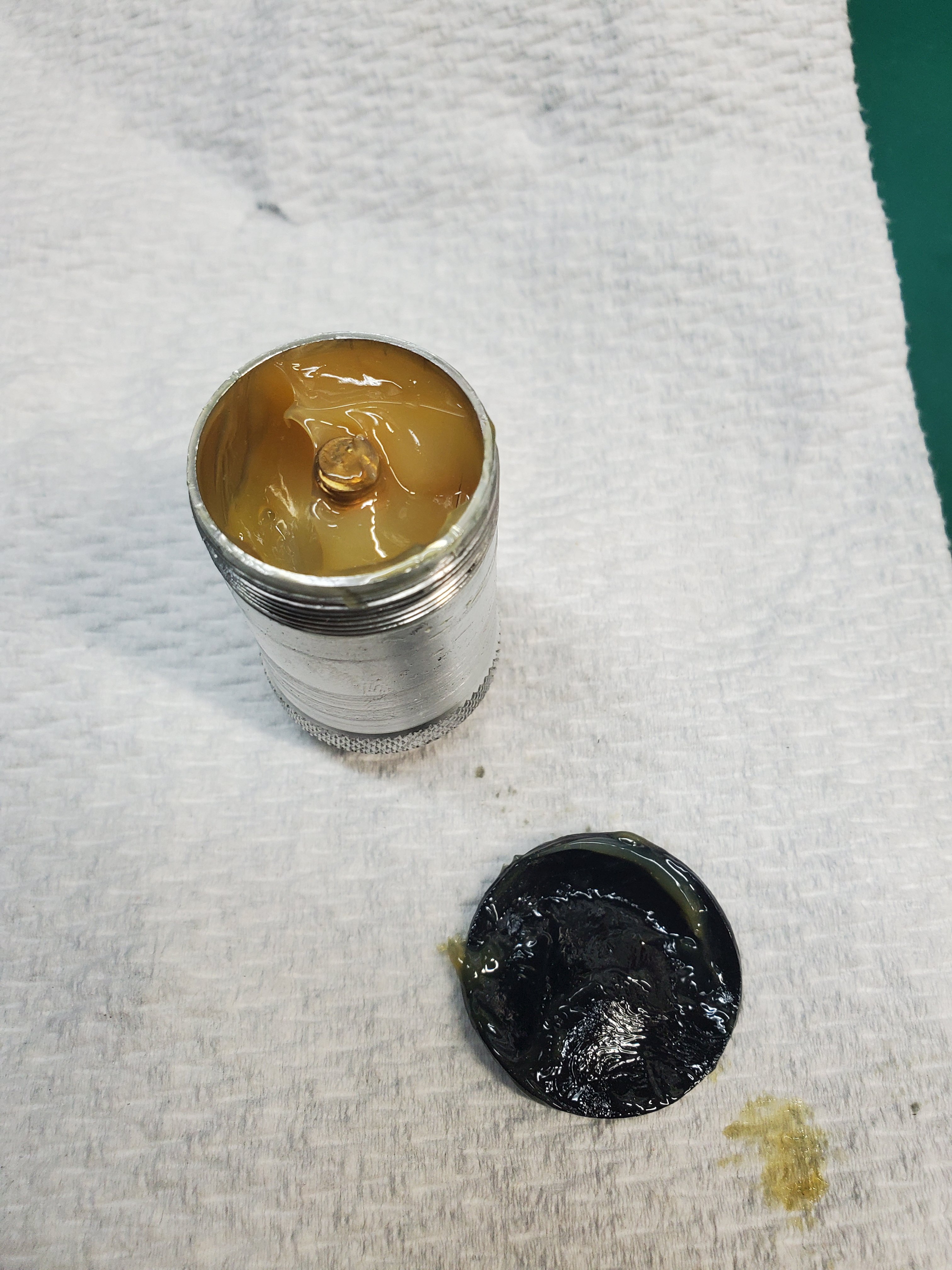

Thank you for the detailed diagrams. One other question: There's a thin rubber disc the width or slightly larger than the grease pit in the grease pit of the CS4. If it's supposed to be there, how is it positioned? I ask because I don't see it on the diagram and I bought the compressor used.![]()

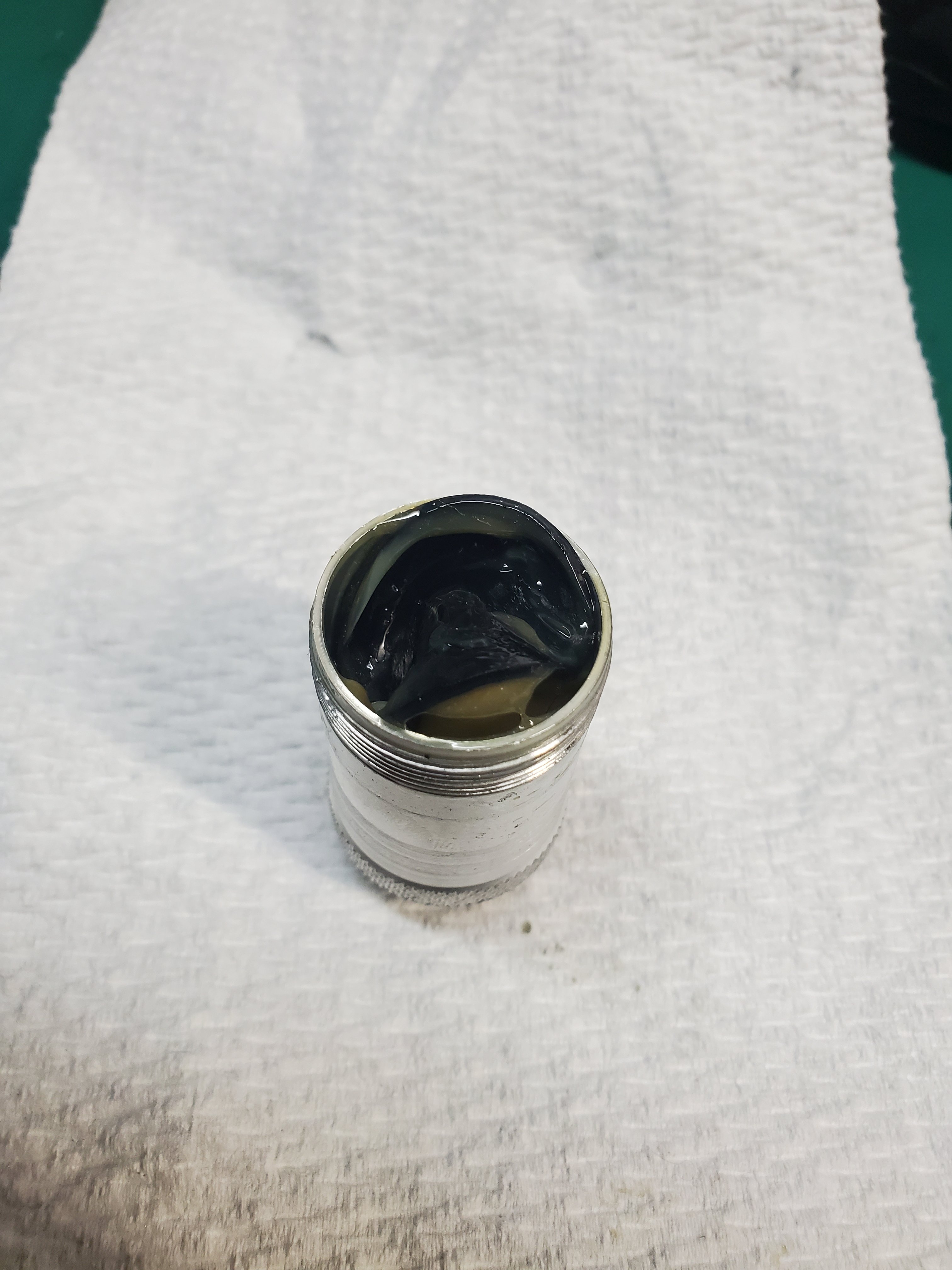

Thank you! I thought it might be something they put in there to block any grease from getting into the piston during transportation.It goes in the bottom of the grease well that is attached to the compressor. The grease should be added on top of it. Mine was wrapped also, I just cleaned all the grease out and placed it as flat as possible before adding more grease.
