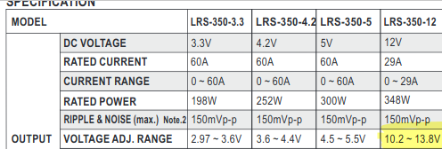

Mean Well is a reputable, lower-cost brand. This model will work fine, especially for <$40:
https://www.mouser.com/ProductDetail/MEAN-WELL/LRS-350-12?qs=ah3jBNVE1PRuo5/c9niR6A==
https://www.amazon.com/MEAN-WELL-LRS-350-12-Single-Switchable/dp/B0109IMRPS/
You'll note below that this model's output voltage can be adjusted to your needs.

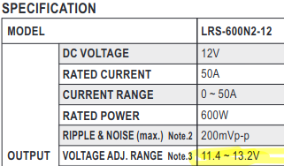

Thank you for the brand recommendation! The supply you listed was only rated for 29A and 350W vs 50Amp and 650W for the supplied one. Is that going to be enough power To run the pump? Everything seems to have a huge fudge factor with these components
Sorry, I didn't think it actually required that much. I've measured mine at home, but now I forget how much it actually used. This model should be plenty, and is $68. The voltage adjustment range is a little smaller, but still fine. Mouser is a good place to order from, with fast & reasonable shipping. A quick glance didn't show this on Amazon, but it may be there as well.
https://www.mouser.com/ProductDetail/MEAN-WELL/LRS-600N2-12?qs=HoCaDK9Nz5fh2VnLGDfmZQ==
Reactions: RoflRofl
600 watts divided by 12 = 54.16666...... I would go0 a step bigger. Shortages in amperage causes overheating. But that's just me. YMMV * Notice the Variable in Voltage. 11.4 -13.2
