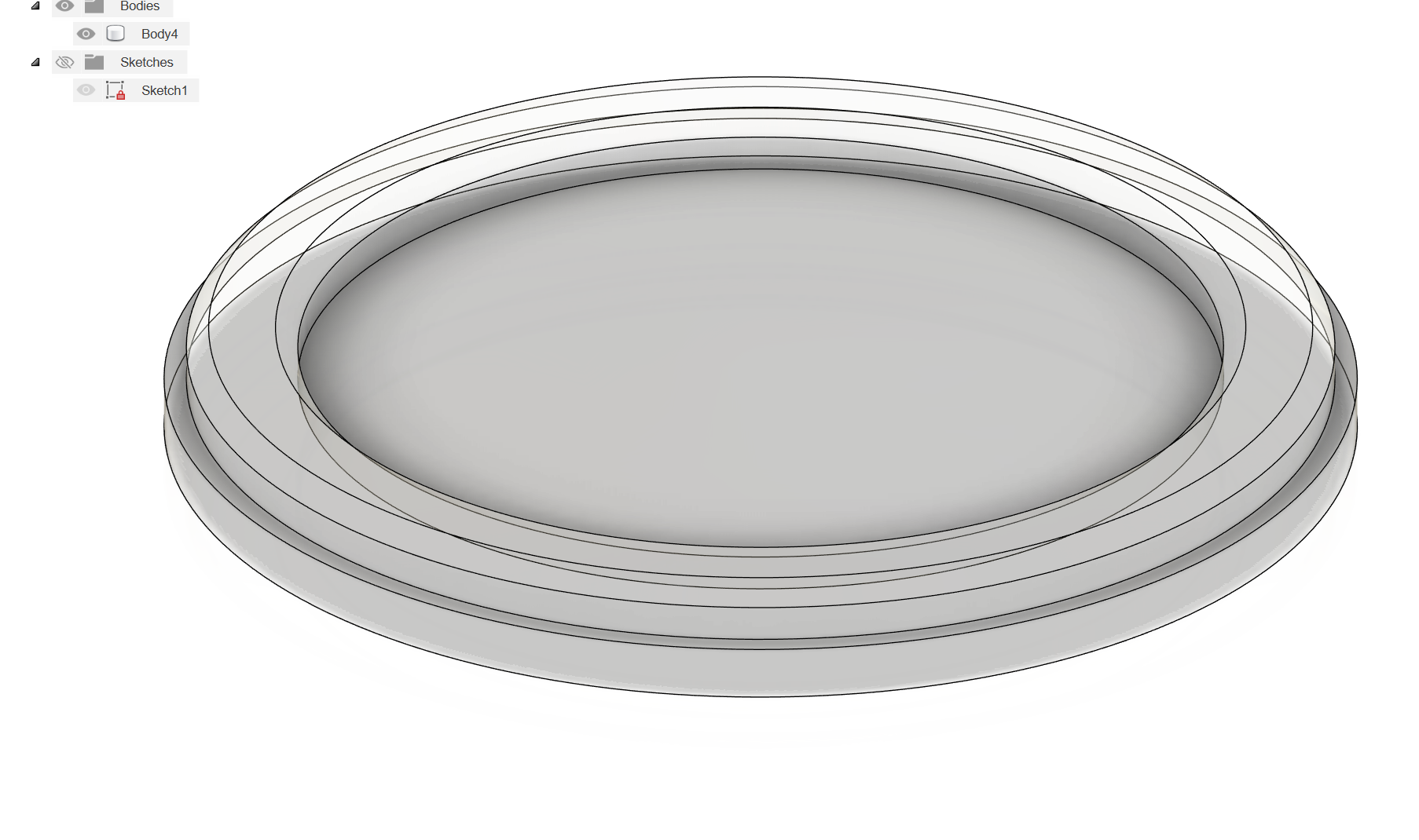

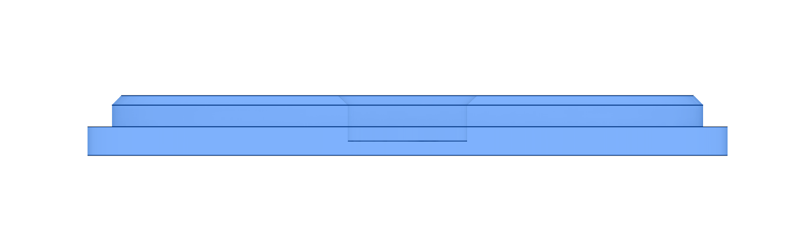

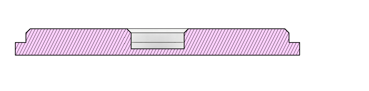

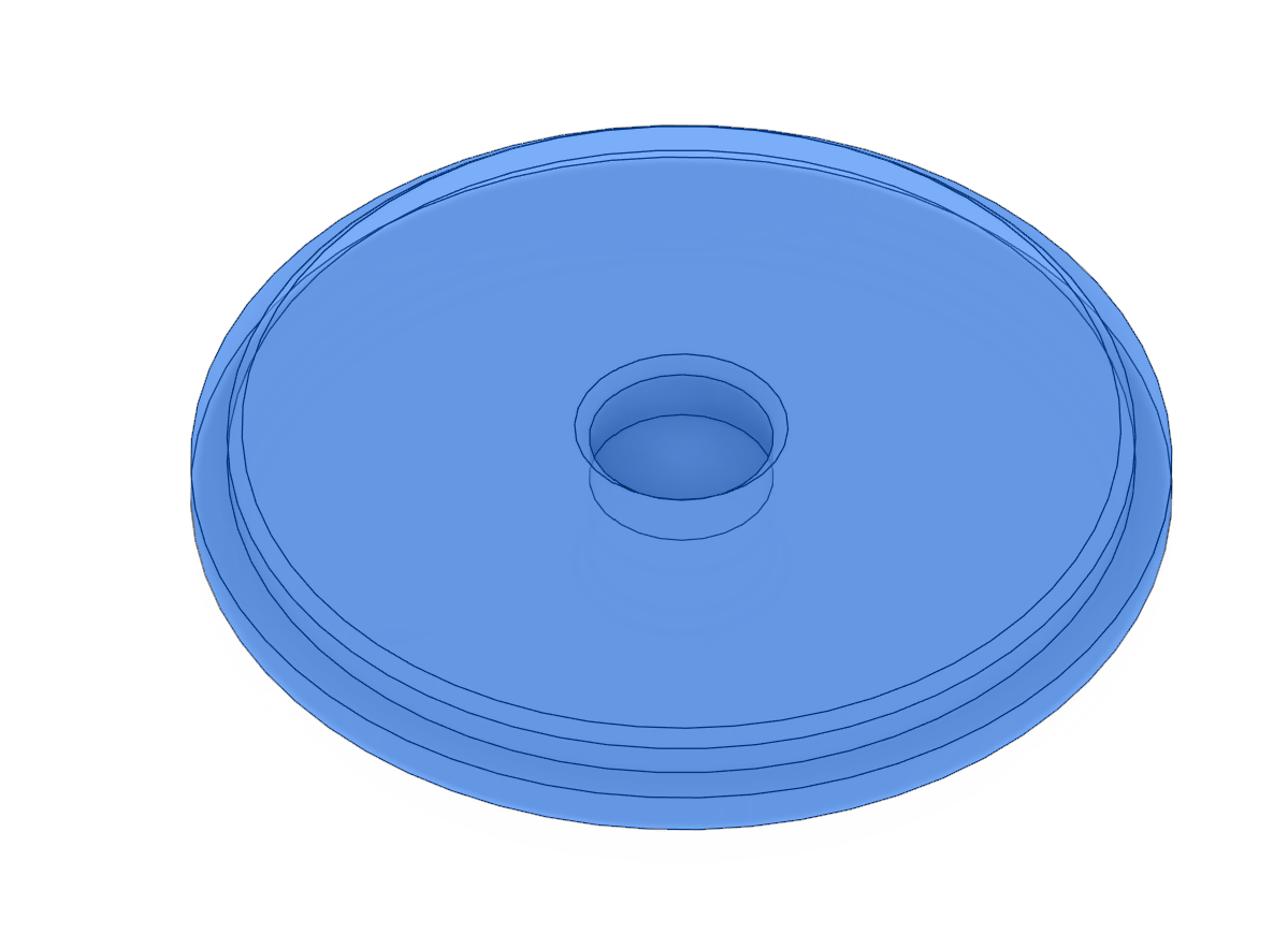

IMO you shouldn't over tighten the grease pot or it may damage the rubber diaphragm. I was careful then I removed the pot, adjust the grease level and reinstalled the pot. I only tighten it until I felt the pot hit the diaphragm. But later I forgot and turned the pot's body down until it reached a hard stop. When I inspected the diaphragm it was stretched out of shape and was no longer flat. Since I have a 3d printer I will print a replace it with a printed TPU diaphragm with a modified shape. It will have an raise inner ring to help diaphragm keep it's shape. The ring sits inside the body of the pot. A small downside is you cannot use that last bit of grease. NBD.
