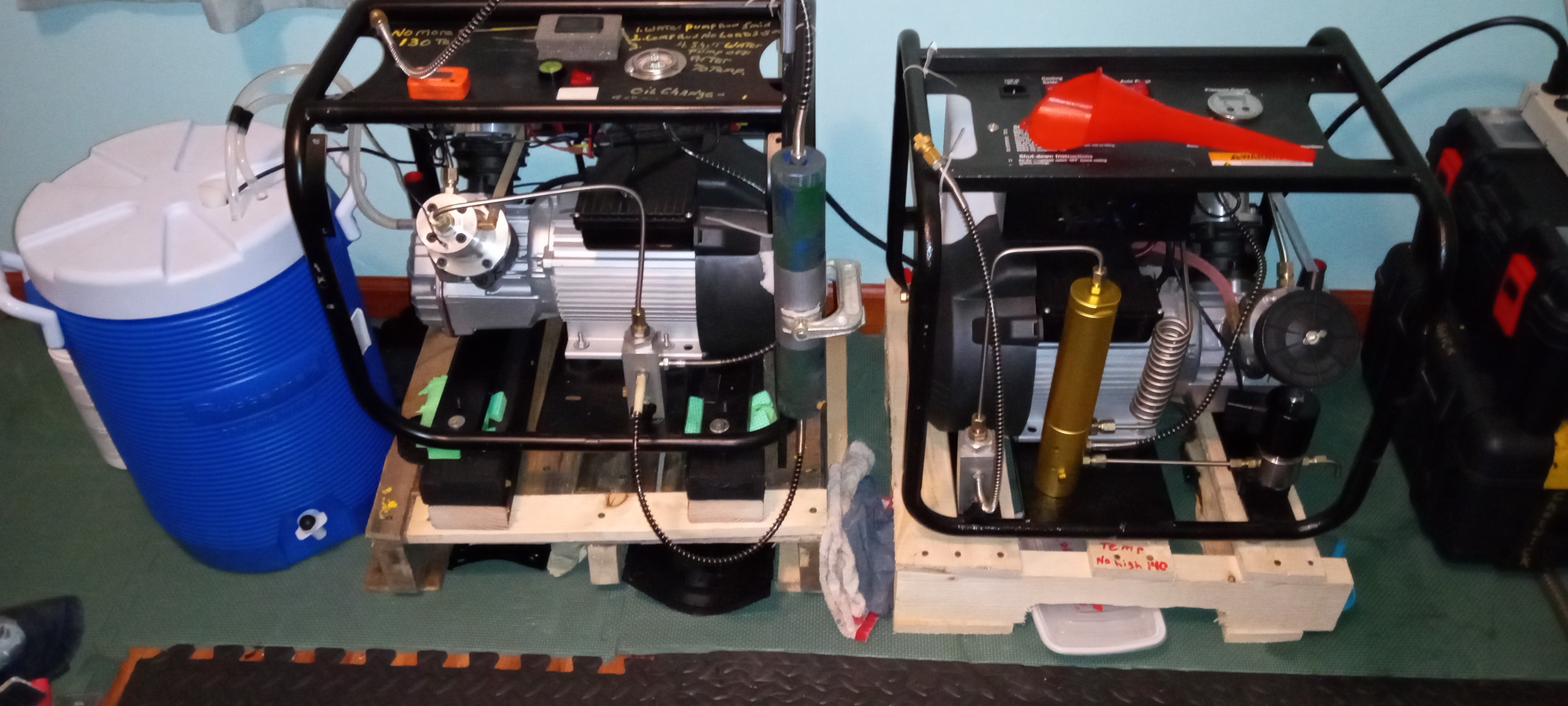

ANY of the sealed units are for filling small bottles and not large tanks, yes it will do so but shortens the life of the unit. I have 2 Tuxing compressors and yes, I have had my bouts with the company but, I'm over it,lol for the money there hard to beat. the one the left I have had for 3 years and have filled my 6.8-liter tank 100's of times at least. i just put a rebuild kit in it last fall and it's still going Strong! I keep the oil fresh and in the cooler, I use 3-4gal water and frozen blocks of ice to keep the temp down, 130 temp. Heat and oil break down are the number 1 killer of high-pressure compressors.
