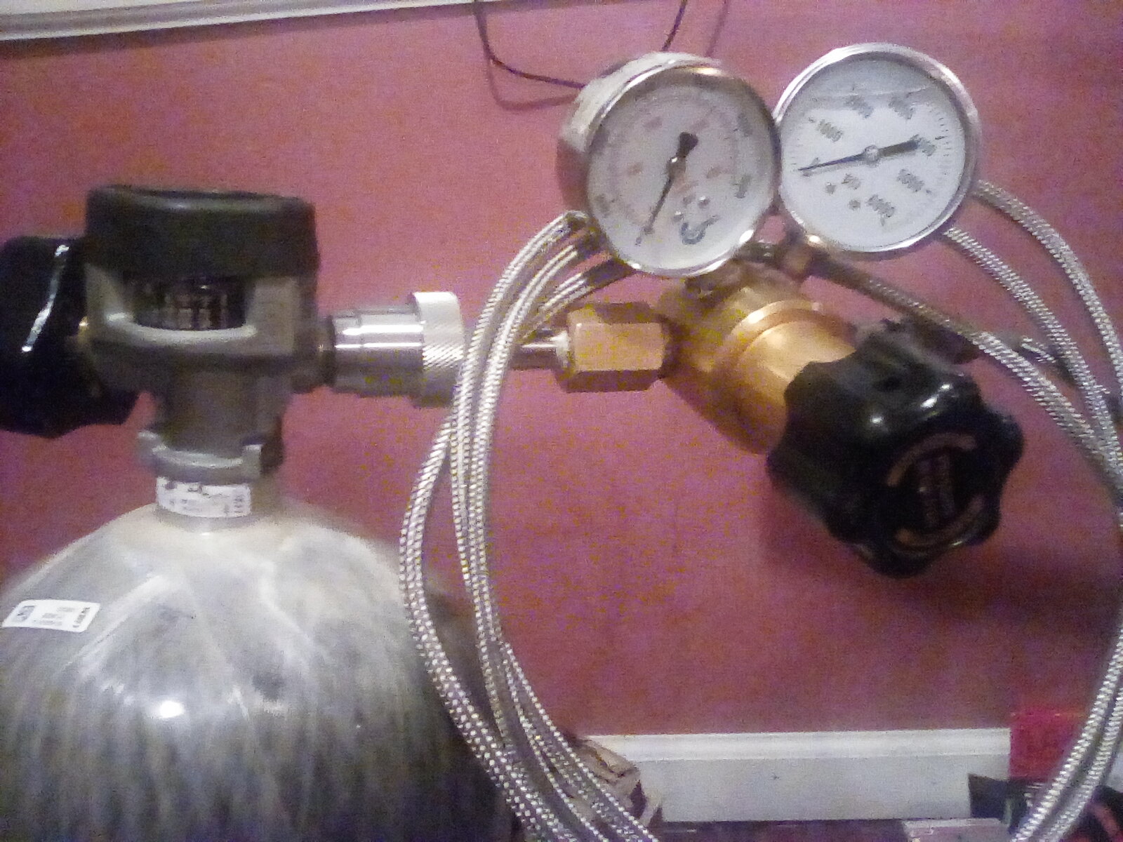

Hey guy do you think a Cs-4 will work for me to top off the biggest SCBA tank made Scott 5.5 I forget like 90 min or something... I have a aqua environmental external regulator to 6000 psi for my big bore...I've put 7 pistons in my yong heng in 3 years...I realize the cs-4 isn't the biggest fastest unit...I'm comfortable using my yong heng to fill.the big Scott to 300 bar...pretty fast 10 min....Then hook up the cs4 and finish filling. To 5500 psi... I guess buy new from GX official site $509.00 or something... Any input.... Not many options for filling 5500 psi Scott 5.5 tanks....
Your plan sounds like it should work, but for how long, who knows. It's rated for it. If it was me, I would give it a few breaks from 300 to 380 bar.
Theoretically you COULD, but I wouldn't recommend it, and I certainly wouldn't do it until I talked to Jason if I had my mind set on trying it. 5800 psi / 400 bar is the MAX pressure, not the working pressure. You'd have to replace the burst disc for one thing.

They sell 400 bar burst disk...They advertise 5800 psi? My tanks designed for 5500 psi fills....Regulator fittings and good to 6000 psi... If it won't fill 5500 psi tanks.it shouldn't be advertised as 5800 psi... The new industry standard for scba tanks is 5500 psi...The fireman have been using Scott 5.5 tanks and aqua environmental regulators...The 5.5 tanks are more expensive. Than the 4500 psi ones most people have...

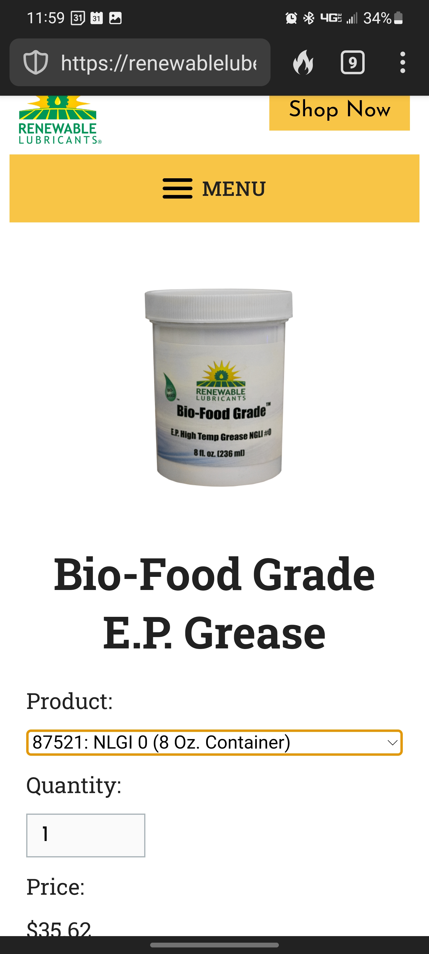

What kind and or brand of grease are you fellows putting in your grease pot? I've read somewhere it's "food grade" but have no idea why.
It's $15.00 plus shipping for 5 400 bar burst disks from their website. A little pricey but if it works right?

Anything that is food safe is safe for your compressor. Do NOT use petroleum-based grease.
