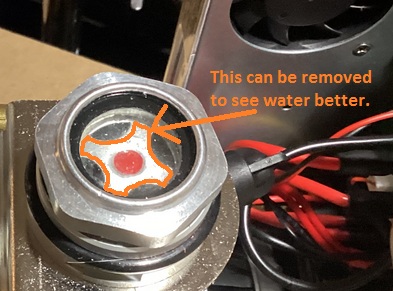

The external power supply has little rubber feet on it. I read somewhere that a guy got his hot but turns out he was laying it on carpet while using the compressor. Long as your laying it on a flat level hard surface it should be fine. As far as knowing if your water pump is working or not, you can remove the crazy looking 4 legged plug with the little read dot in the middle from inside the water tank cap. It's just pressed in from the underside. You can twist and pull it out with pliers. I did this along with installed 6 LED lights in some 3D printed brackets that snap over the lower water line underneath the tank. Now I can look down through the top of the tank and "SEE" the water flowing back into the tank through the return line.

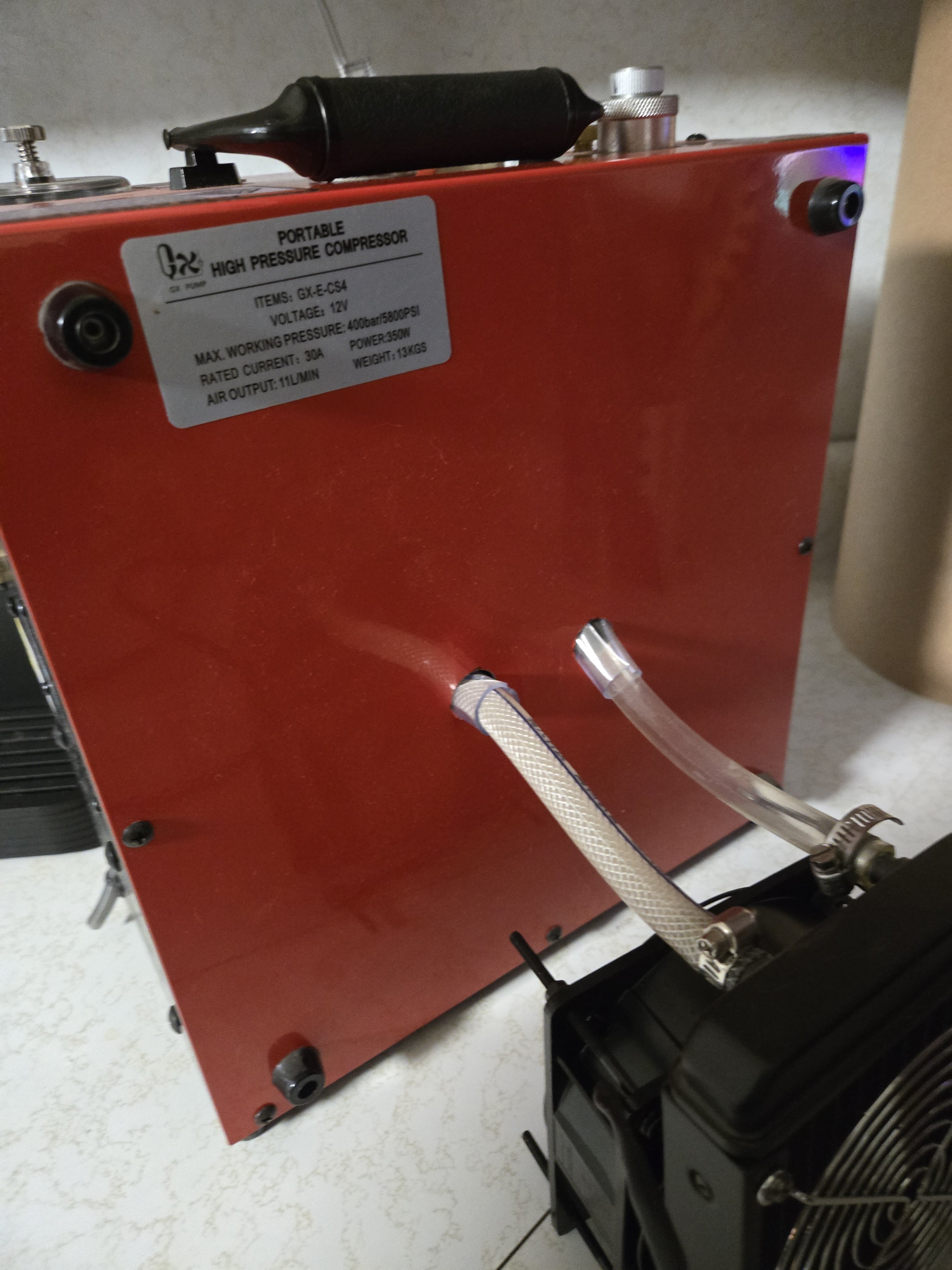

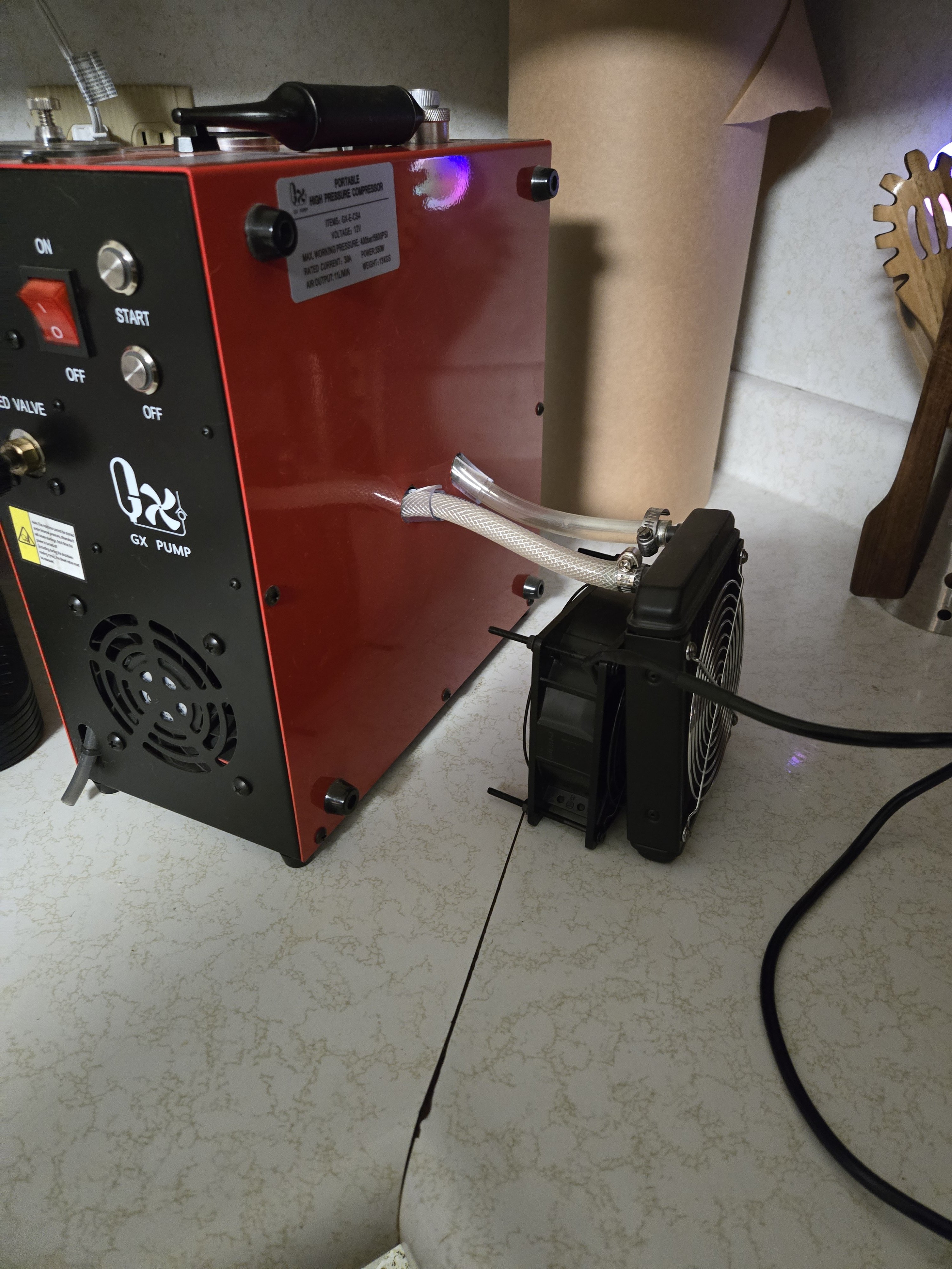

Mine was getting 155°- 158°f after about an hour of running. I have the worse luck with things. I have since added an external computer radiator with a pancake fan. Not pretty, but barely gets over 85°f filling 30 minute 4500 psi scba bottles from 0.
yes please show how you have it mounted,

It works. I move it from the shelf it lives on to the counter where I fill my bottles, so it doesn't get moved a lot. You could get some 90°s and put it in front of the unit. Then use the built-in fan. Probably work just as well.
I read all the reviews and was encouraged by the duty cycle and how cool everyone said/says they run. As my luck would have it, mine never over heated but ran right at the threshold. For another $25 in parts from Amazon, I feel a little better chance of longevity. I did get warranty but don't want to have to deal with it.

Question , is that a little radiator you can buy ?

Question , is that a little radiator you can buy?
Yes
