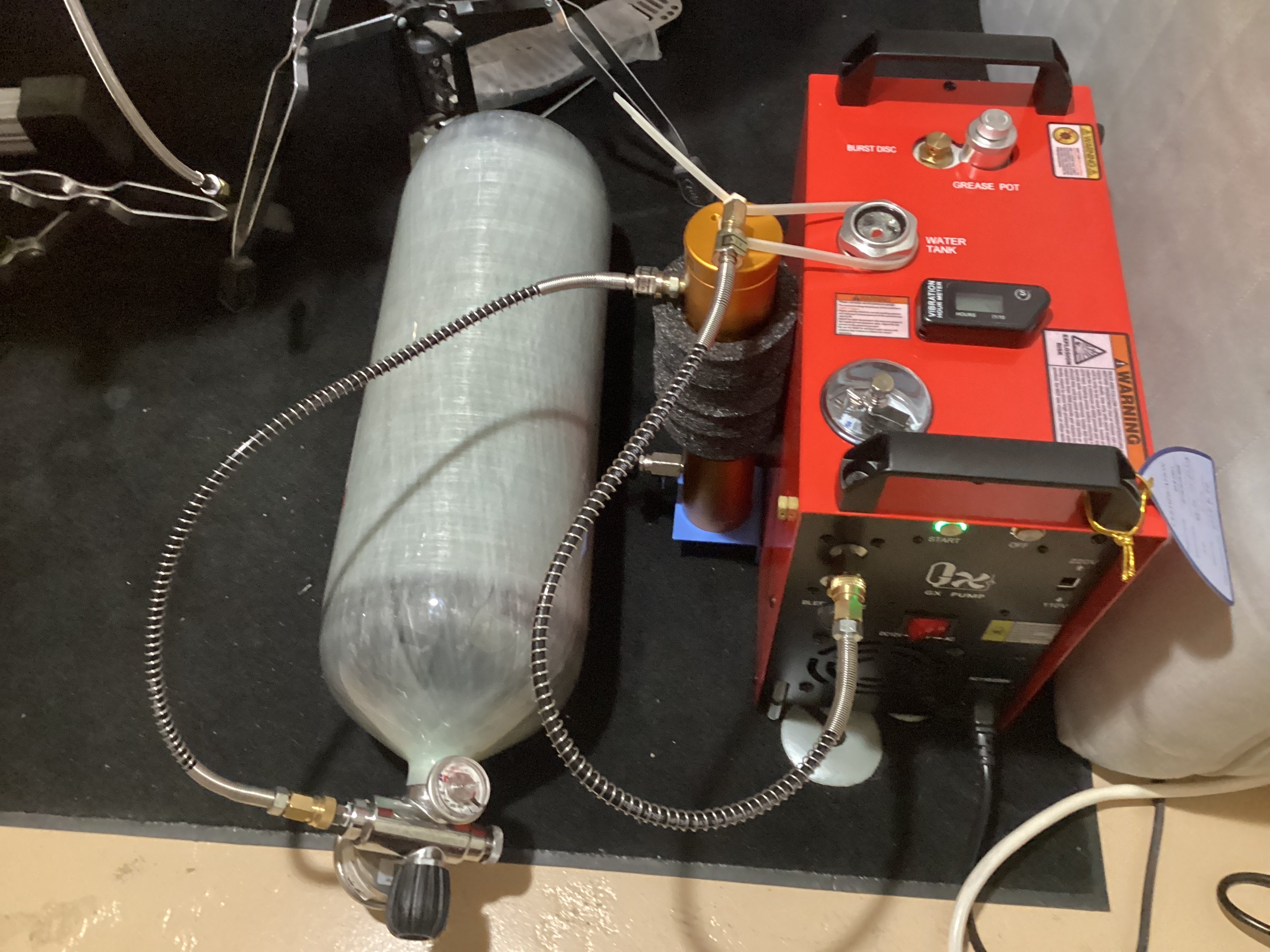

Just received from FedEx . Installed valve and trying first fill from dead empty.
will it make it ? Betting windows are open.
Curious as to why you put the pellet sleeves around the filter.Just received from FedEx . Installed valve and trying first fill from dead empty.
The pellet sleeves were part of the temporary cob job to attach filter. I didn’t want to drill into the new compressor so one existing screw ( although larger) in bottom mount , foam for space between the two, and a zip tie holding it all togetherCurious as to why you put the pellet sleeves around the filter.
Are you planning on filling that tank in one go from empty? If so, no lol, but I'd like to be proved wrong.
Different kinds of compressors. This has been running for two hours and ten minutes. Luke warm water. Manufacturer states a five hour run time.I would elevate that tank and give plenty of breaks.
Hi Matt, I have the 042 coming. Why? It was cheap. I been thinking about filling tank as far as possible till it gets hot for it’s speed then letting the Gx take over and mosey along to finishI know my Tuxing TXEDMO42 would overheat if I ran it long enough to fill my 9L tank.
-- Matt
I amI have a GX CS4, I know they claim 5 hours continuous, but in not willing to push it that hard. 1 hour for me is good. Just my .5 cents.

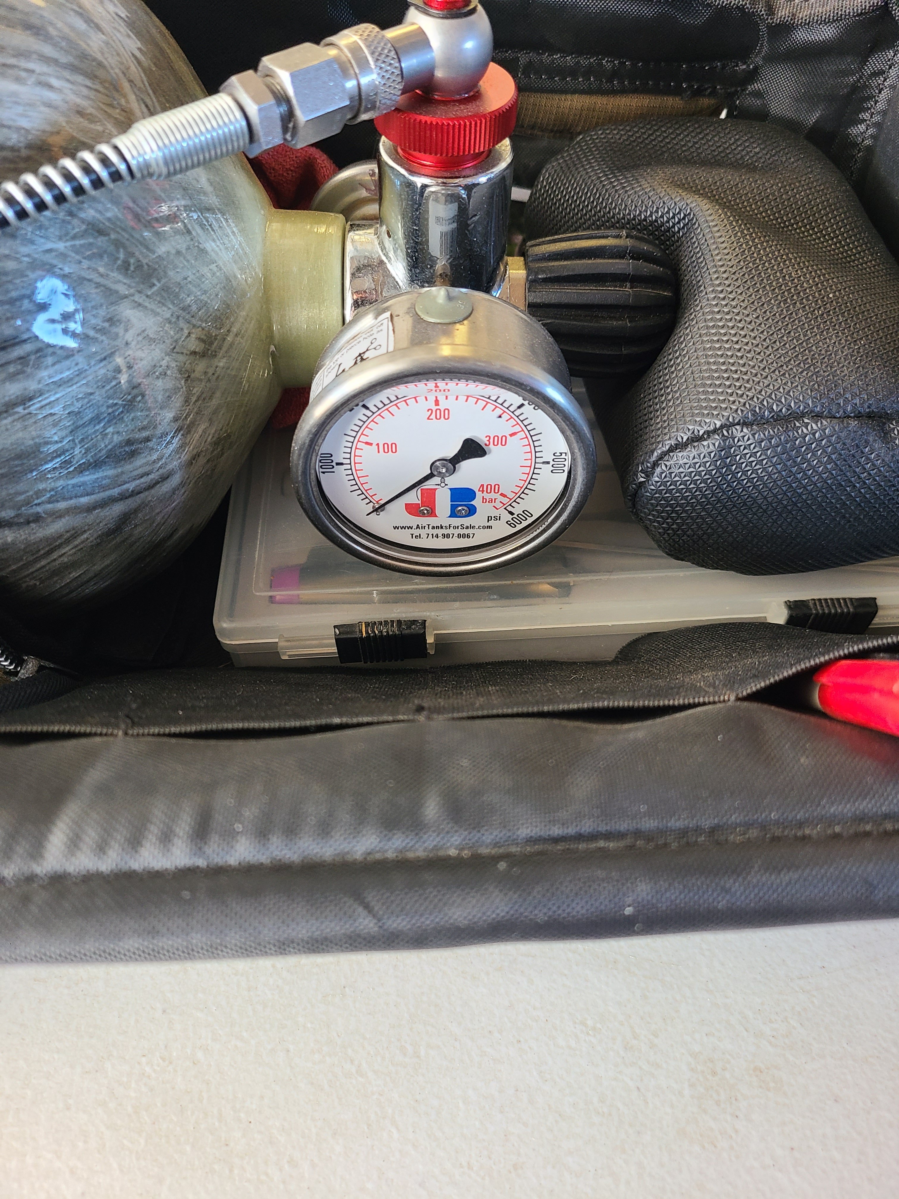

good to know, but it’s what I gotOil filled gauges on a bottle is pointless. Their designed to damper vibrations on equipment. So marketing baloney on this. They also need the pressure to be released from time to time with the plug and that plug should be upright.
Was it supposed to have that grey plug ? Do you have to keep the hole pointing up ?Same here. That's pretty much how they are offered. If I was to replace it, I will go non filled.
