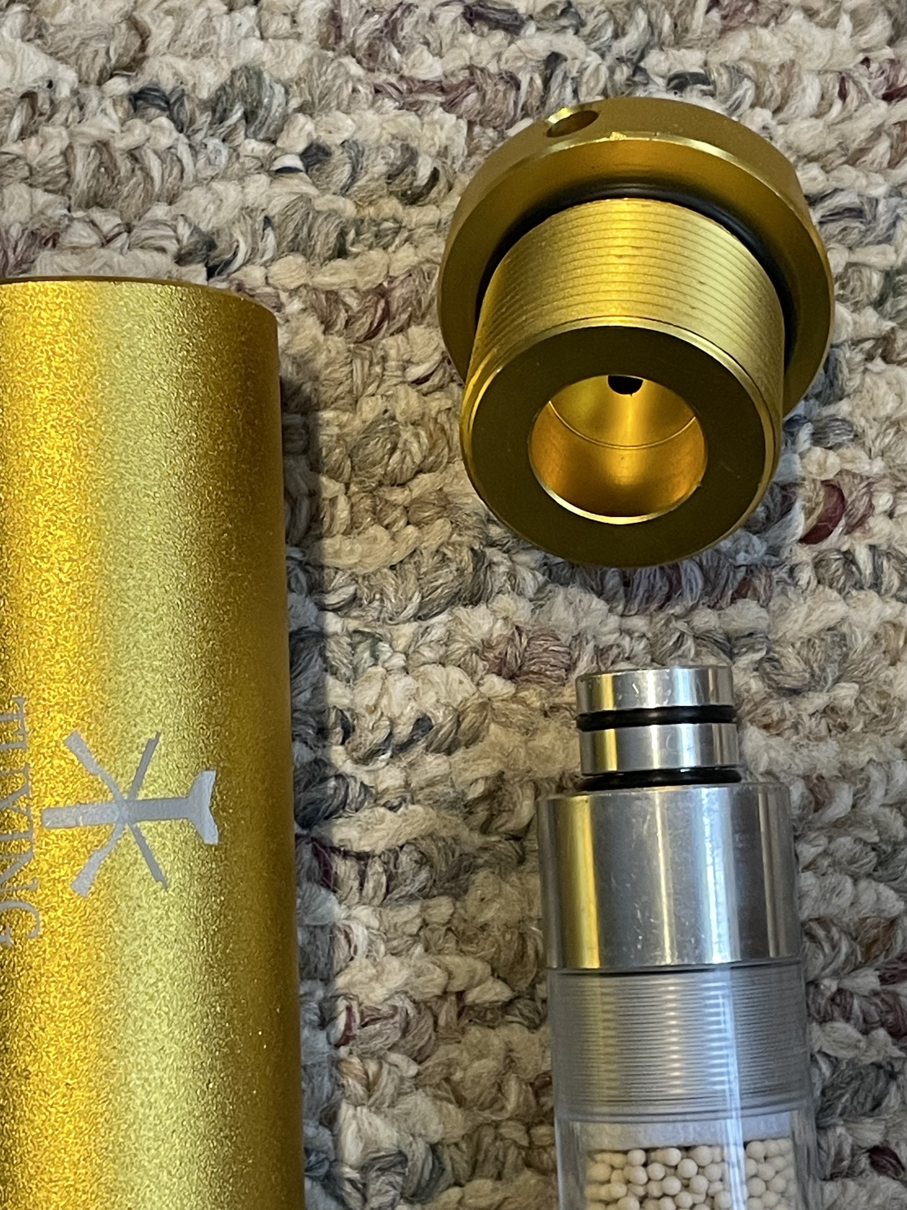

Seeking your expertise and adding more info to this thread:
Setup of my Tuxing:
I set up my Tuxing gold as shown in the picture - with the end with the two internal o-rings on the top. I did this because it seemed the other screw on cap end was more "empty" and would serve as a "moisture collector" - if any accumulated.
So, my male disconnect is on the top and my female disconnect is on the bottom.
I can swap it around if you are sure that the end with the o-rings should be on the bottom - please let me know your thoughts...

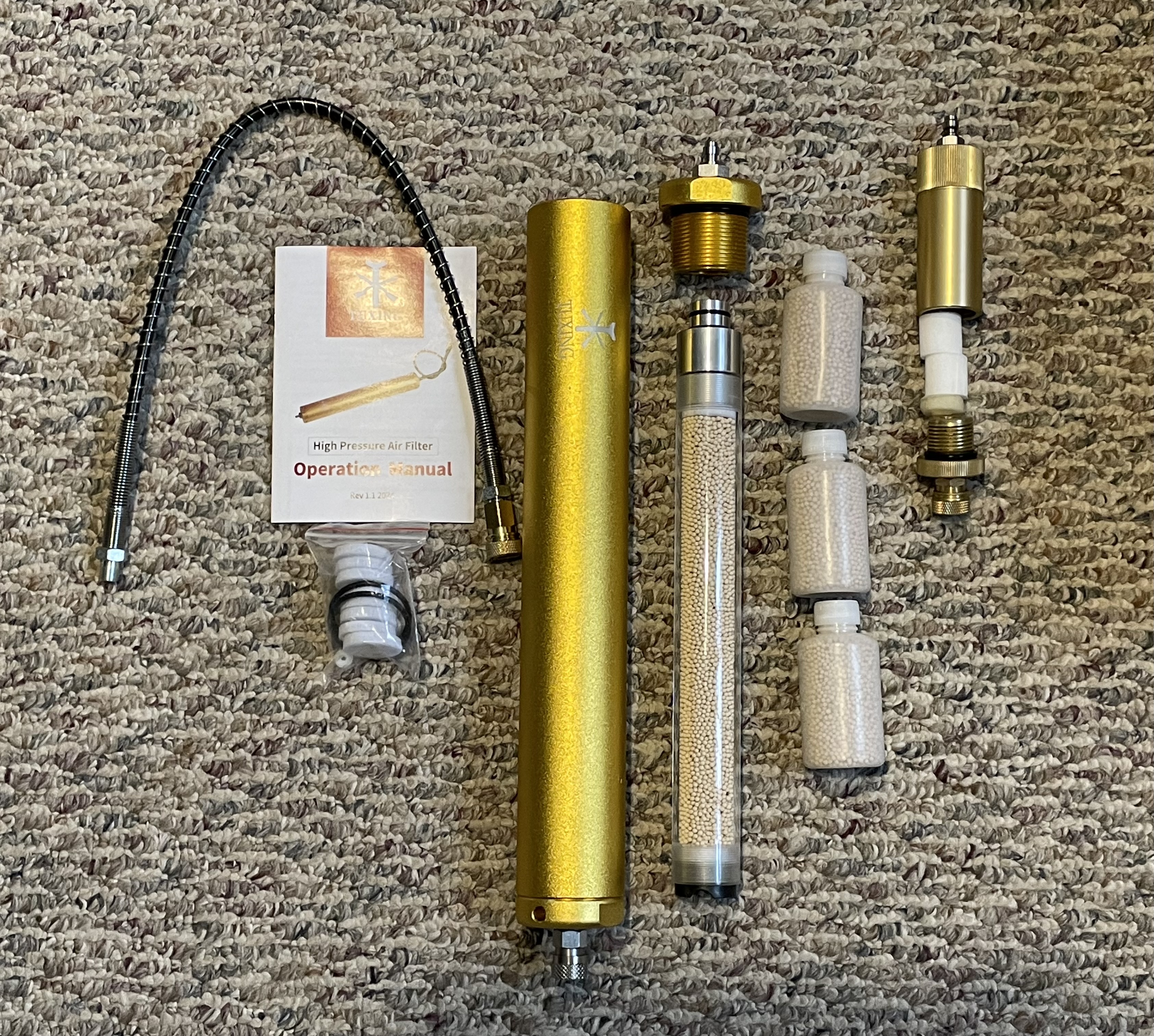

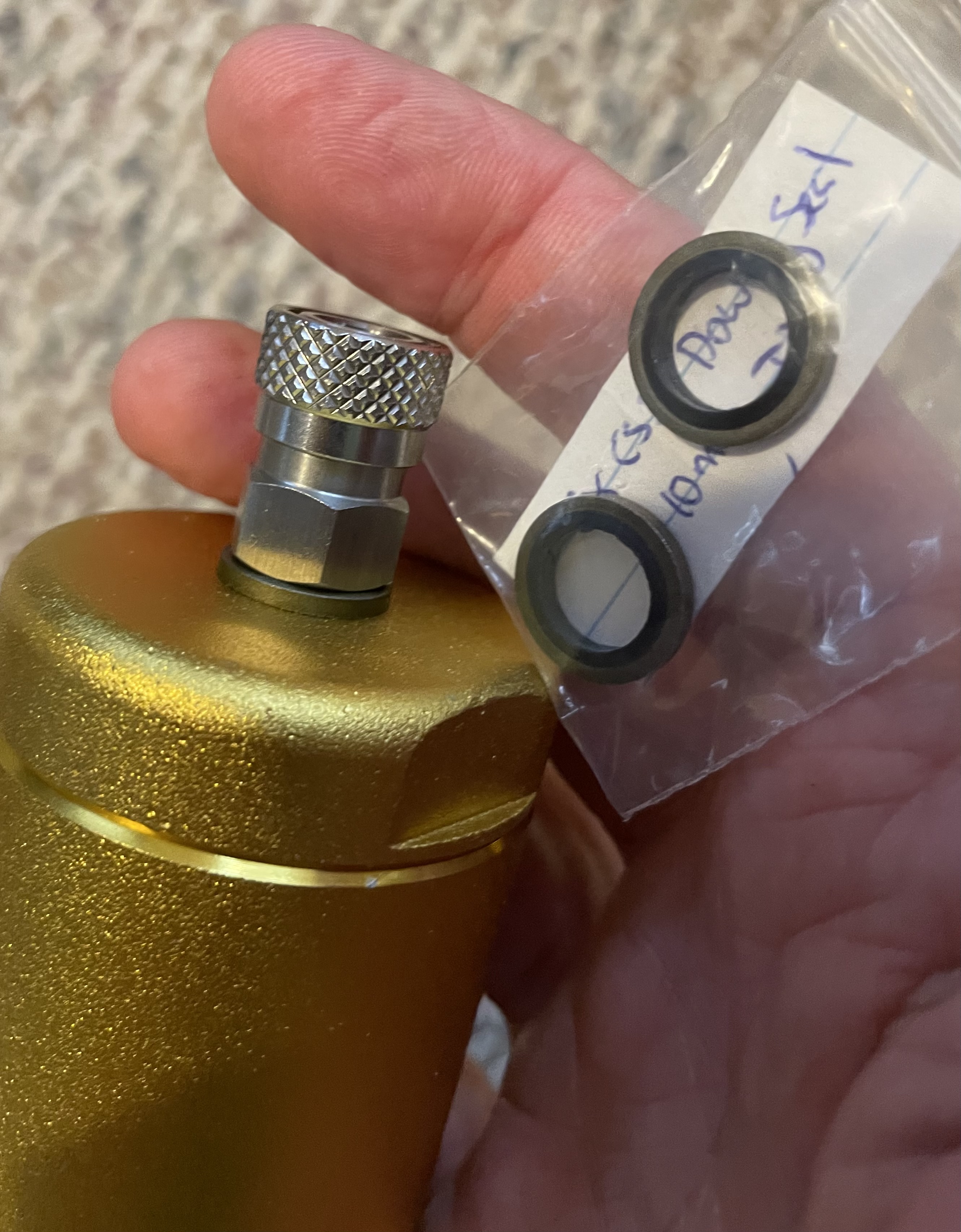

Additional Info for those interested:
In the pictures below, I show everything that comes with the filter. As I pointed out previously in this thread, I did not use the included hose, I put on a female quick disconnect (10mm - all the Chinese compressor stuff seems to use 10mm threads) and dowty seal (bonded washer).
The little gold filter does NOT come with the big Filter's kit, I just include it for a size comparison - as it was the size filter I used with my GX CS2's when filling air gun cylinders.
I show a close-up of the bonded washer installed (an extra was included with the Tuxing Gold filter). Tuxing pre-installed the male quick disconnect with a bonded washer (I eventually swapped it to the other end for reason mentioned above).
Note that the two screw on ends have a hole in them. You use these to stick in an allen key (or punch) for leverage to tighten/loosen the caps.

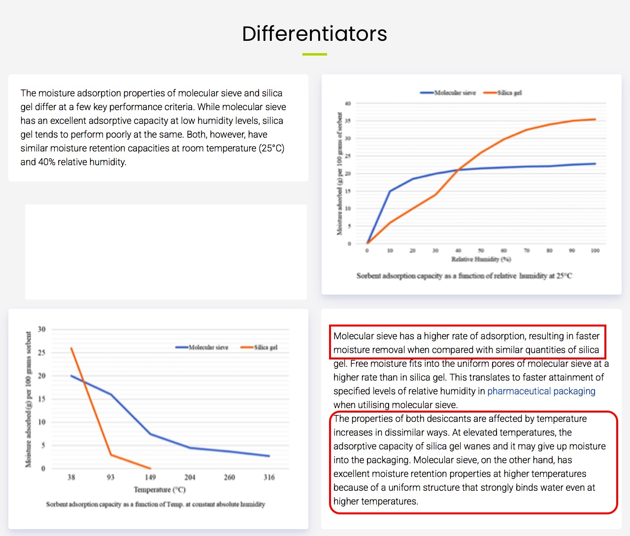

Desiccant (silica gel) vs. Molecular Sieve:
The Tuxing Gold filter can be ordered with: (1) Desiccant, (2) Molecular Sieve or (3) both plus carbon.
I chose Molecular Sieve based on the research I did - it seems that it was the media most appropriate for the Use Case that we are trying to achieve - see the red boxes I highlighted regarding effectiveness as temperature increases.
Let me know your thoughts on the filter orientation PumaCarl, and I hope that this information helps AGN members who are contemplating filters for their compressors.
-EPG
Setup of my Tuxing:
-EPG
If that's all the moisture you got, and it didn't actually go into your your Molecular Sieve Media (MSM), that's great. With my YH, and it's speed and heat and only 40% humidity, my purges are productive, and I do them every 5 minutes or 500psi gain.
That system to hold your MSM is very nice. I made my own with pvc and orings and use the same stuff your using. For all the reasons your chart shows most people do go the MSM route. Carbon is just for breathing air, or smell. Seeing how you are not using different medias in layers, I would think there is no wrong direction to set yours up. Now that I said that, someone will jump in and correct me if I am wrong. Honestly, I see a lot of leverage on that little fitting coming off the compressor and I believe that's an accident waiting to happen. This is just my opinion and it certainly doesn't mean you are wrong, just that I think that you are taking a chance. I would definitely run your short hose to that small filter (on the right in your picture) first and hook that to the big filter. If you mount this stuff vertically, and do a short purge every 10 minutes, your big filter should never see a drop of water. Mine hasn't. I run all my fill lines vertically, even when, especially when, I am using a hand pump, and I have never had water in my guns. Like I said above, I change the little cotton filter, in the little filter every fill, just to play it safe. Sometimes they might have a little oil or be slightly damp, but that's rare, and either way nothing has made it in to my MSM yet. Check your hoses and fittings with your hands as you are filling. If they are cold, they're leaking. You can never see it, and I know with a YH you can never hear it, but the feeling method always works.
There is a lot of ways to skin this cat. Nice compressor!
