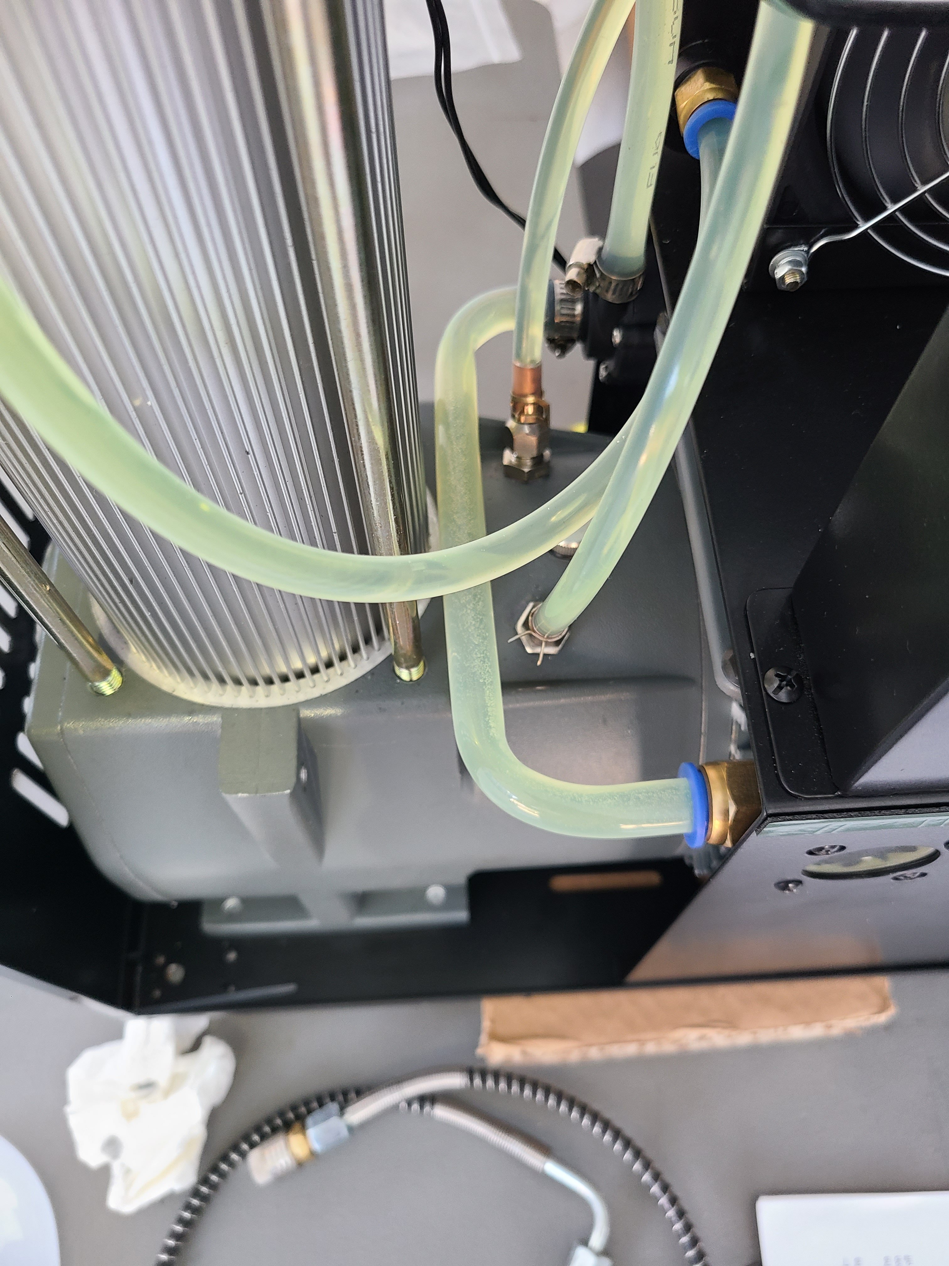

Not much information out there on this compressor so im going to share my experience. I decided to try the single cylinder instead of the 5K2, less to go wrong and easier to fix. Im not looking for the fastest, reliability is more important, so hopefully i made the right choice. Im pretty amazed how quite and smooth it runs. Much more than my CS4 and should be for the cost. Built like a tank with the cast iron bottom end. Seems very well made.
1st fill topping a 97 cu ft from 250b to 310b
Time, 20 minutes
Water temperature, 107° F @ 310b
Peek power, 780 watts
There is coolant lines running into the gear box, so that's definitely different. My guess is keeping the bearings, gears happy.
