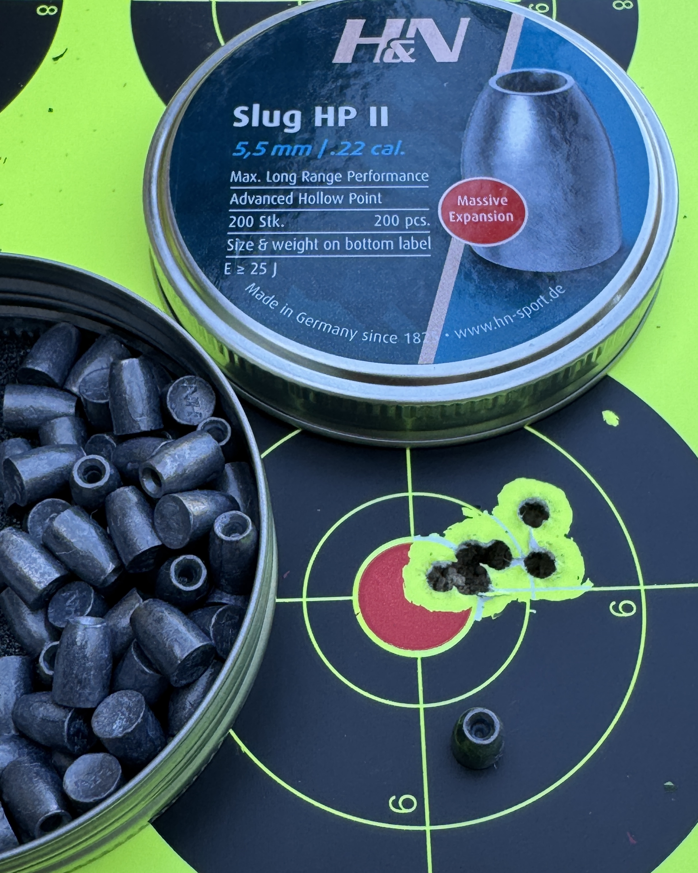

RAW Rapid H&N .218 27g @ 1020 FPS
The HM1000x is the dialed in and ready to hunt!
Nice shooting!!!! Whats distance is that group at?? 1000fps thru the RAW is hootin!!!!
Just some quick 50y groups.
I tuned this HM1000x for maximum velocity and harmony. Which put my reg at 160b and the hammer balanced to match.
My goal was to shoot the 30g about 1000fps but it maxed out at 970 and they weren’t as accurate.
I tried to reduce the hammer a bit for the 27g, but it was balanced with the reg and actually made accuracy worse. I’ll need to reduce the reg pressure a little if I want to back off the hammer a little to bring the 27g down to about 1000fps.
Or maybe I’ll just it where it is!

I tried everything from 27g to 34g (.217 & .218) including the new 33g precision slugs. I’m sticking with these for a while. But thanks!
