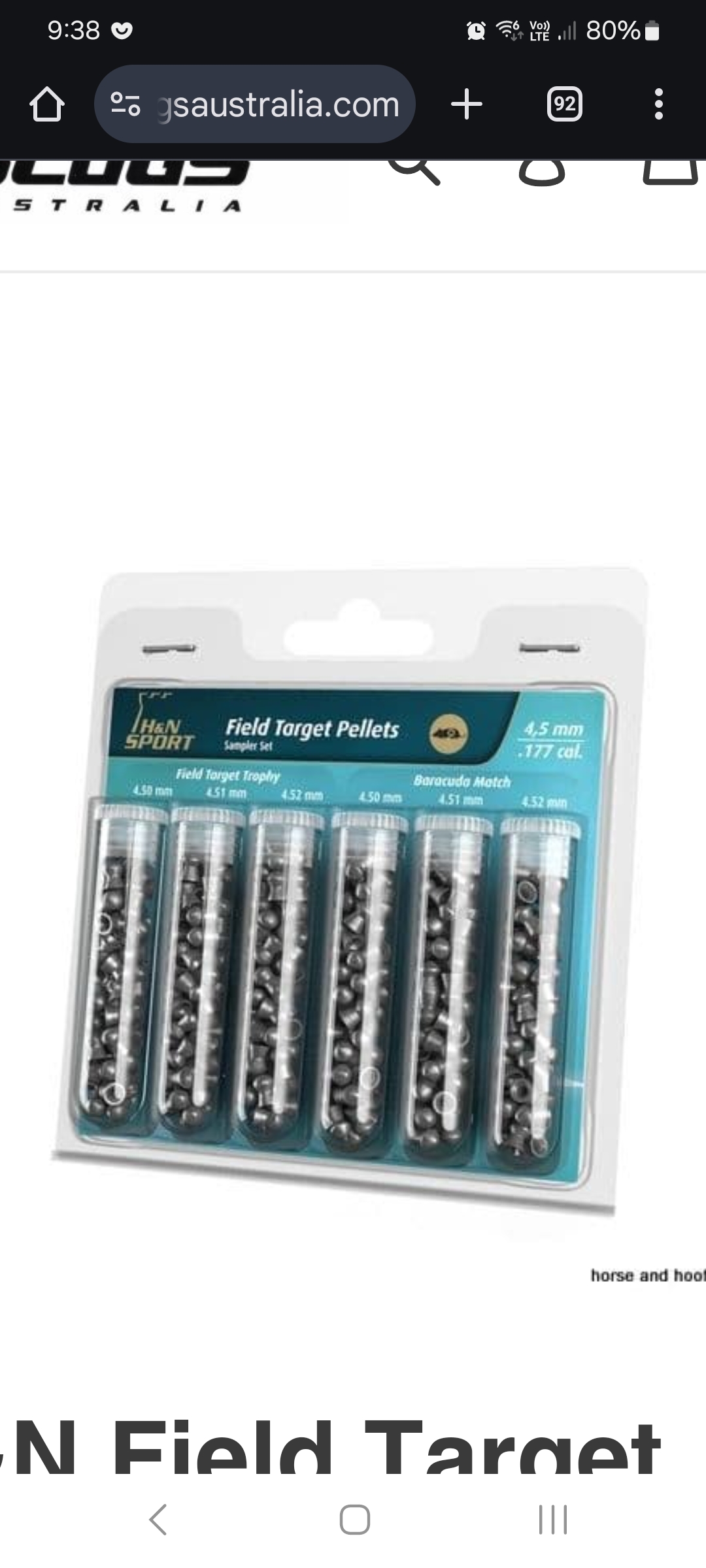

I ordered one of these sample packs last night.
