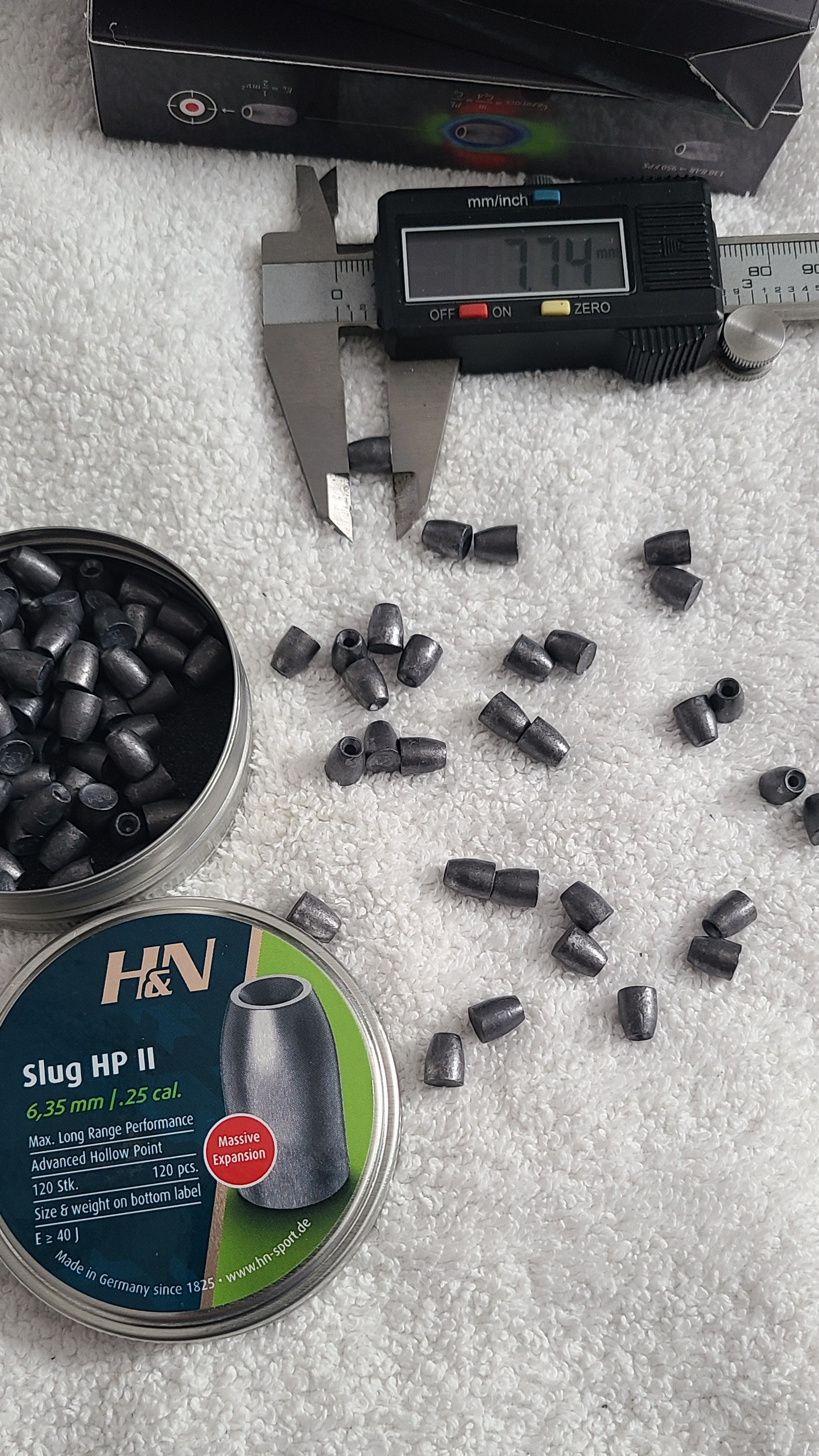

long story short got 4 tins of H&NII 34g shots one tin 1/2 way through the tin i noticed some fliers or two or three just off 2-3 in?
this is my m3 .25 700mm decided to check them.

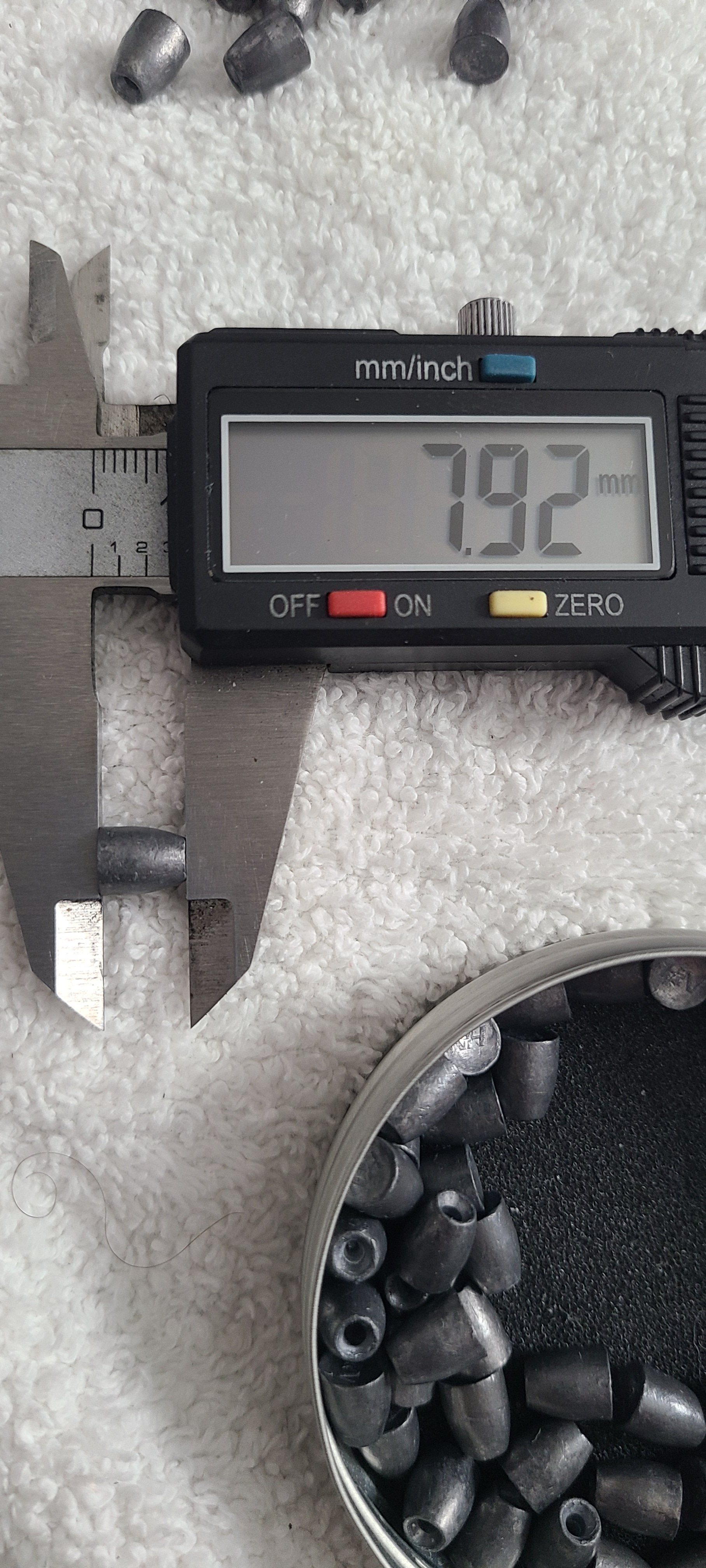

0.15 + difference in length, that explains that 30 in one tin measured 7.74 the remaining measure 7.92 .

With that much difference in length, are the weights the same?
they actually weigh 34.2 on the scale the 30g weigh 29,8 and the 32g are on the money.
emailed H&N there taking care of it, excellent customer service now if only Zan would respond there .25 measure 248.5 box says .250
35g they fall out of the breech my goodness.
thanks JaySpace for the heads up to call H&N.
