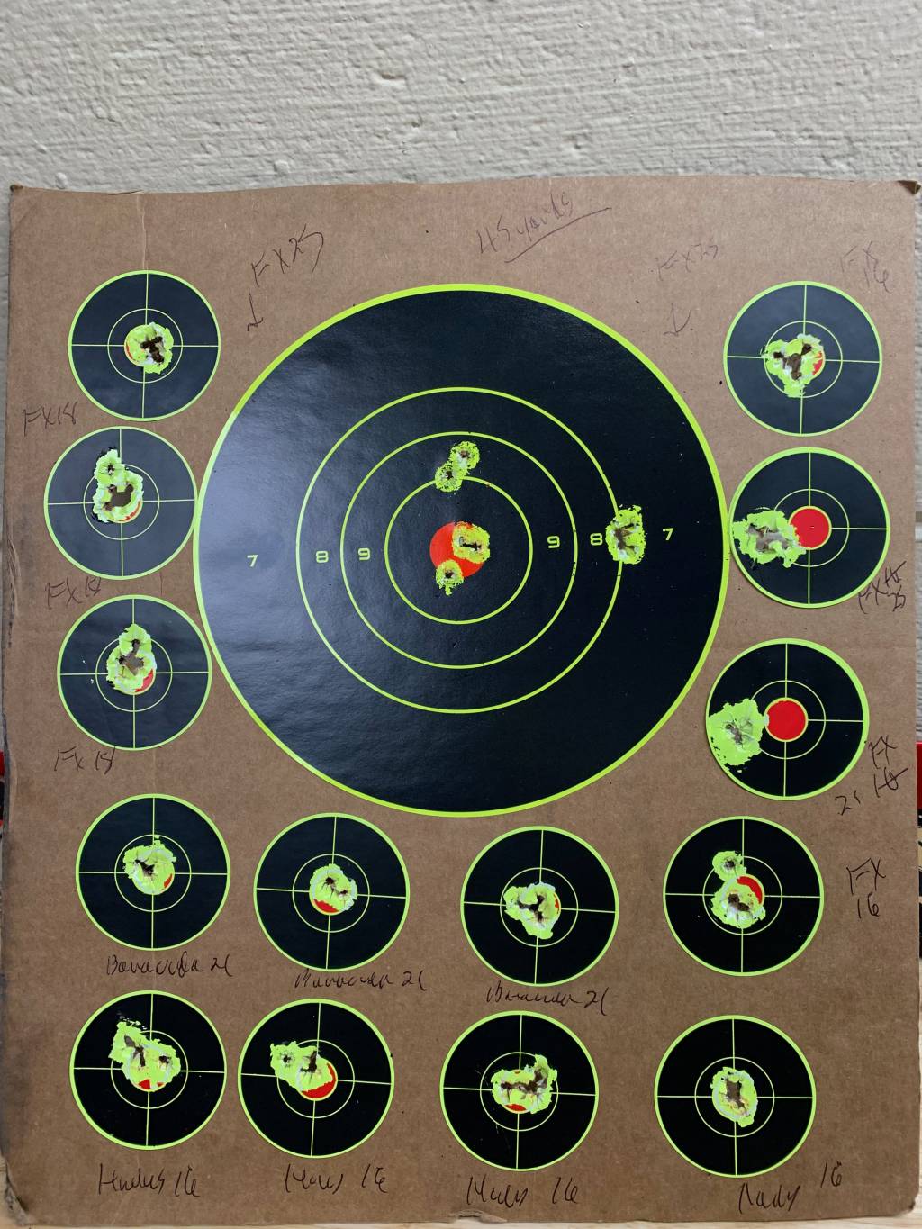

Here is a comparison of the 21 grain Baracuda's along with JSB and FX variants out of my FX Maverick .22 compact. Baracuda shooting 885fps at 45 yards.

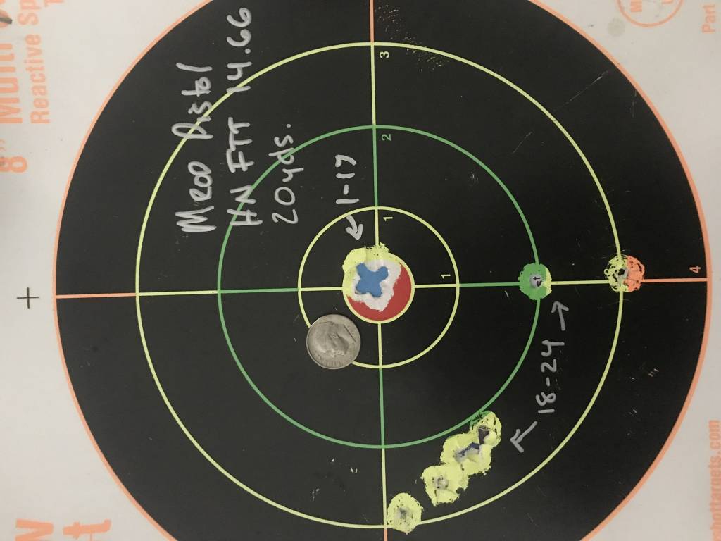

I test lots of pellets to find the best performing pellet/rifle combinations.
One of my .20 R9’s prefers the H&N Baracuda 13.58 grains pellets. My .22 HW97K shoots lights out with the Field Target Trophy 14.66 Gr (5.53) pellets and easily out performs all other options in this rifle.

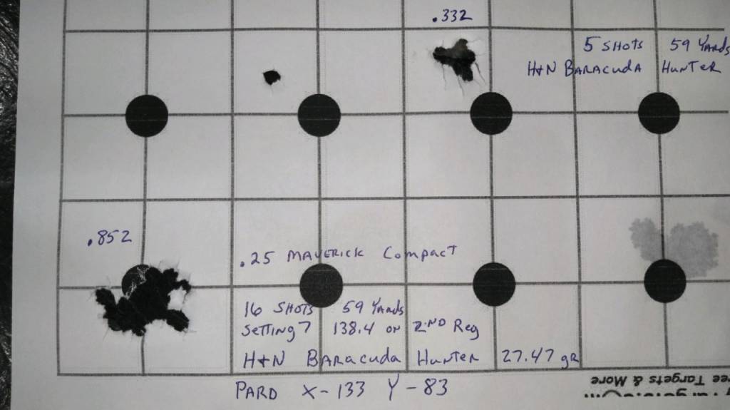

I'm shooting .25 caliber H&N Baracuda Hunters in my FX Maverick Compact right at 930 fps.
Groups were shot at 59 yards with the PARD, bipod and supported butt.
I have four tins of .25 Baracuda Hunter Extreme that I have not played with. The Maverick does not seem too picky about pellets. I can get it to shoot most pellets well. Doesn't seem to matter if they're Air Arms, JSB or H&N. A little tweak and a fiddle and they shoot well.
