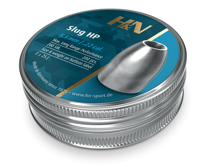

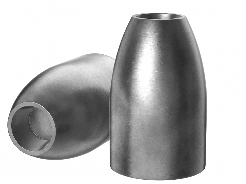

Like the Grizzly, the HP Slug HP has been developed from our hollowpoint bullets. The diameters, the lead alloy, the shape of the hollow point and the base have, however, been adapted to the special requirements for using in air rifles. Diameter variants are .217 and .218, the weight options are 21, 23, 25, 27 and 30 grain. Count per box is 200.

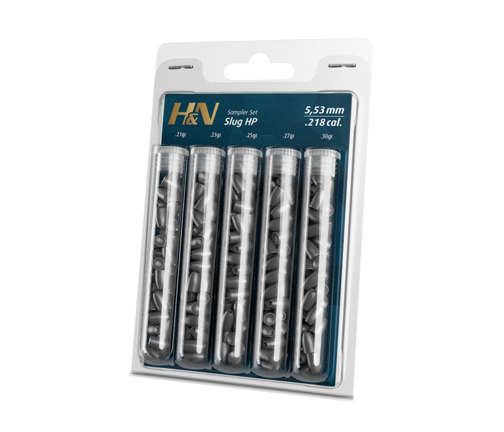

The H&N Slug HP will work fine in a broad variety of air guns but your gun should have at least 30ft/lbs of muzzle energy. So far I can definitely say that rifles from FX (like the Impact) with slugliner prefer the diameter .218, while the ones from Daystate (Red Wolf, Huntsman, Wolverine, etc.) and the Weihrauch HW 100/110 series shoot better with .217. All the above mentioned brands/models give excellent results at 110 yards (our standard testing range). If you are not sure about the best diameter and weight for your gun then you should try the H&N Slug Sampler.
