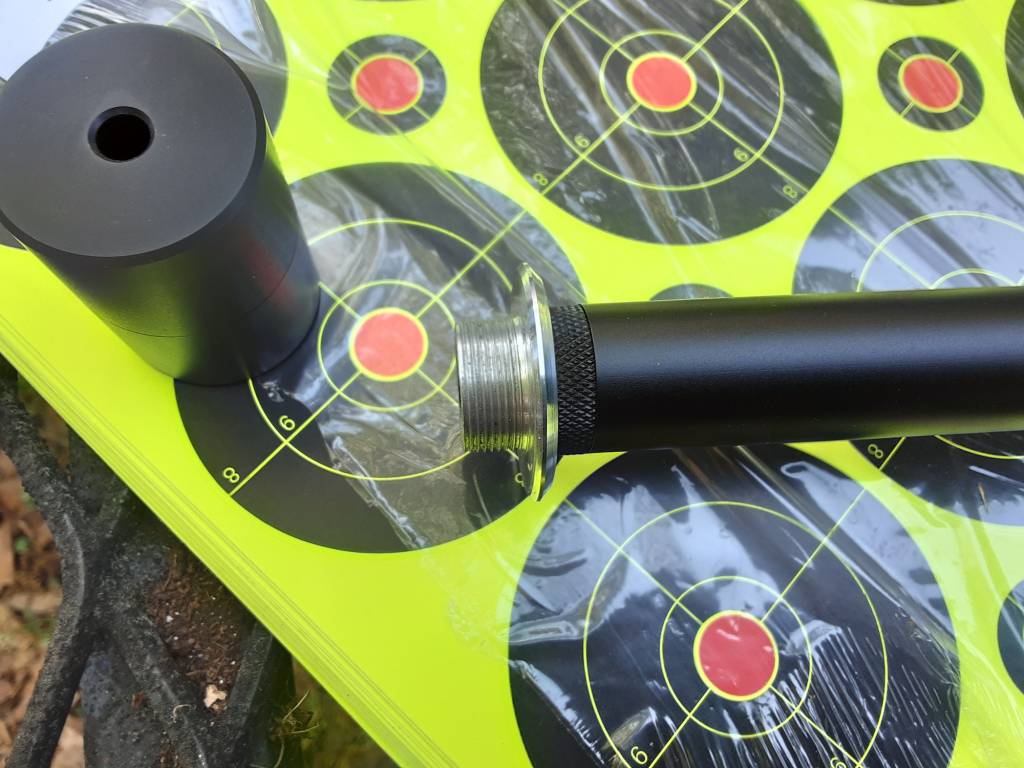

The higher you go in power and projectile size, the louder the impact. Even though you make the shot back yard friendly the sound from the pellet impact may not be. My .30 Impact at 132 fpe sounds like a mid power .22 when shooting targets at long range but hitting a squirrel in my backyard sounds like you smacked a wet pillow with a boat paddle. I'm sure my neighbors can hear it 200 yards away.
You can buy 4 or 5 gauntlets for the price of those fx guns so add a moderator and have fun with the gauntlet. I turned an adapter on the lathe for my son's gauntlet to use an oem FX can. He keeps the gun tuned low for his neighborhood but I put a short can on it after replacing the shroud with a short one that doesn't have baffles.

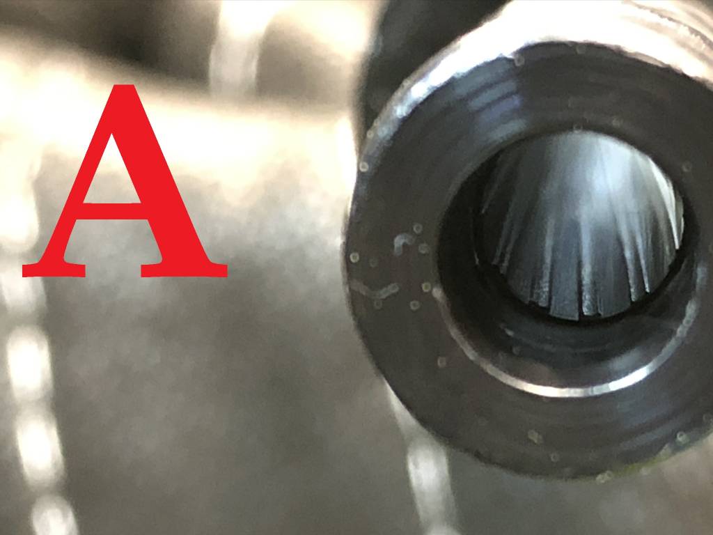

I purchased the Gauntlet 2.
Love the accuracy. Hate the bolt. I have to slam the bolt forward hard to chamber a round. After about 20 rounds I quit shooting it because it isn't any fun to shoot.
This is my first air gun and I want to shoot this gun badly. Please advise . Is there something I can do to resolve this problem ?
Bill
Hey Bill,
The difficult chambering issue that you are describing is something that I have witnessed and documented in the past and there are a few things that you can do to alleviate some of the effort to chamber a round. I am going to get a bit geeky here but I want to describe what the internal of a bore look like from the breech end to the barrel.
Typically the breech will be just large enough to accept the projectile being offered and allow it to be transported by the pellet probe or cocking bolt into the chamber area of the barrel. Along the way to the final resting spot prior to firing the rifle, the projectile is being led into a narrowing transfer passage which introduces the projectile to the rifling. This chamber or lead-in (leed in) area of the barrel should be a smooth and gradual transition from breech to chamber. The Gauntlets breech to chamber transition is very steep and shallow. SEE PHOTO A
If you use a projectile with a fairly soft lead it will be able to be wedged past that very sharp and abrupt step you see there in the lead in but harder ammo like H&N or Crosman will be very difficult to push into that hard edge.
So what to do? There are a few things to consider.
  1. If you continue to use the rifle and continue to chamber round after round after round that edge will soften over time or "break-in" but if you're in pain and the effort negates the interest to continue, that is not an option.
  2. You can use only soft lead projectiles like JSB or FX which will require far less effort to chamber but that would limit your ammo choice and put you in what I consider "Premium Ammo Cost".
  3. Physically working the problem, mechanically changing the chambers' current state.

Thanks for this link Hajimoto.

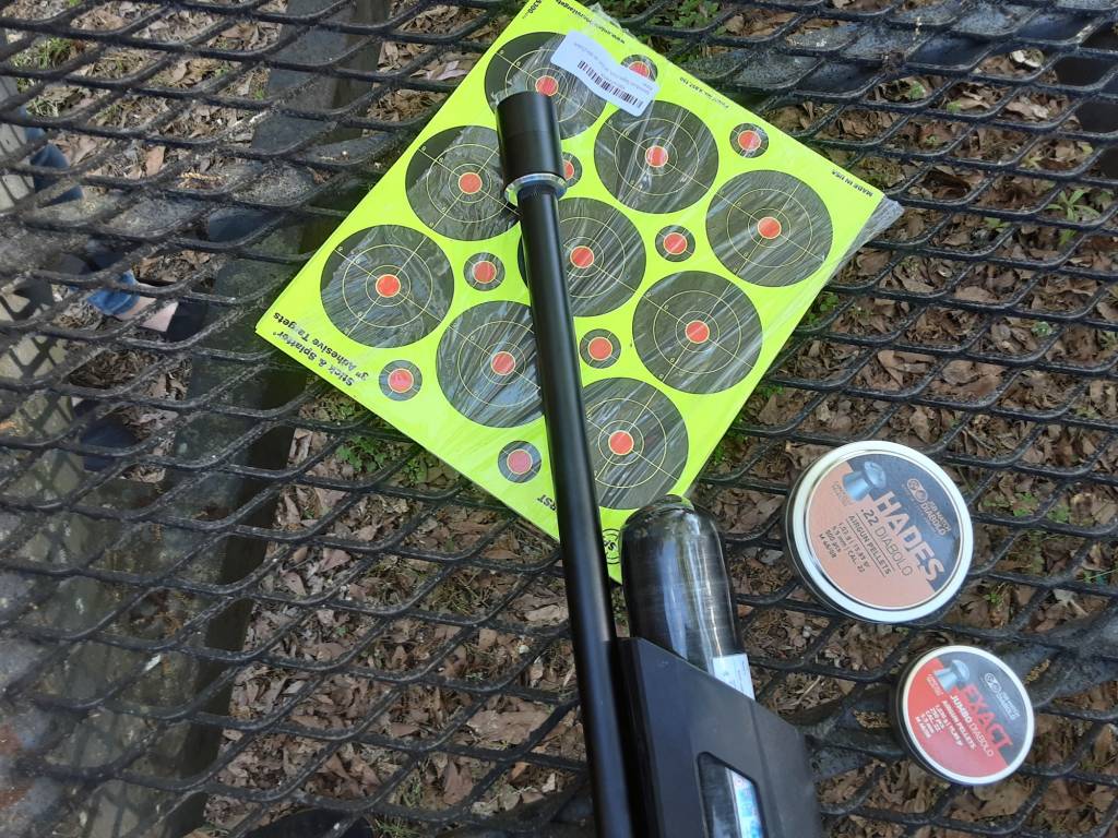

I loaded a pellet into the G2’s chamber then pushed it back out, with a push rod, and the pellet was significantly damaged, and came out with lead flakes. I kind of came to the conclusion that, this was the cause of my G2’s lack of accuracy. That’s where I wondered what your thoughts would be on that conclusion.
