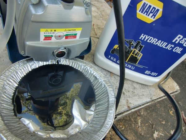

Half breed gets a oil change.
This is after 2 hours run time.Really did,nt see
m that dirty?

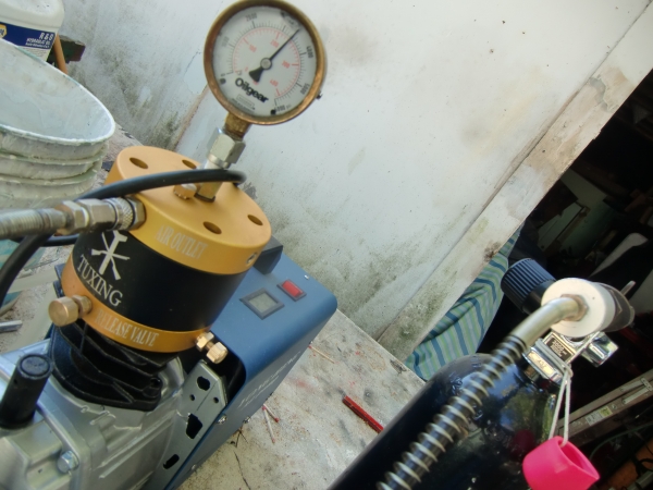

I just purchased on that ended up being a clone with a single plastic ring at the top of the high pressure side. I don't think it will last very long, but I only have 2 minutes on it at this point, That sucker gets hot quick 10 degrees in 2 minutes. I haven't tried to fill anything yet, but it's coming soon.

My first oil change in my air venturi compressor was about an hour or two of run time. The oil was nasty and stanky. I think because of whatever oil was in it to prevent rusting while in transit overseas. Then i used synthetic for another 8 or so hours and changed it again. Wasnt quite as bad. And then i just changed it again with royal purple and the oil looked and smelled better. I would rather change it at earlier intervals. Those little motors are under a lot of stress.
Willy, it has been posted on this forum many times that hydraulic oil turns dark very quickly and is not a preferred lubricant for a high pressure compressor. The Chinglish owners manuals may suggest it, but hydraulic oil doesn't last nearly as long as a high quality ISO 100 or 150 compressor oil. I don't use hydraulic oil but suspect it contains petroleum components which burn, darken, and leave deposits from the heat of these compressors. It is preferable to pay for a quality full synthetic compressor oil than have to change oil more frequently and deal with the carbon deposits and damage caused by using hydraulic oil.
I have asked the customer service people of the Yong Heng official on-line shop in China about the issue of oil darkening quickly and what oil is the best for their compressors . The answer is that the recommended hydraulic oil is OK and the darkening is due to "ash" dropping down from the 1st stage cylinder which is made of cast iron. The darkening will go away after the compressor is broken in and oil change is done for a few times. Does the ash explanation make any sense ?
I did the first oil change ( with #46 hydraulic oil ) after the first 10 min. of running. Then ran it for another 15 min, all under normal load, the hydraulic oil got quite dark already and I changed oil again but switched to #100 compressor oil this time. It's just cheap stuff from China costing about 5 USD per liter . Since then it has accumulated an additional 35 mins of run time and the oil is just slightly darkened. Apparently it's getting better. Not sure if it is because of the change of oil type or the compressor has broken in more.
