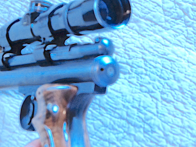

Crosman 150s with the hammer-spring-tension (power) adjustment feature have a little hole in the ass-end of the cocking knob. If your's does and you need help figuring it out, feel free to call me at 254-253-1239, noon till midnight CST any day (I'm retired).
My Crosman 150 does not have the little hole in the cocking knob. It has two cocking positions. You can pull it part way out and it will cock at low power or you can pull it all the way out and it will cock at full power.
