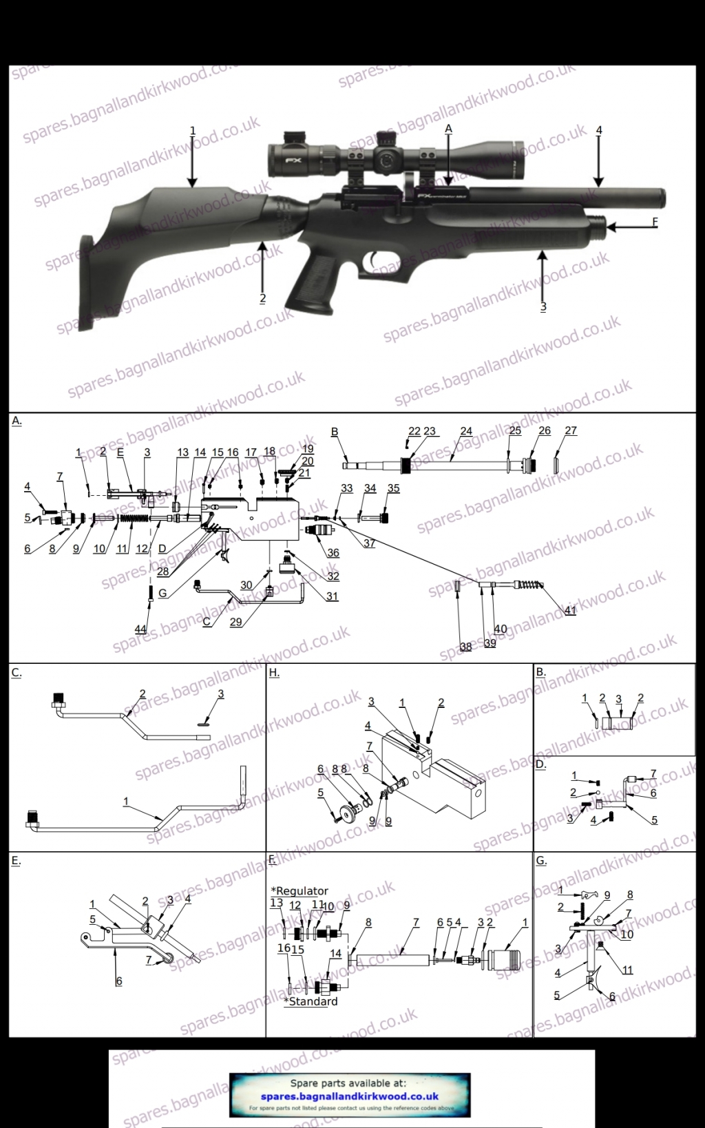

i want to jack up the power on this gun for archery, and return to stock 40 fpe for lead. The power adjuster is useless in this regard.
hammer spring or regulator? And how? Thanks?
