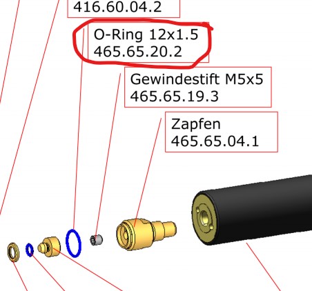

When my AR20 leaked air, I replaced this O-ring with a 12x2 O-ring.
Last night I toke it apart partially only, and seeing that oring you pointed to (12x1.5) is some hard material, more like a plastic ring vs a rubber oring, already started disintegrating.
Ordered a full set of BUNA 90 orings from that your same BOM.

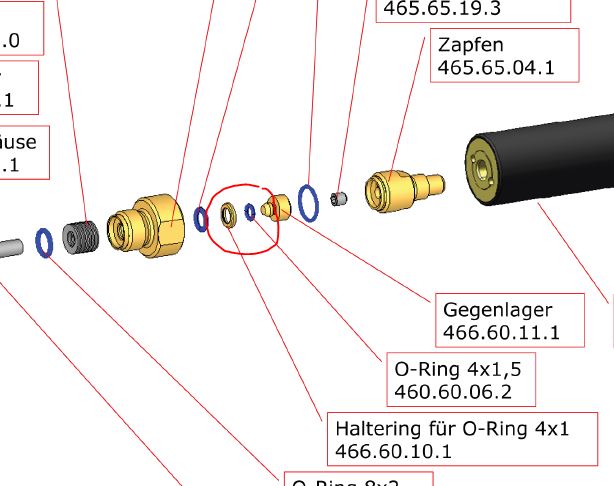

Question:
1.) Shall I put a red loctite back again on the Valve cap? or suppose to seal alone on that green oring?
2.) I am seeing 2 part numbers on the diagram but those 2 parts are not in this my Reg, also not in the youtube video above:
