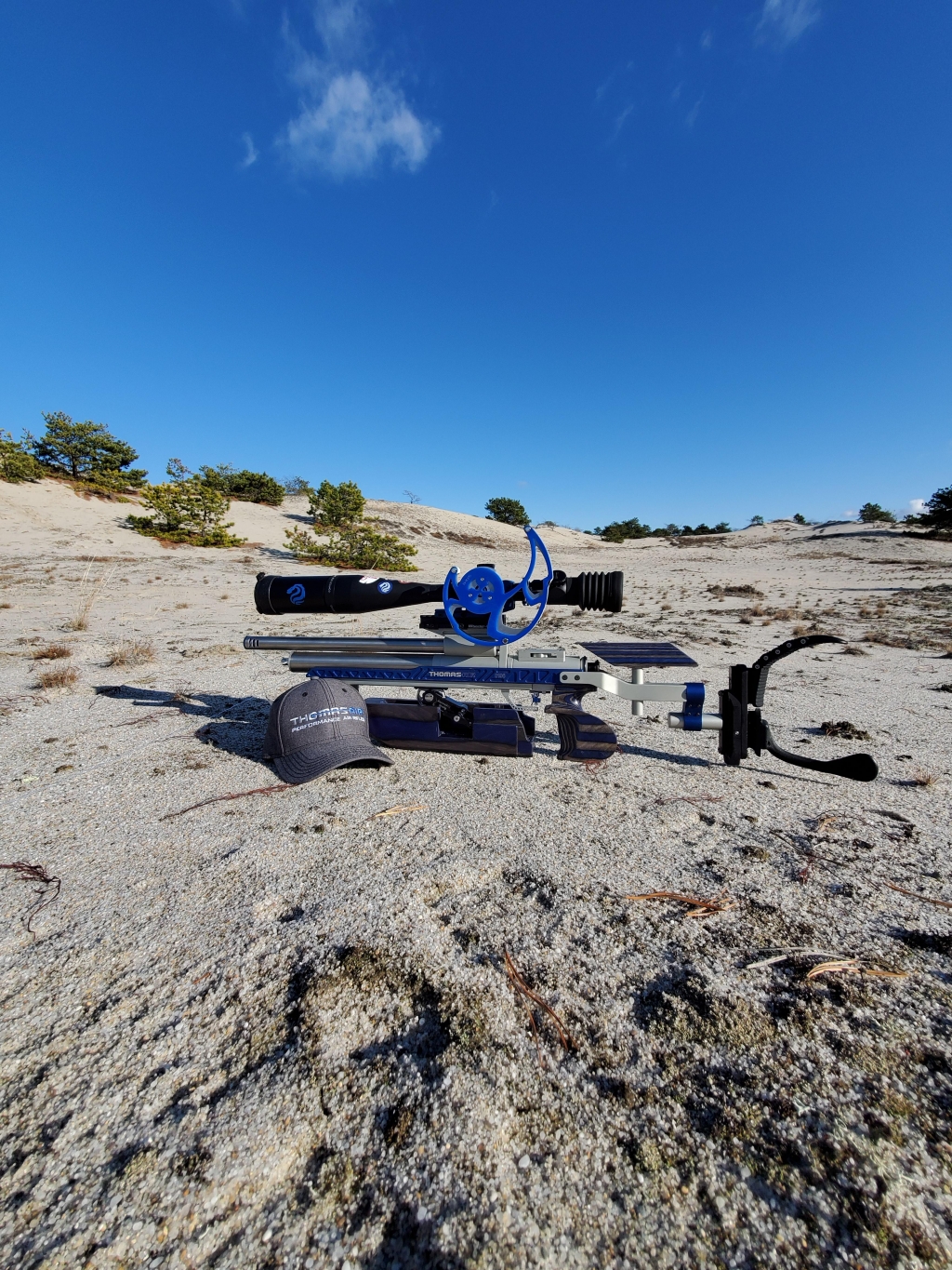

This is my FT gun. While I like how it looks when compared to many others its not exactly pretty. Worry about looks after function. Oh and I shoot WFTF.
