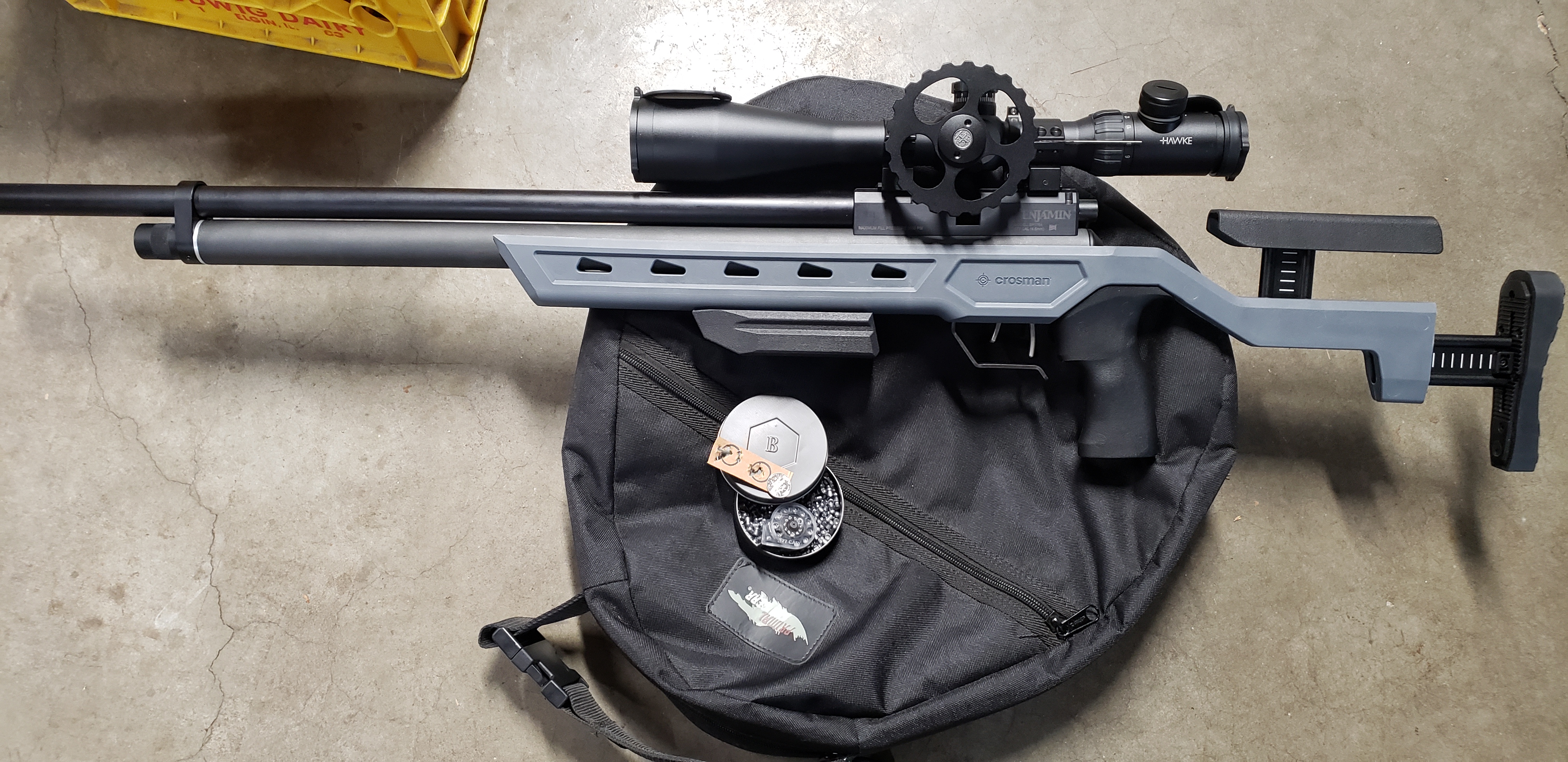

I purchased a Crosman Challenger stock for my Marauder from Airgun Revisions. It has a UIT rail and is fully adjustable. You would need to remove the gage and block off the gage port as the Challenger stock has no hole for the gage. It came with the plastic block riser pictured. It's well under your $300 budget! Contact Airgun Revisions and Rich will set you up
Reactions: cavedweller
Thats an interesting idea there. Ill keep that in mind, thank you.

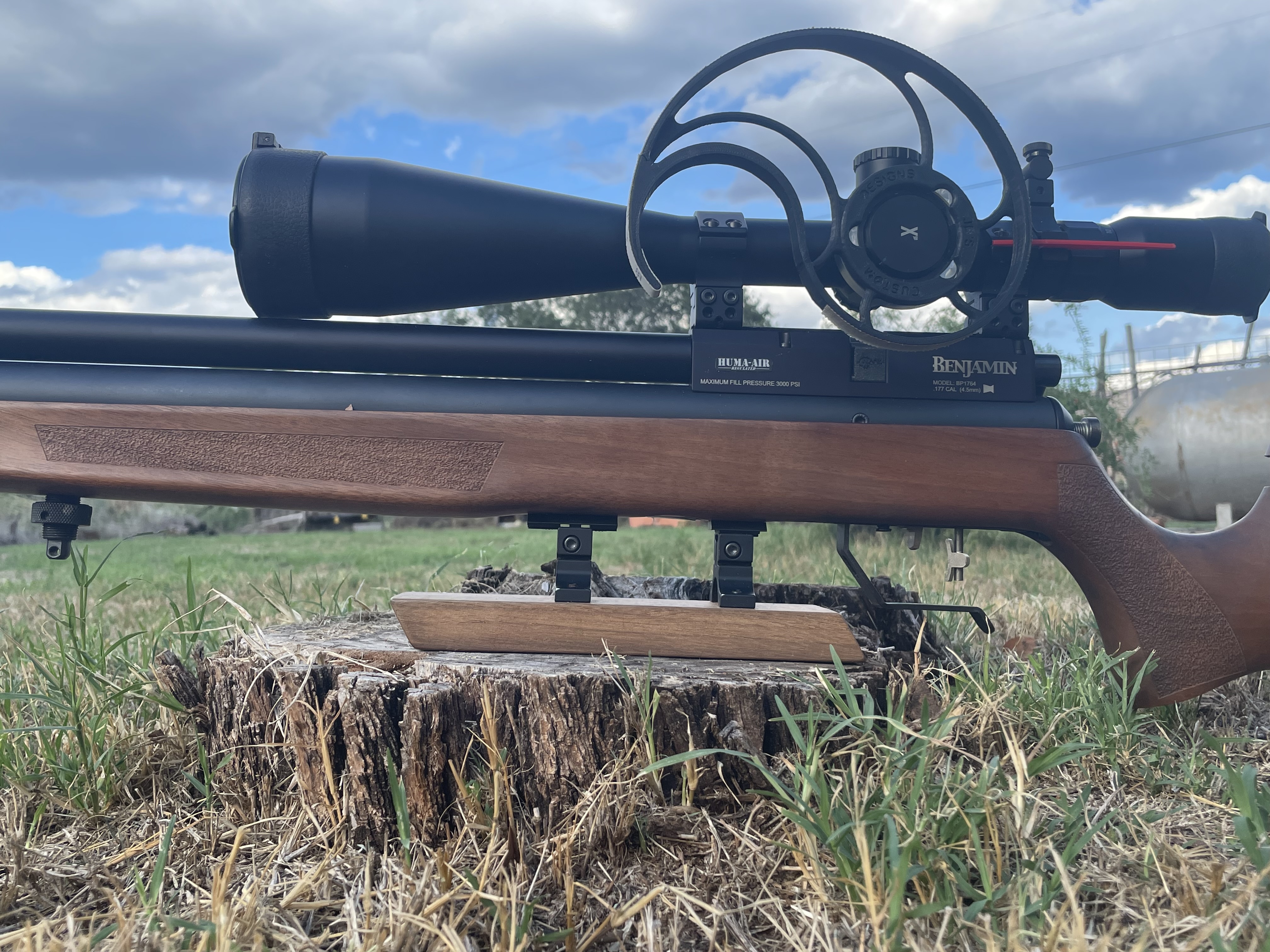

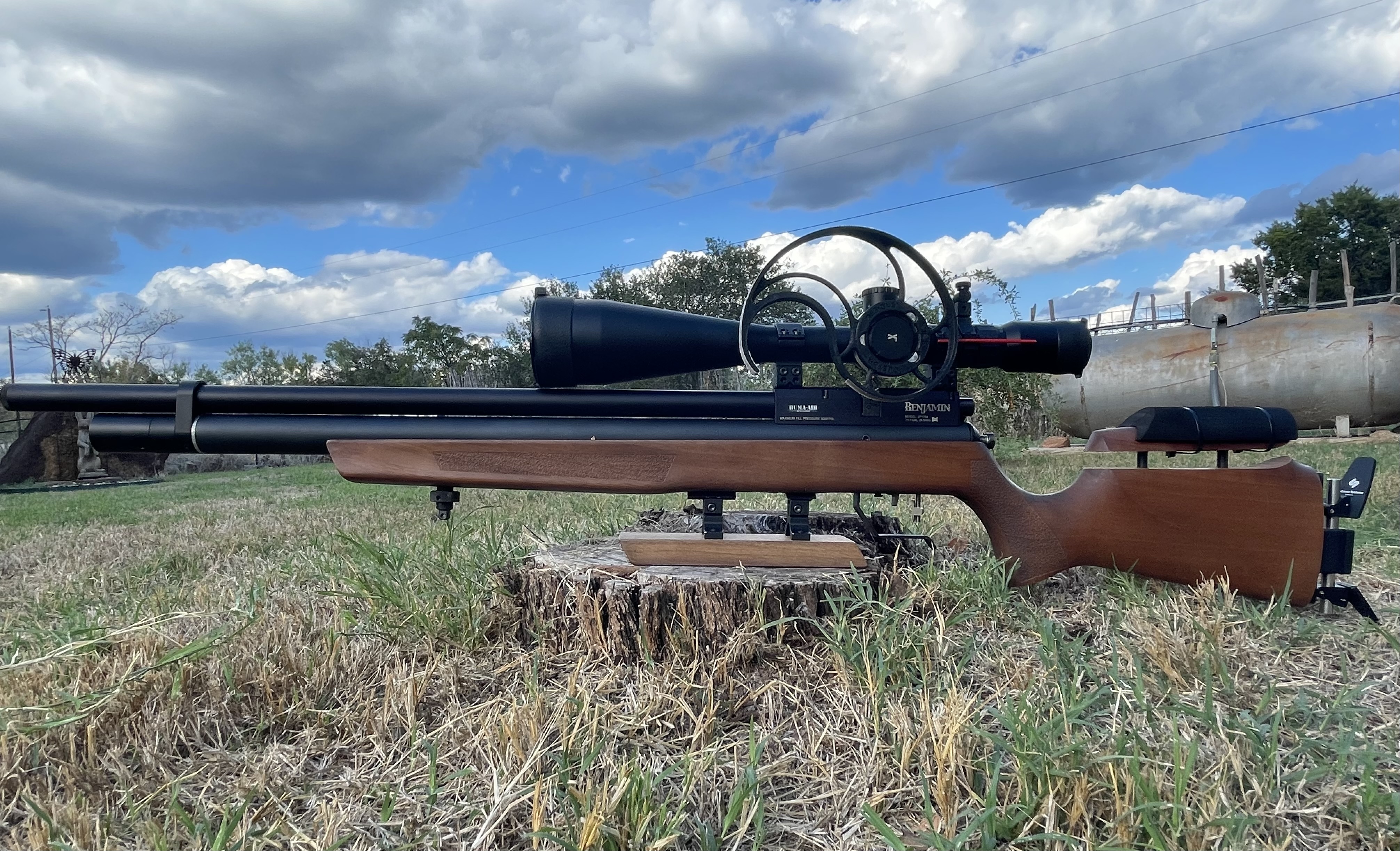

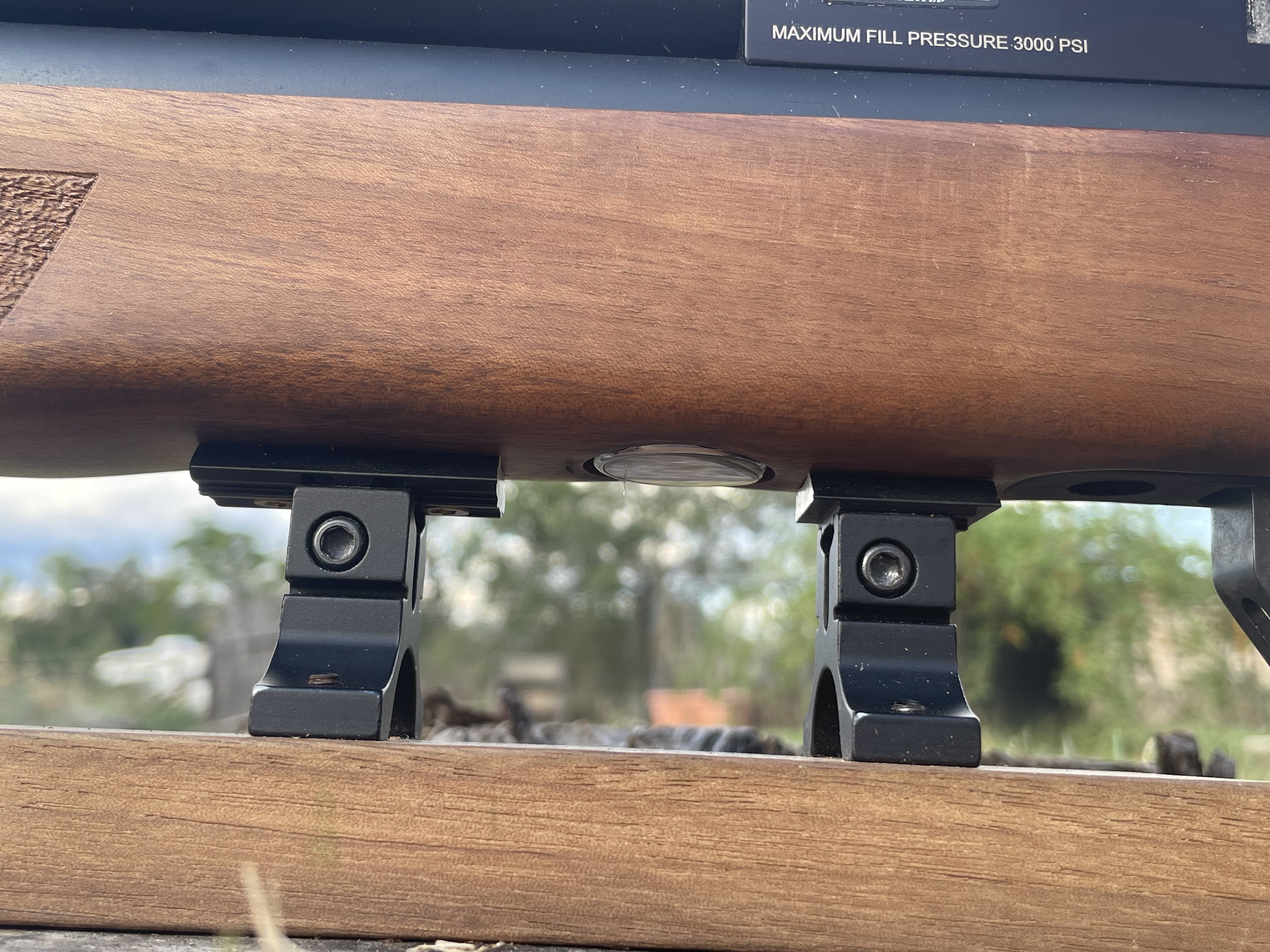

Here is mine. under $50, removable and works like a charm. Center of bore to bottom of hamster is 5 1/4". A scrap pcs of 3/4 walnut, a Ruger 10/22 Weaver/ dovetail scope mount, BKL med height 30mm rings. cut the hamster ends about 30 degree to match the fore arm angle and the Challenger trigger guard for asthetics, my 1'st pc of walnut was smaller and square.
