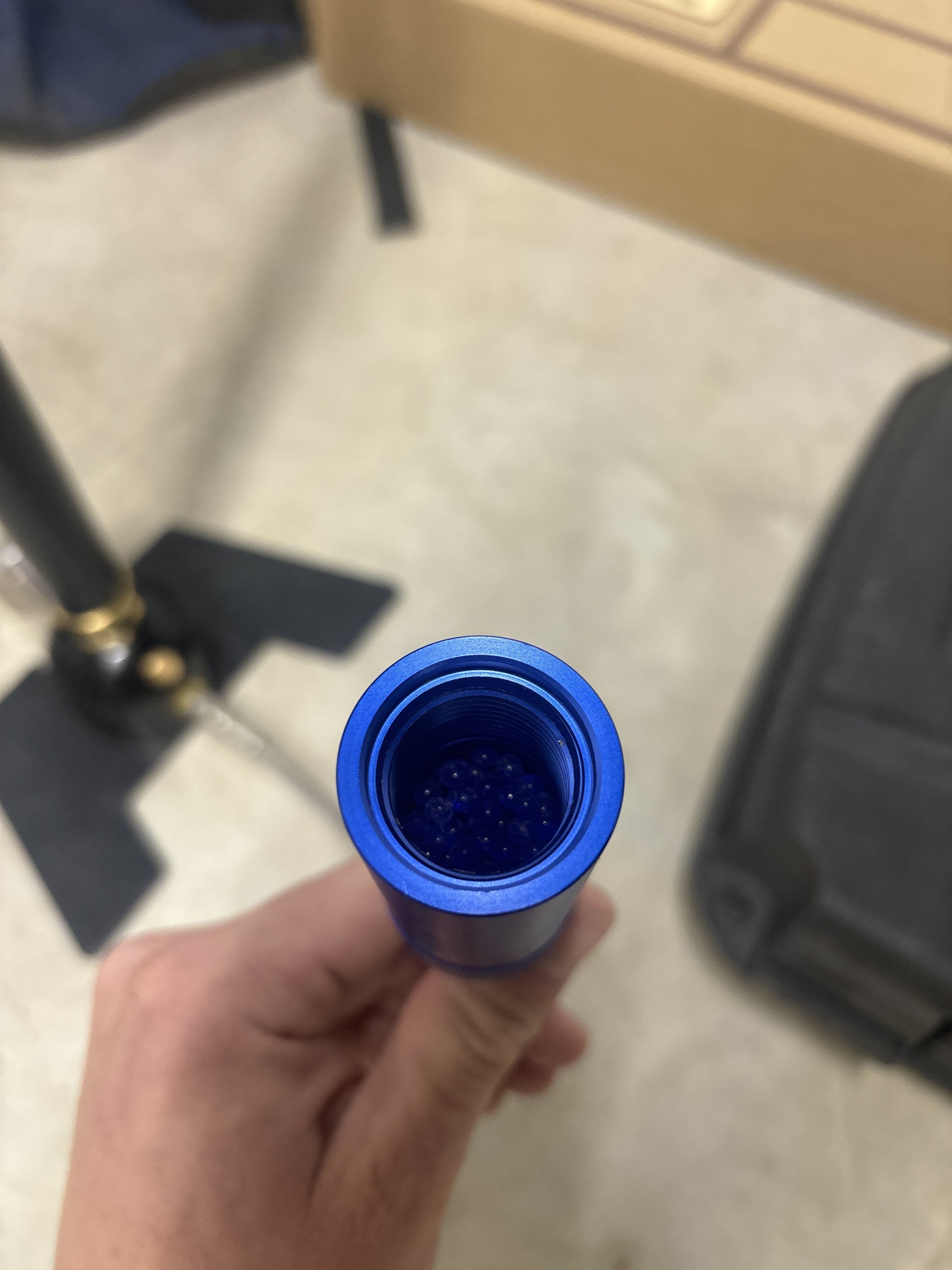

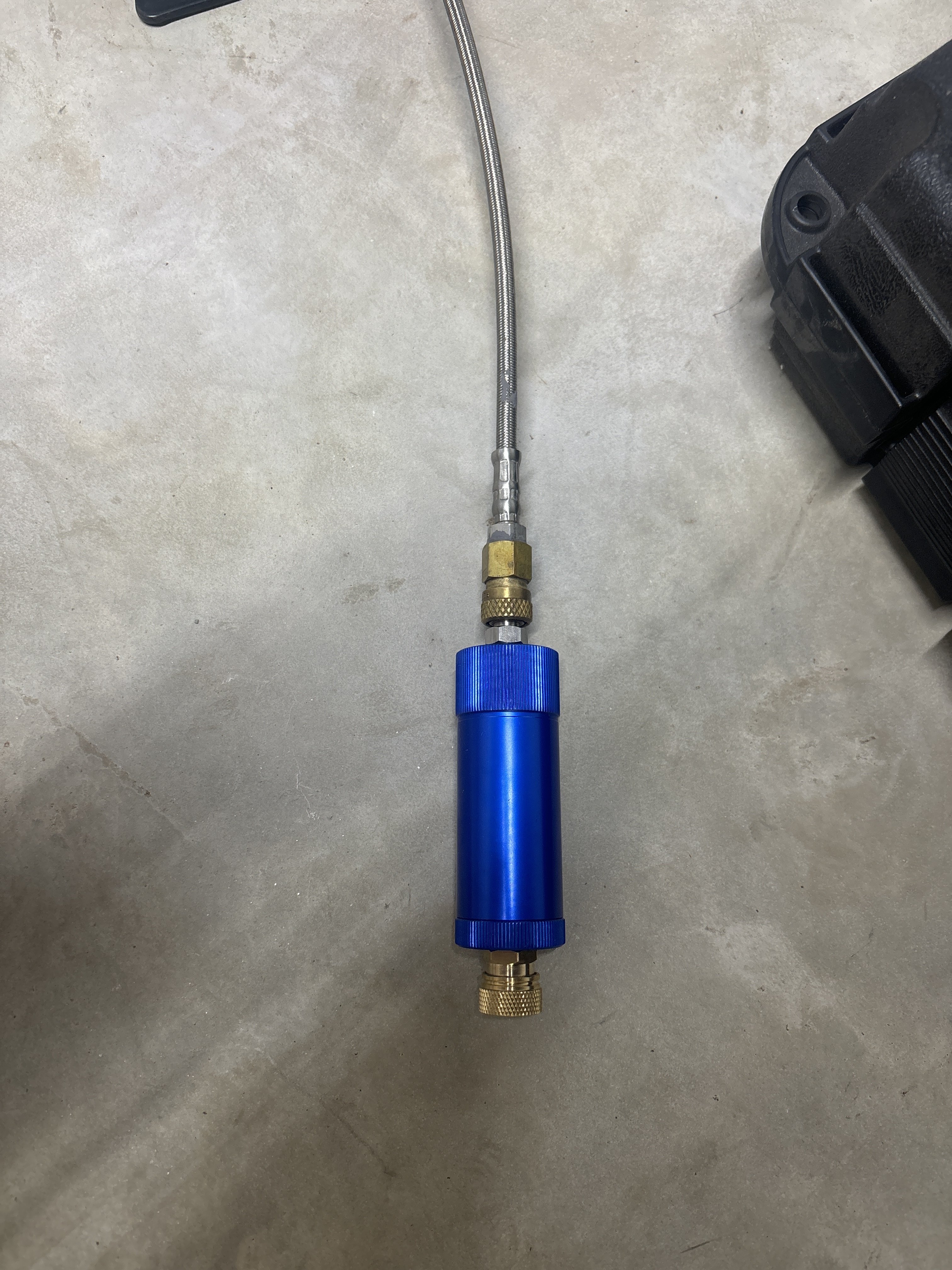

So Ive been searching and reading but i cant seem to find a straight forward answer. I have a benjamin hand pump for my marauder which has had corrison in the past from not filtering air. After researching around it seemed like my best option was a cheap inline filter and not one that goes on the intake side of the pump. I purchased one and also some silica gel dessicant to put inside it because I had read the little foam filters dont do quite enough. I havent read anything saying its ok/ worthwhile. I did read something that those beads arent supposed to be used under high pressure? just wanted to check first and get some clarification. Ive attached some photos below. I appoligize if this has been gone over to death I just couldnt find anything in my research about this specific setup.
Thanks!
Thanks!
