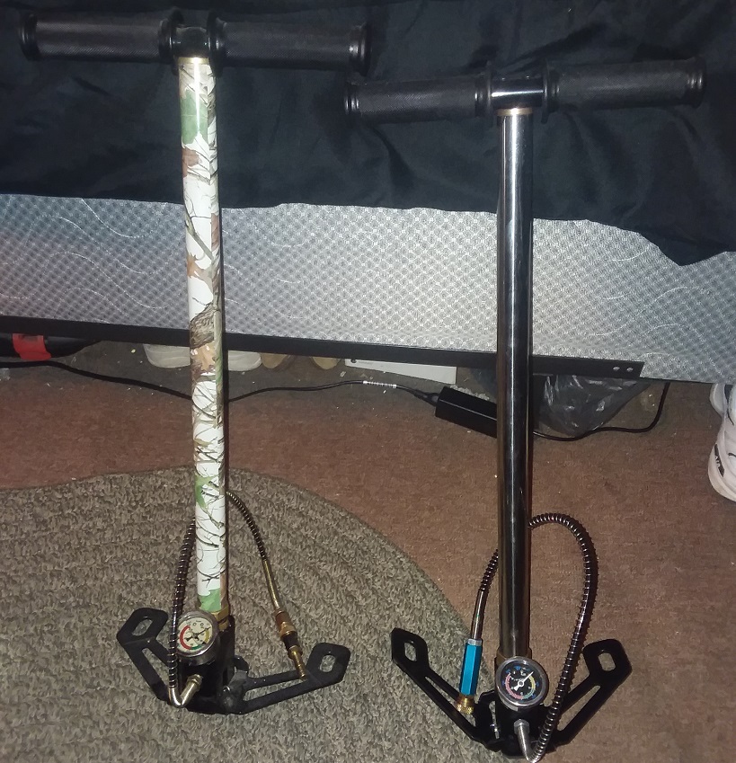

Most seem to be built by the same Chinese company and just branded for the companies wanting them made to sell. I have 2 that except for minor cosmetic differences are the same pump and look exactly like the way more expensive Air Venturi pumps. They also come with rebuild kits, although I have yet to use either of mine, so don't let cheap or Chinese (most of them are anyway) scare you off.
I've had the woodland pattern one for almost 4 years, no issues and use it to pump both a Hatsan Galatian III QE .25 and a Hatsan Flashpup .25 The silver one was bought as a backup and I have yet to need it...lol.
