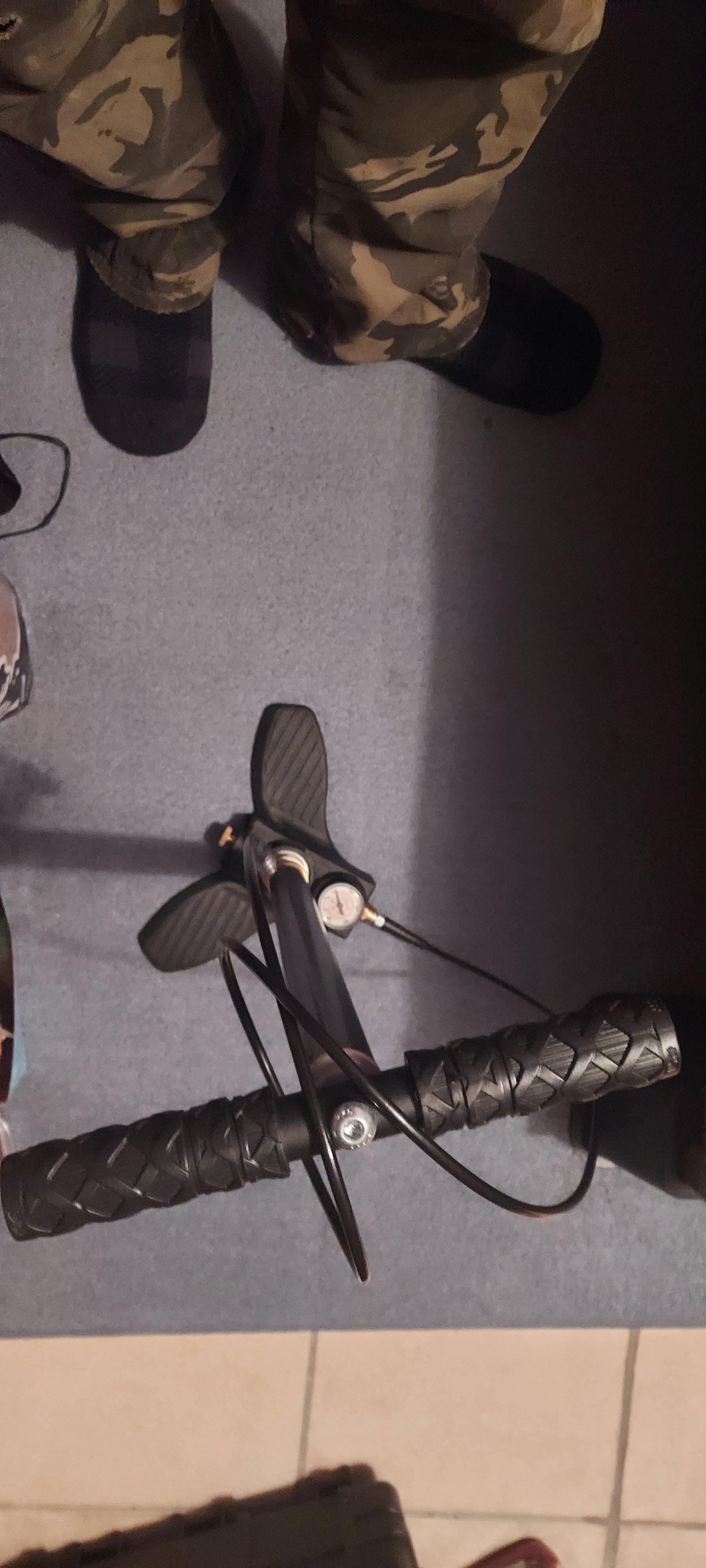

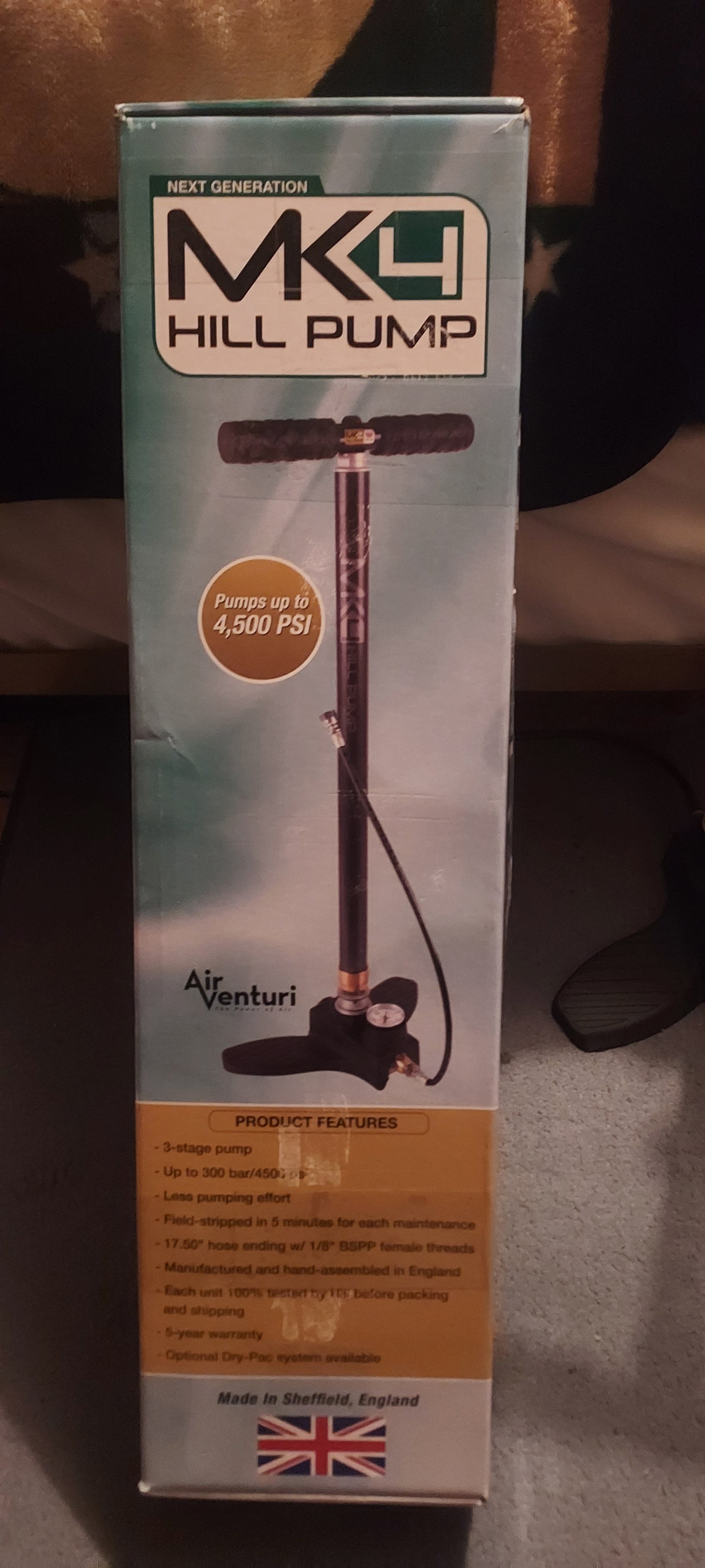

The pumping is nothing like a tire pump. HPA pumps work in both direction,(mine must be defective as its hard to pull on the upstroke while it fills with air) its a full body workout. The pumping becomes more difficult the higher the pressure. I wouldn't want to try and pump to 300 bar, i only ever went to 200 bar pumps. A hand pump is always a good backup, but its a workout. I use a Yong Heng thats served me well.
If you can swing it, something like that will make you a happier person.
This guy has a lot of content, which I feel is important to what you go with something more bargain price. Its all part of the fun of HPA.
