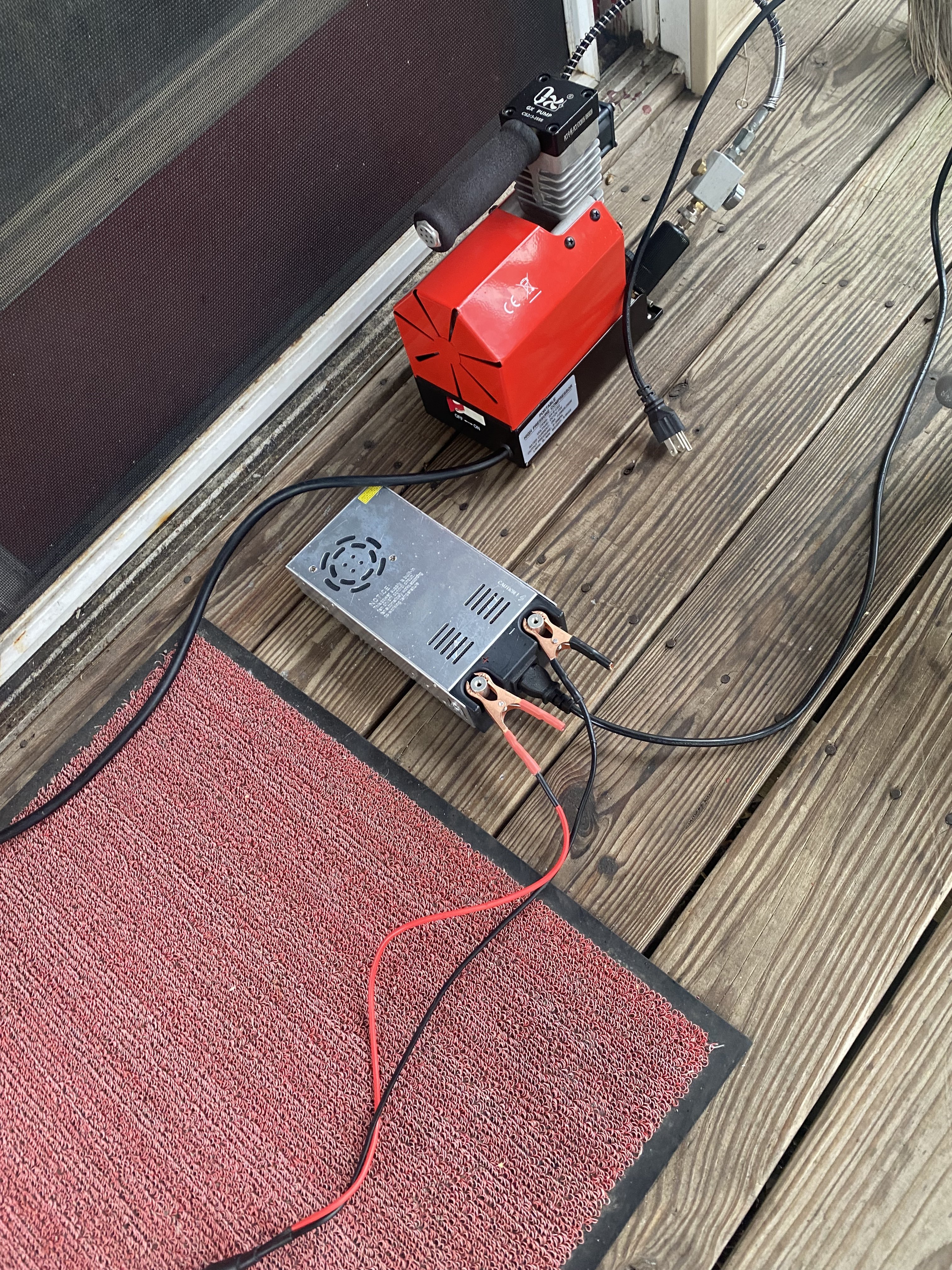

Looks a lot more convenient than my tuxing compressor with its 5 gallon bucket of water.
I have one of those for filing my scuba tanks but you can’t beat the portability of the other one just to fill your rifle, I mainly use the portable on my Ataman’s with the smaller tubes, usually under a minute to fill
