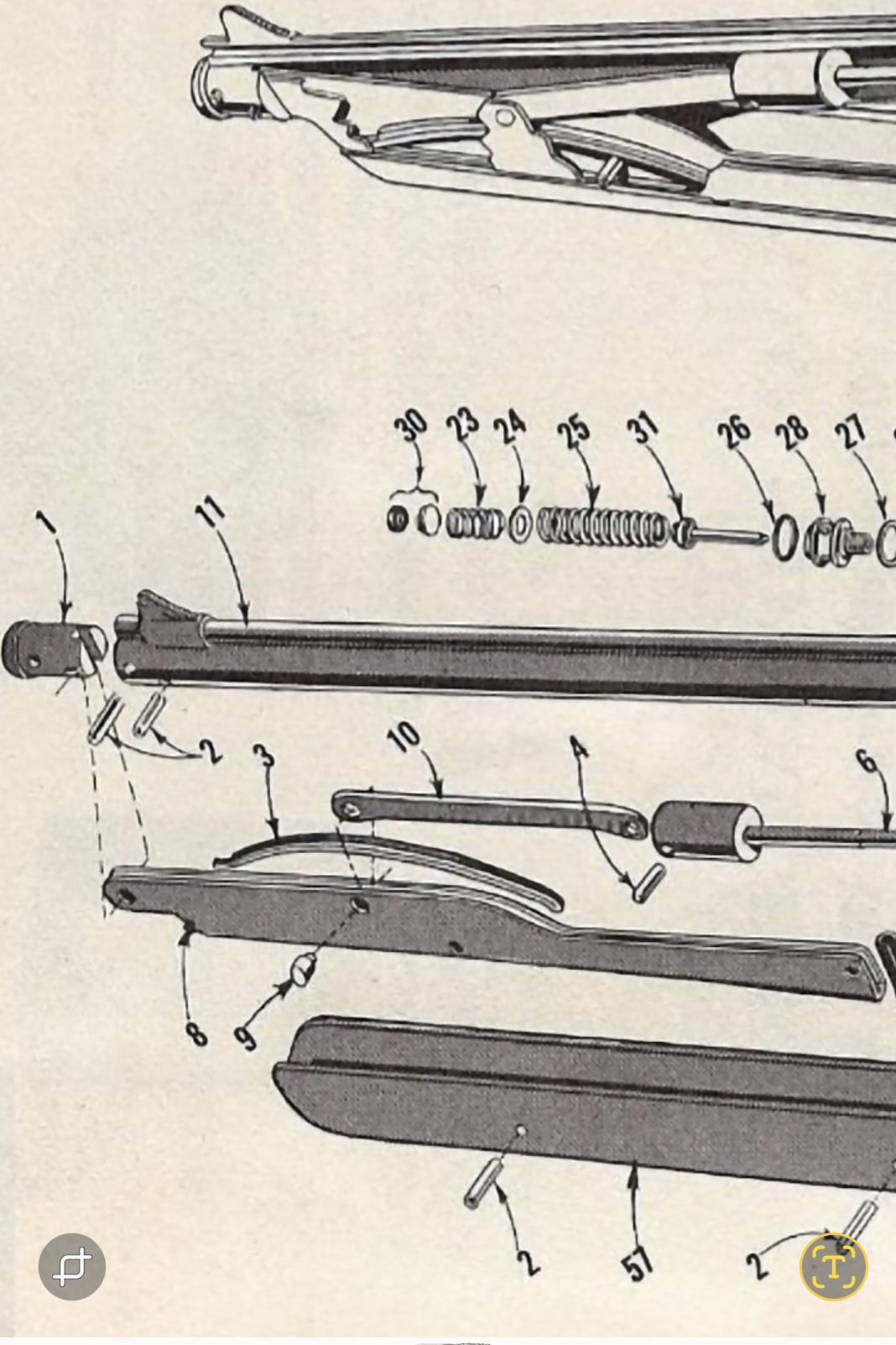

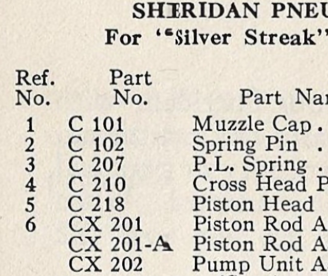

There is a leaf spring in the lever assembly to push it up when closed - yours may be broken or out of position?
Don R.

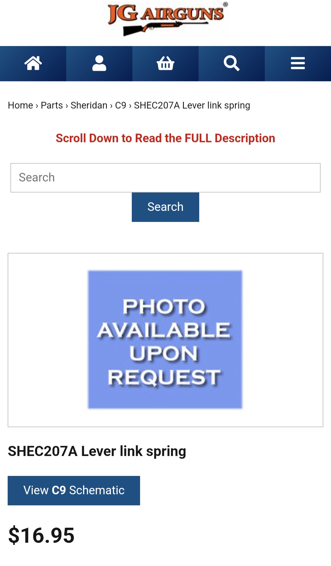

Check JG Airguns.Yes I got it that way. It's definitely not there.
Thanks for the diagram and the part #s. Now I just have to find one.

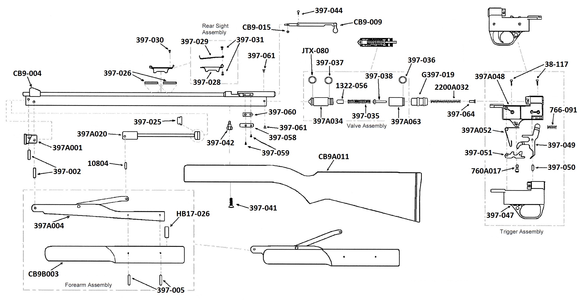

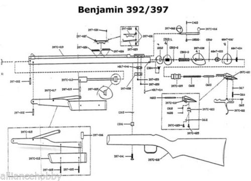

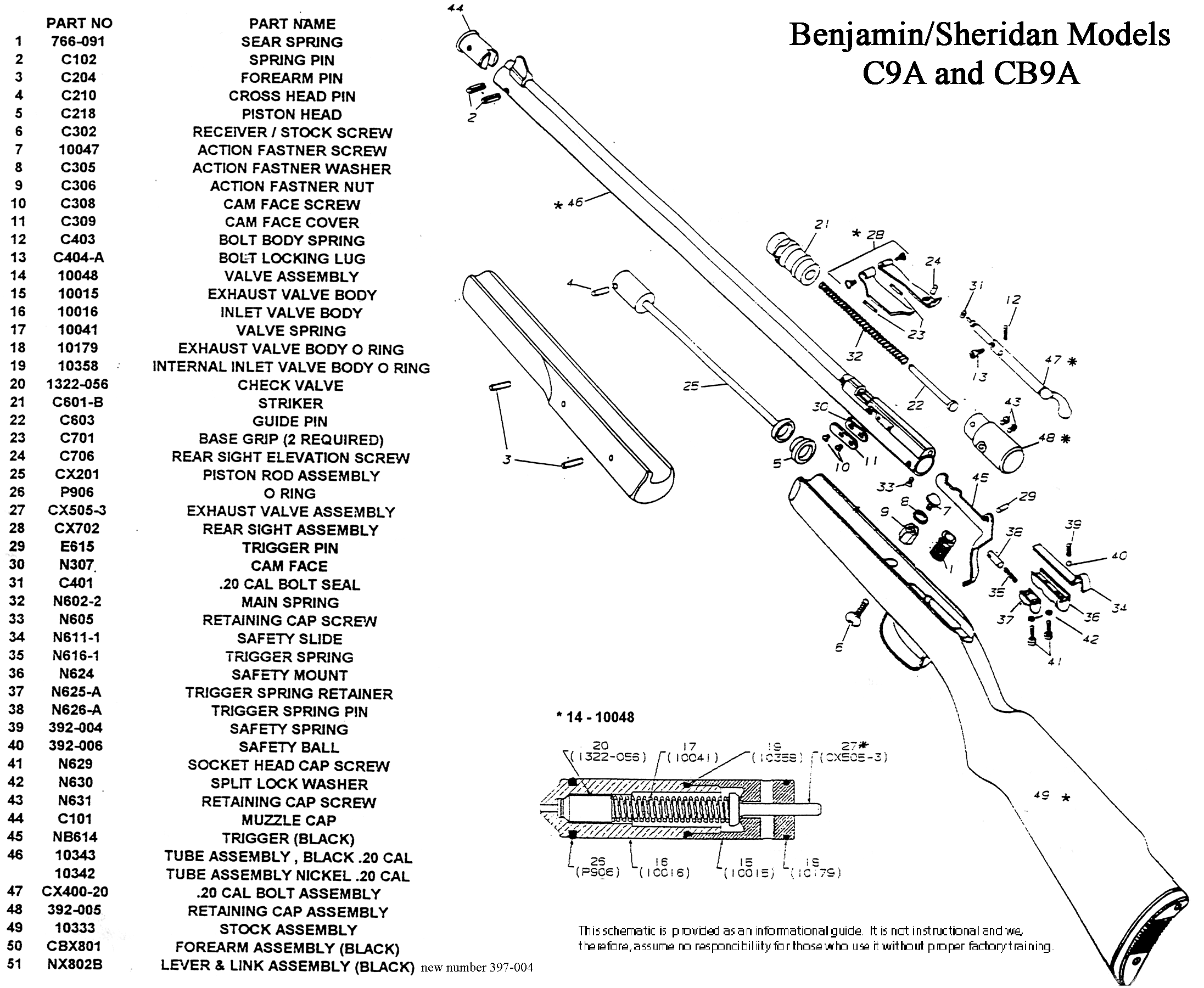

It's not the same, and the spring in the C9 is not an available part.Yes I saw that. I need the spring for the C model. I'm looking for a pic better pic of the C9 to see if its the same.
Heres the C9 schematic notice the lever assembly is sold as one part unlike the older C Model.Yes I saw that. I need the spring for the C model. I'm looking for a pic better pic of the C9 to see if its the same.
