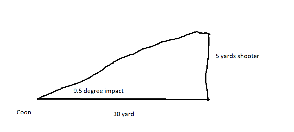

If you hit the middle of the top of the head and the coon wasn't looking down the impact angle was only 9.5 degrees. So the pellets just ricocheted off the skull. Ideally the angle should be 90 degree. The angle should be at least 45 if you have enough FPE. Better to bait them so you can take your time with a slow moving target and have ample chances to get a good shot angle. Study their head movements while they are eating to get a sense of the movement pattern. Even then about 5 to 10% of the time you might miss the brain, because as you are squeezing the trigger the coon unpredictably moves it's head.

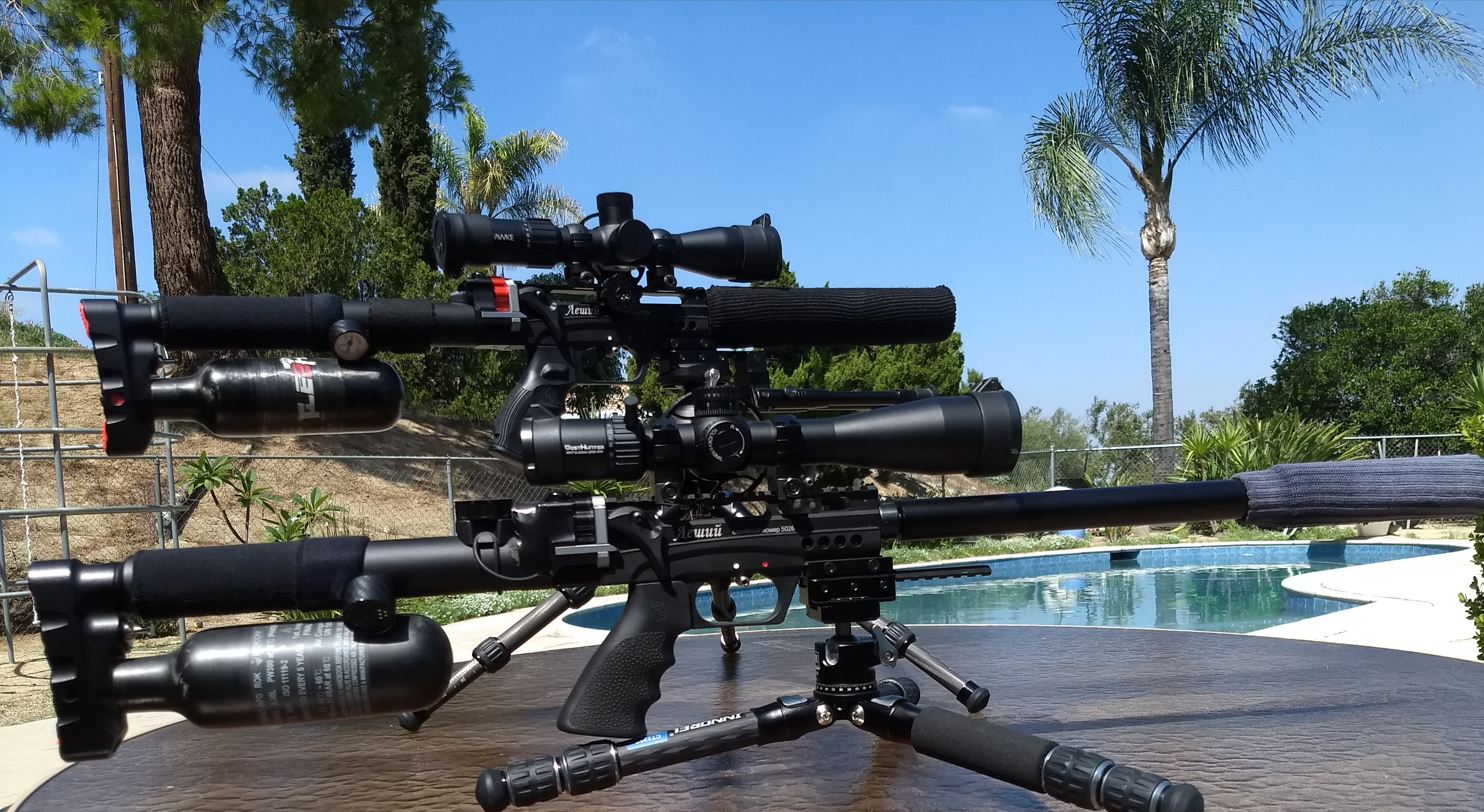

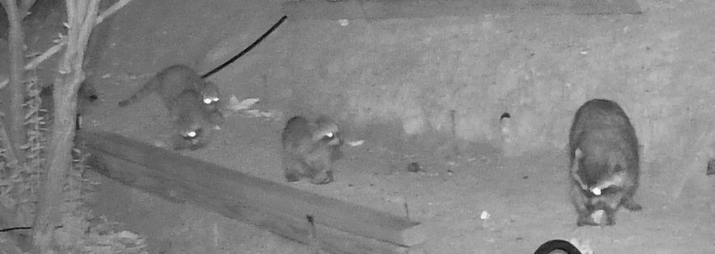

Having endured many nightly attacks from somewhat cute but very destructive communities on our small avocado grove.
Duty station second floor balconies with tripod mounted Leshiy 2 shooting Benjamin .25 domed 27.9 gr. pellets.
Range twenty five yards to a high placed green lighted and baited area aka the Dance Floor.
There are four different sounding inbound - out bound motion detectors (compass points).
As no one can ever know how many visitors may show up for dinner, it's best to be prepared for those 2 am visits. 👀
