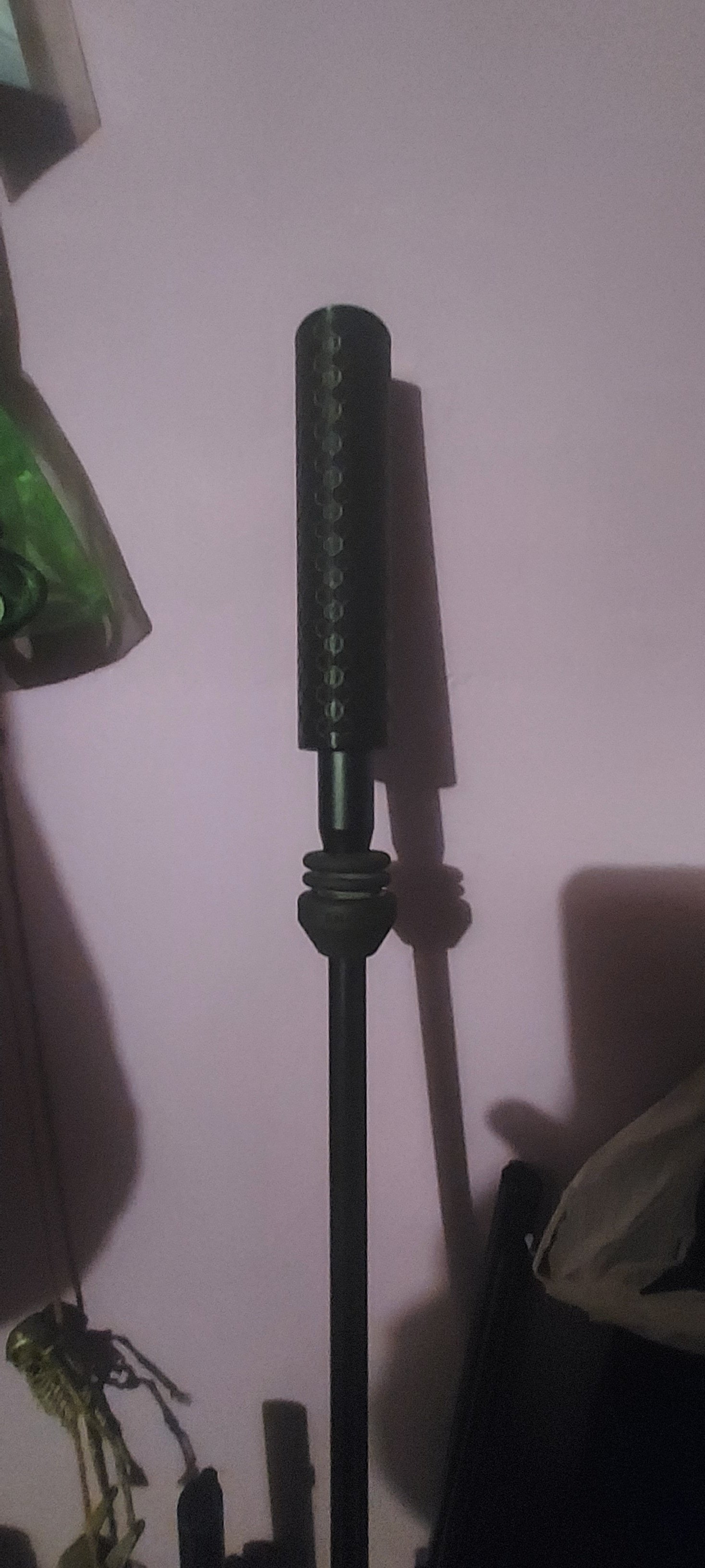

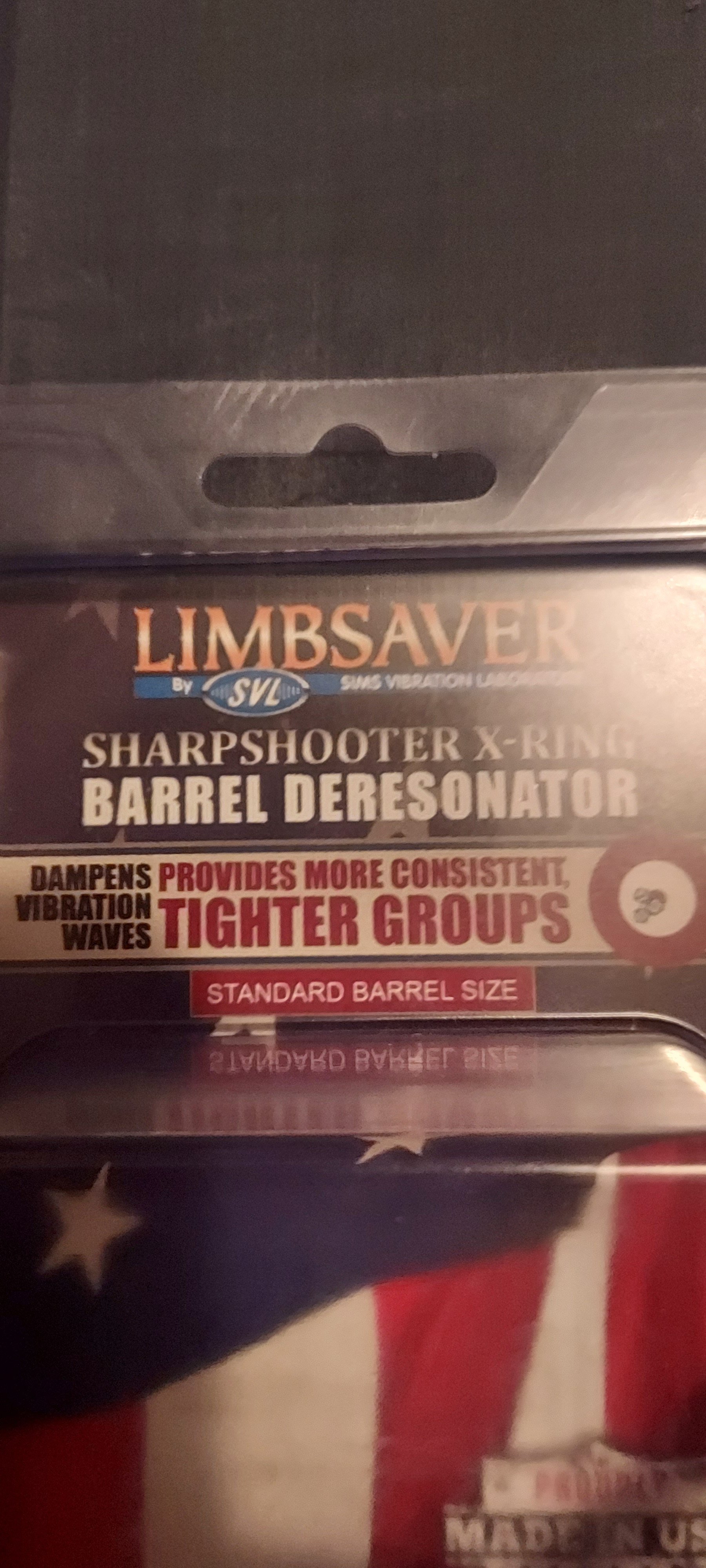

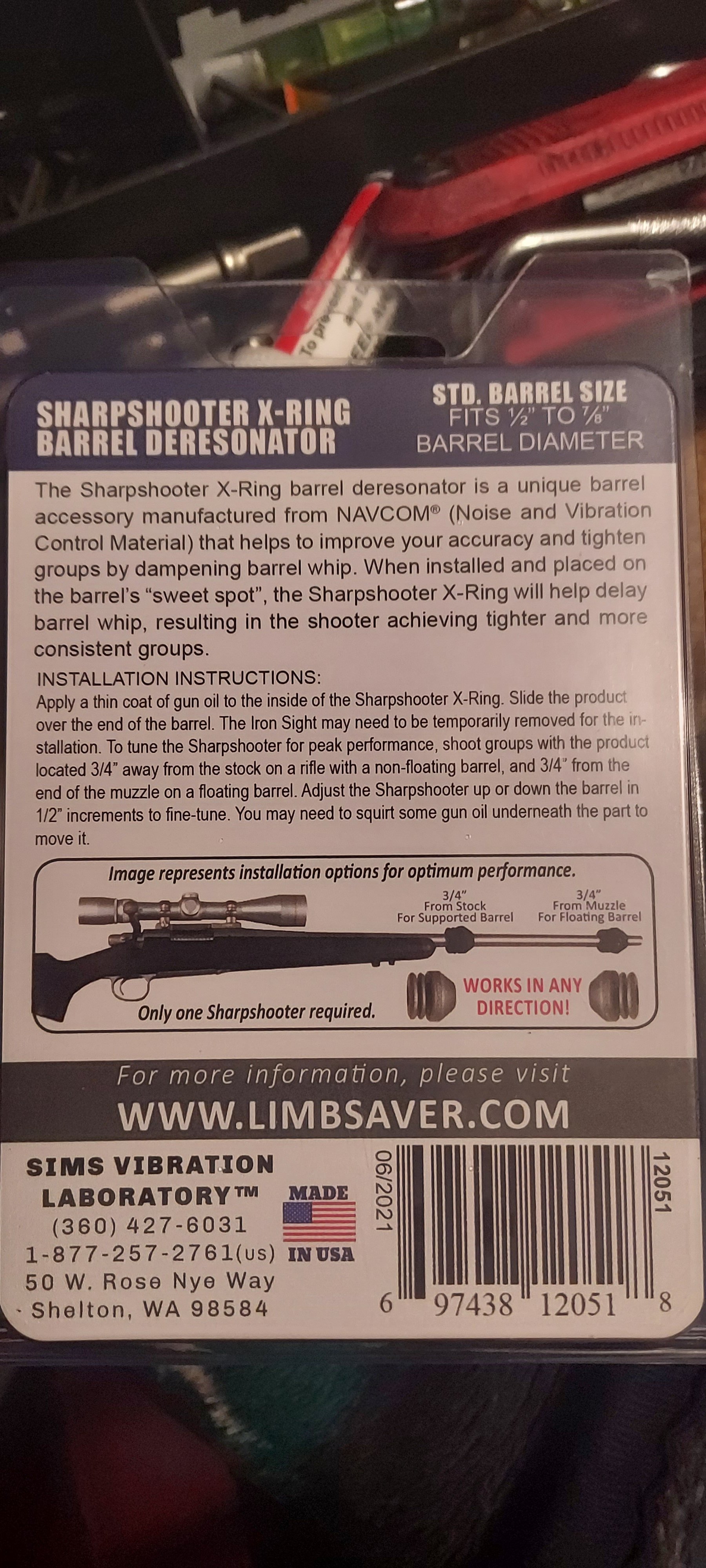

I use this🤷‍♂️
Helped my grouping*it's a wildly bucking break barrel(Winchester 1100SS)* enough to help me get 10.5gr Benjamin HPs to hit at 100 yards🤷‍♂️

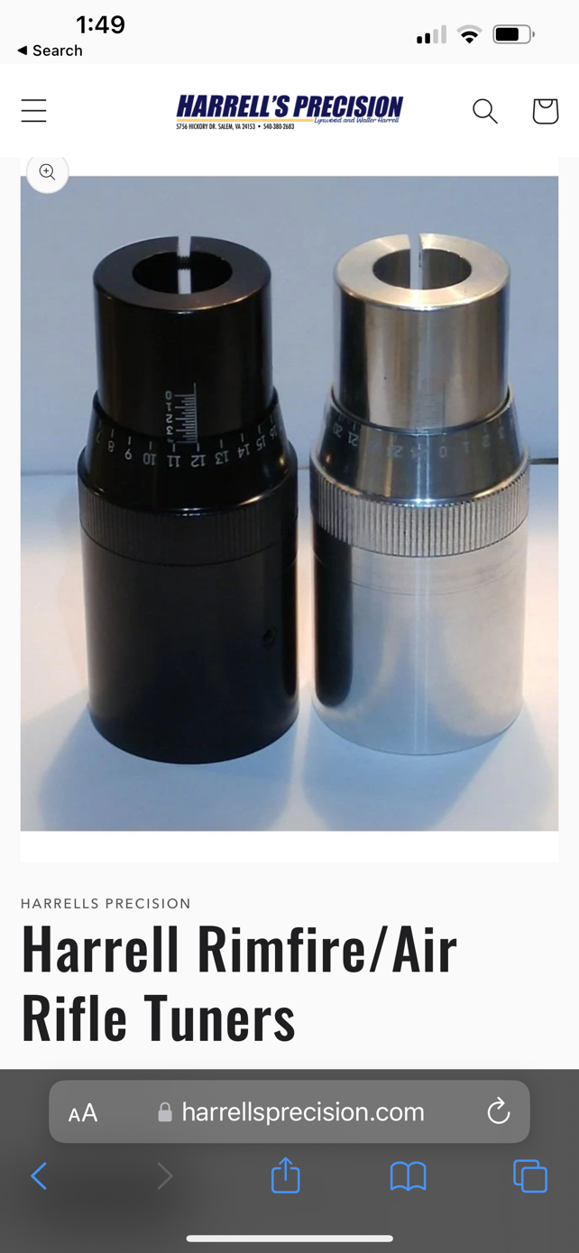

I was into rimfire benchrest shooting for years and almost everyone that shoots rimfire benchrest has a Harrels tuner on their gun. The barrel tuner has been around for many years, it's not something new as some in the air gun world thinks. The ones being sold for air rifles came from the design of the Harrels tuner, which has been around for years. I have several of them in my shop and have tried them on my air rifles, in my opinion, an air rifle does not generate enough barrel harmonics for the tuner to be really effective. They do work very well on a rimfire rifle, at a rimfire benchrest match it would be odd to see a rifle without one.
