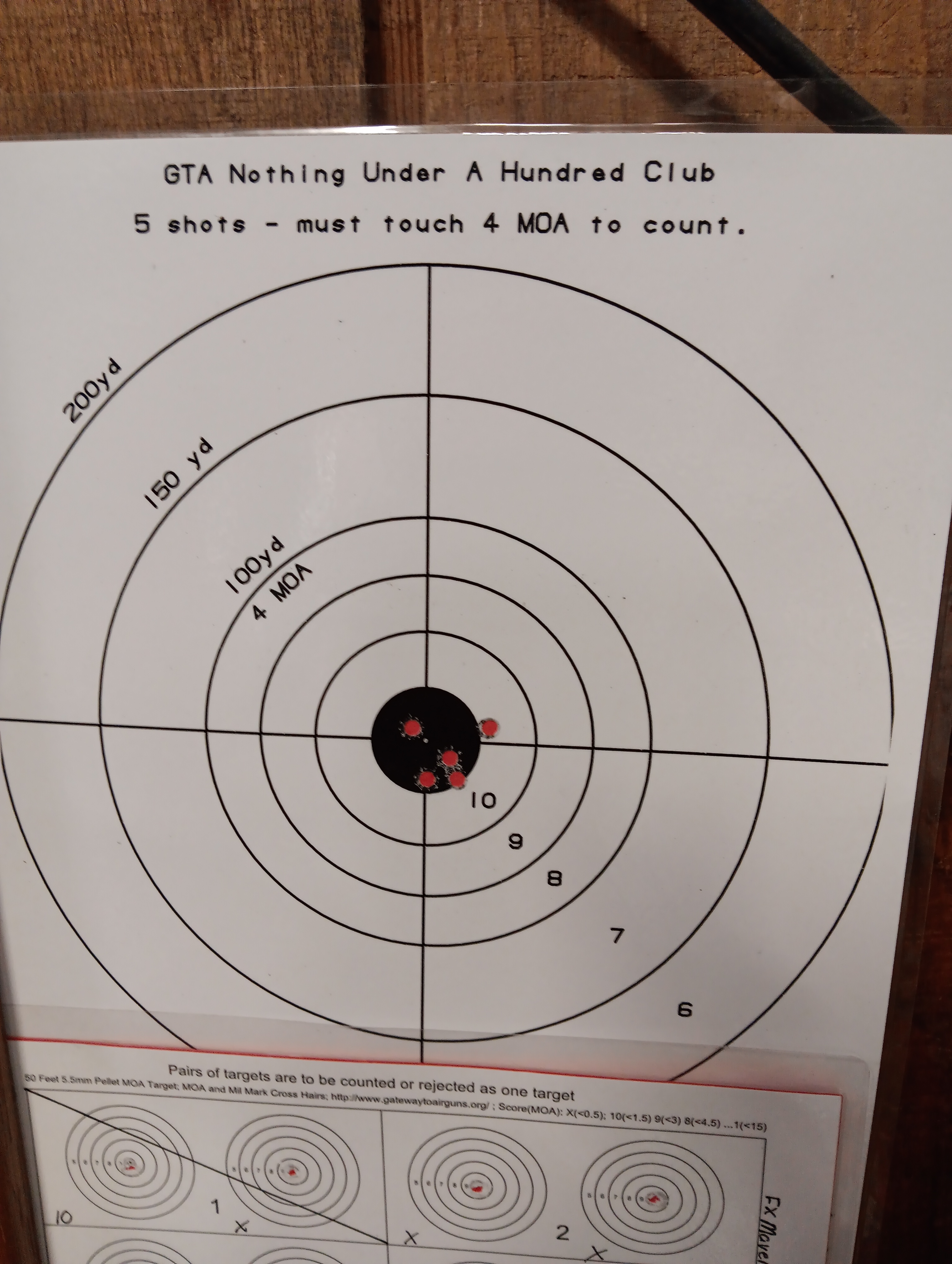

Not so sure about MOA, I'm using MOC (minute of cork) and MOS (Minute of squirrel). At 100 yards, this one is my Maverick .22 Compact, 100 yard, RMR/FX 21gr Hybrid. I actually knocked it down once, missed, then this hit. The RMR/FX Hybrids work best in my Mav .22 and Mav. .25 600mm, they also work well in my .25 JSAG Raptor, have spent the normal fortune on other slugs including Javelins, Zans, and a bunch of others, there isn't enough air on this rock to test them all, or time for that matter. The biggest key is air, just enough to get it out of the barrel at the perfect speed and not one molecule more.
Reactions: Maizen

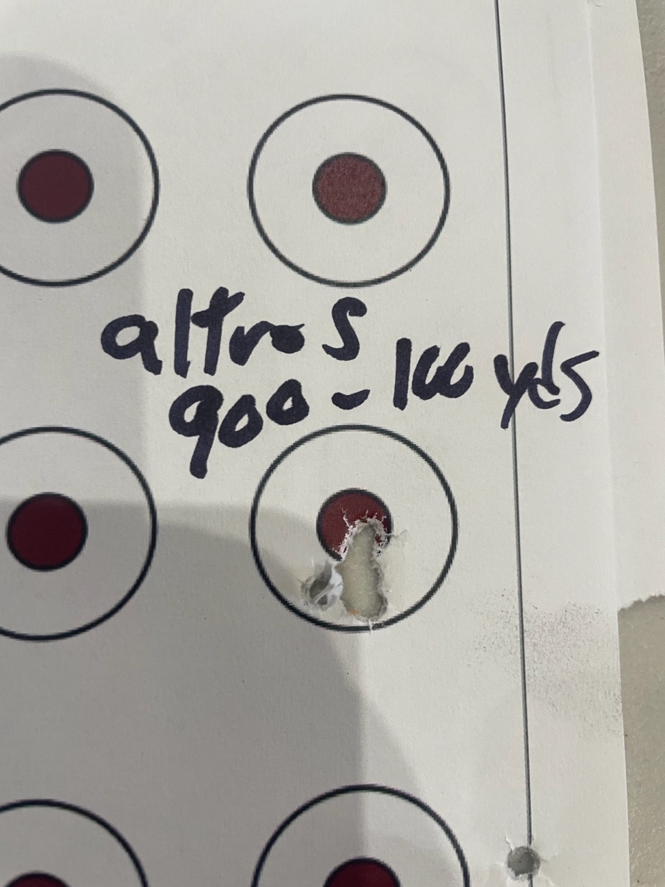

In a word, Altaros. Shoot them from Superior Heavy or Slug. 880 to 900 fps.
You’re welcome. 😉
I have a good friend and one of the best shooters I know. Decided a short while ago to try .25 Altaros ATP Smooth. His shooting buddies convinced him to try 990, then other lower speeds above 950 fps. He emailed me and I stressed fast is not good with these. He lowered to 920 and said it got much better then he went down to my suggested 900 fps and shot the below 5 shot group at 100 yards with .25 Superior Slug 1:16 twist. Hard to beat that!
You’re welcome. 😉

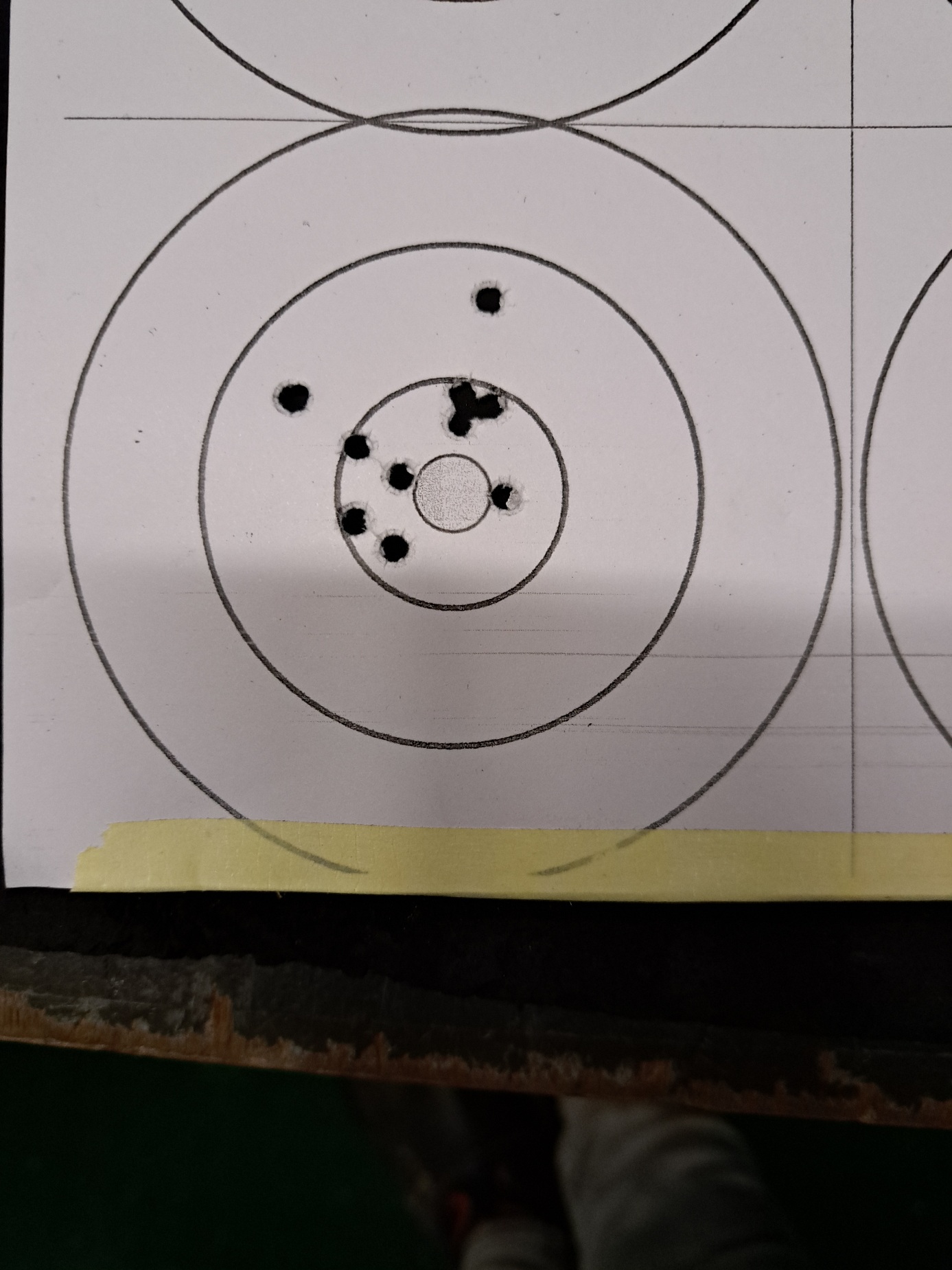

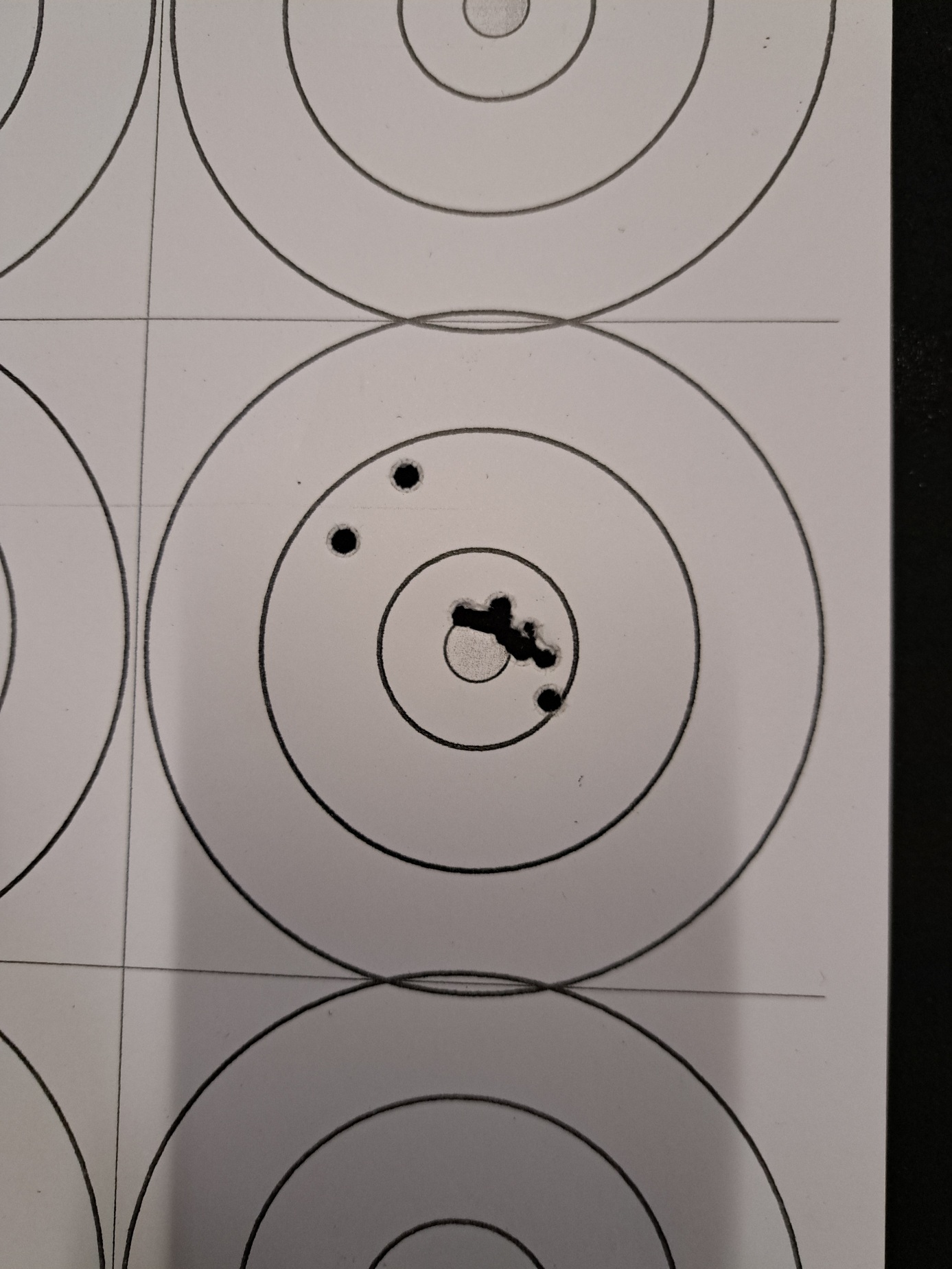

FX Dreamline classic .22 with special modified stock. The standard synthetic stock is to flexibele.
It's the newer version with the AMP2 regulator and larger plenum.
Added an extra power plenum, 600MM barrel with Superior Liner. No silencer.
HuMa regulator and Slug probe.
2 barrelbands, lighter trigger spring.
Regulator pressure 118Bar, speed 278M/s
H&N 23 grain .218
The best thing to do is to get rid of the magazine and buy a Carm single Shot Loader
10 schot groups Not always that good , buth sub MOA regulary
