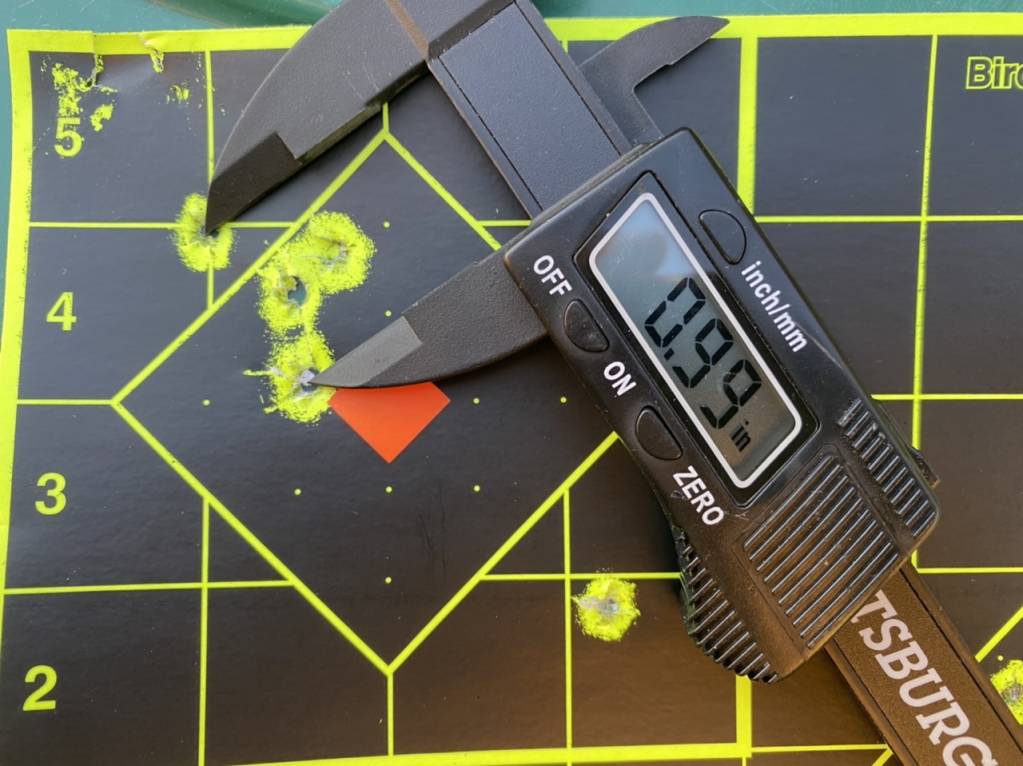

I have a good friend and one of the best shooters I know. Decided a short while ago to try .25 Altaros ATP Smooth. His shooting buddies convinced him to try 990, then other lower speeds above 950 fps. He emailed me and I stressed fast is not good with these. He lowered to 920 and said it got much better then he went down to my suggested 900 fps and shot the below 5 shot group at 100 yards with .25 Superior Slug 1:16 twist. Hard to beat that!
This is the accuracy that I'm looking for, Altaros slugs are one of the brands that I haven't tried.

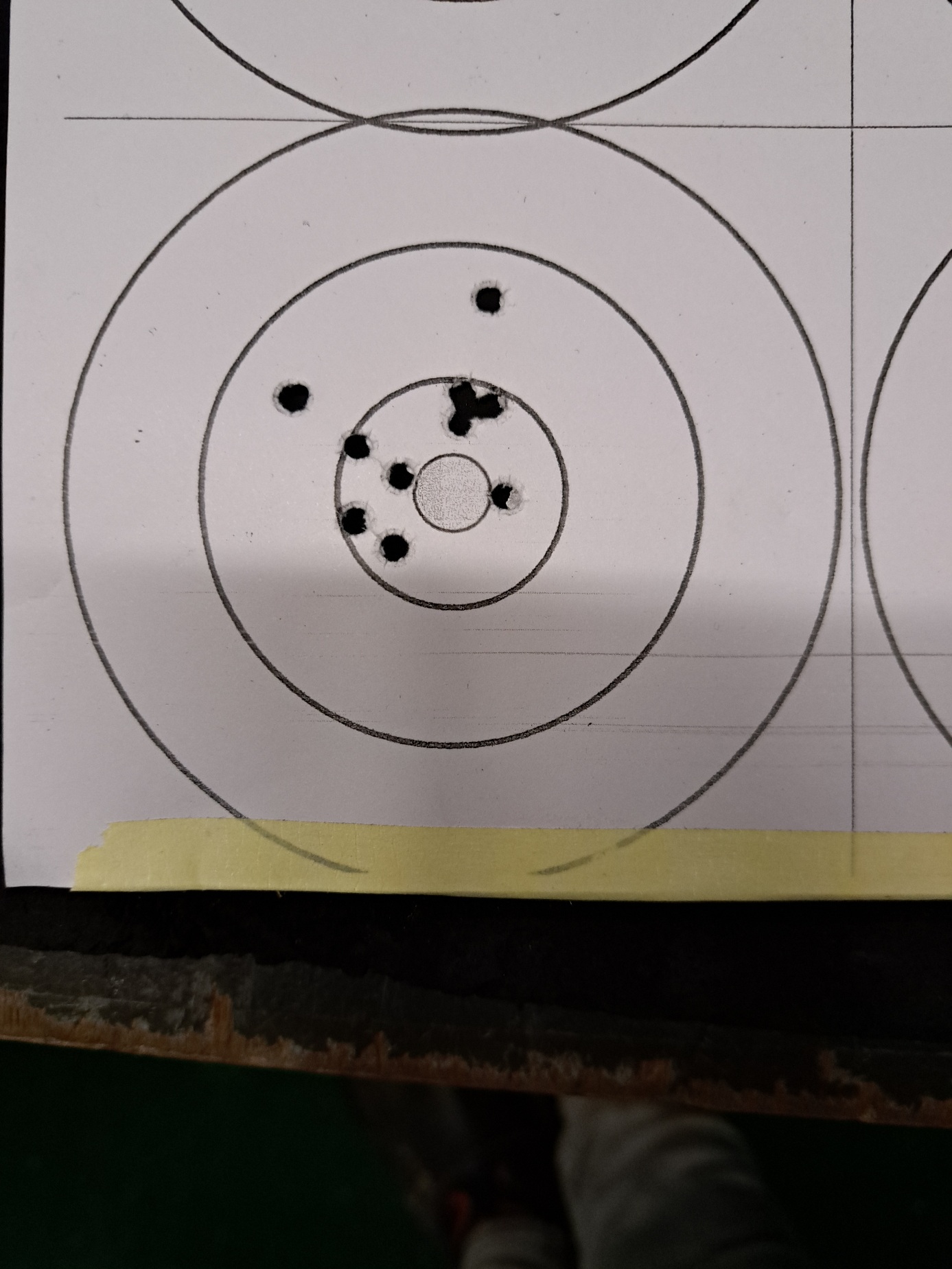

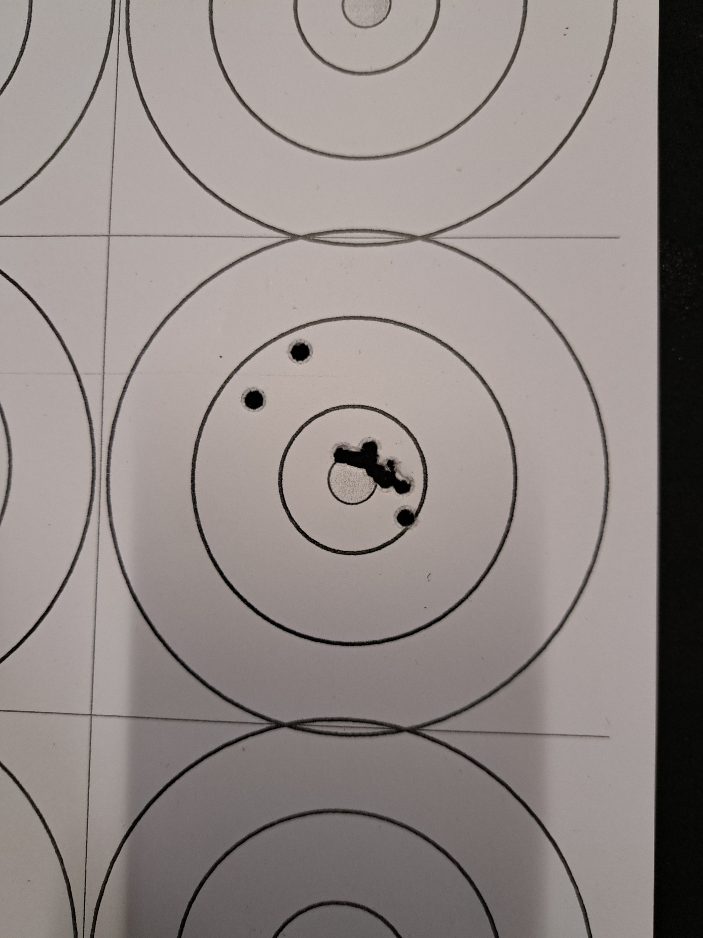

FX Dreamline classic .22 with special modified stock. The standard synthetic stock is to flexibele.
It's the newer version with the AMP2 regulator and larger plenum.
Added an extra power plenum, 600MM barrel with Superior Liner. No silencer.
HuMa regulator and Slug probe.
2 barrelbands, lighter trigger spring.
Regulator pressure 118Bar, speed 278M/s
H&N 23 grain .218
The best thing to do is to get rid of the magazine and buy a Carm single Shot LoaderView attachment 441263View attachment 441262
10 schot groups Not always that good , buth sub MOA regulary

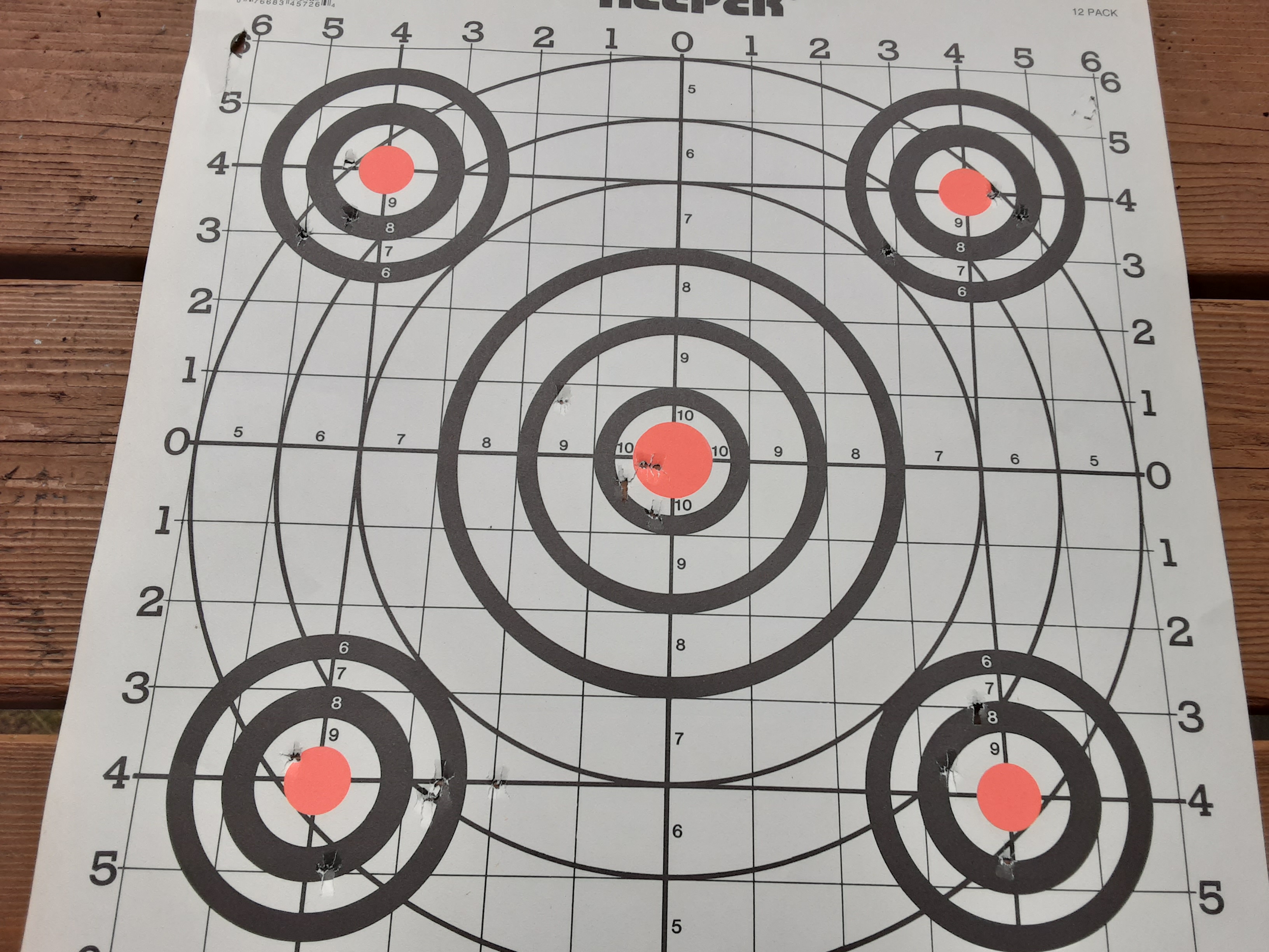

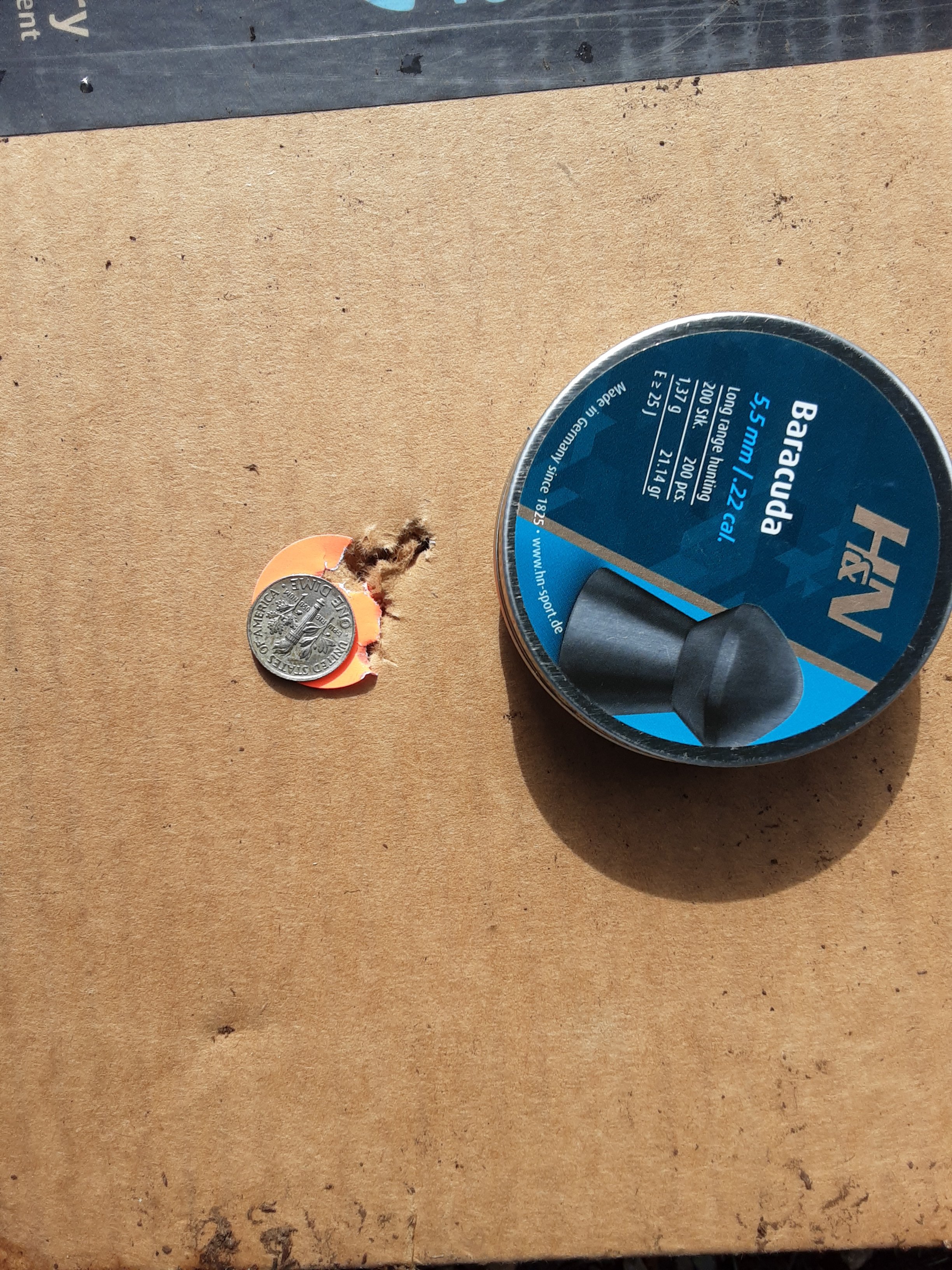

This is a 50 yard target with the Mav. with Baracudas
This is 100y with the same pellets. The center group was shot before the wind picked up . The outer groups were shot faster and the wind was gusting . On a good day I'm sure I could some sub moa groups. My first attempt at 100 yards. 1" squares.
Fx hybrid slugs at 50y . I haven't tried them at 100y yet but it has some potential for a sub moa group. I would like to try the Altaros slugs.
